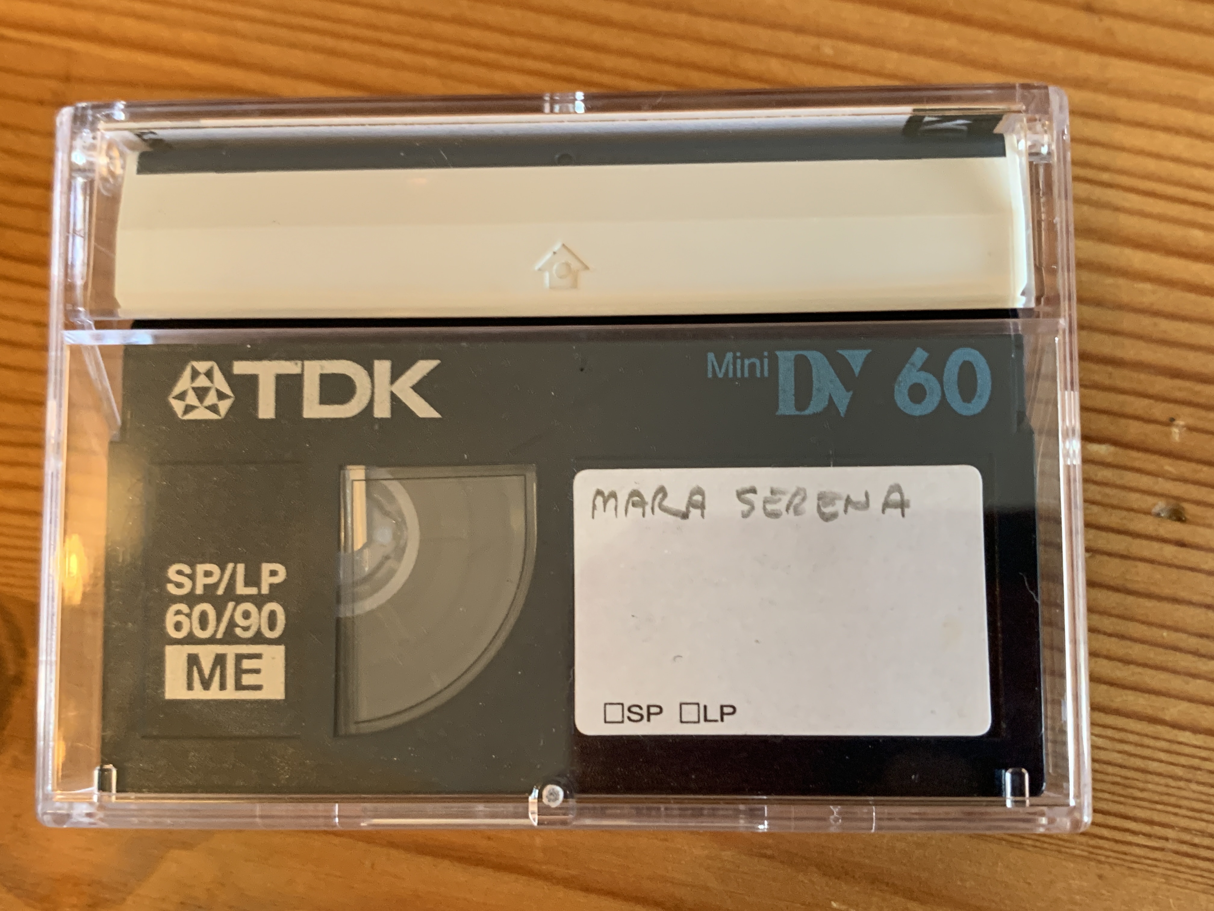

Looks like these are Mini DV cassettes.
[Attachment 75139 - Click to enlarge]

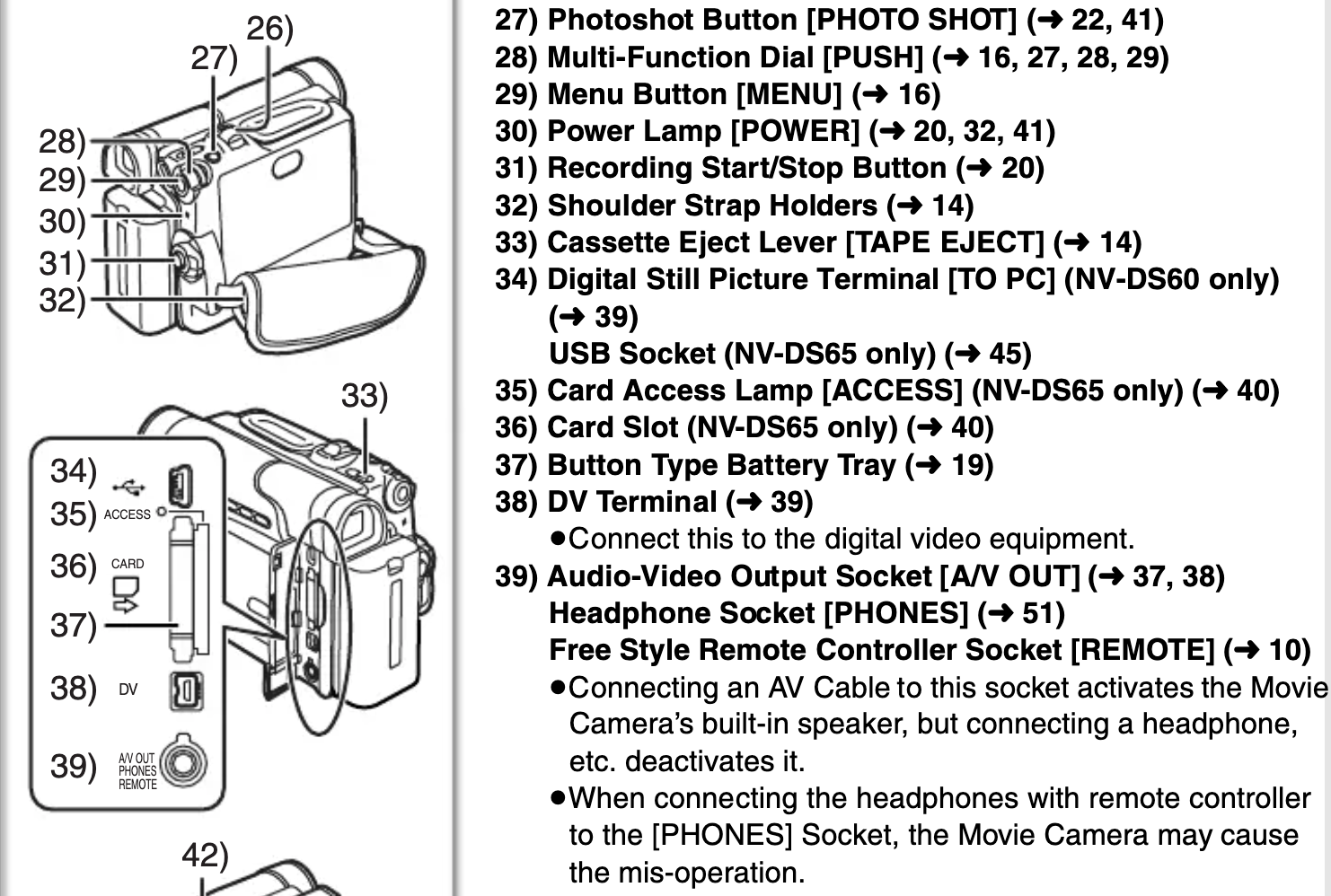

The Camcorder is I believe a Panasonic NV-DS65 like this one.Last edited by JonnyAlpha; 29th Nov 2023 at 12:01.
See above these are Mini DV tapes so what are my options? Will the I-O GV2 or the Hauppage Live2? Or should I try and resurrect my old Windows PC which has a Hauppage WinTV HVR card in it I think?

Looking at the Panasonic Manual it is supposed to have a DV port on the side:
[Attachment 75140 - Click to enlarge]

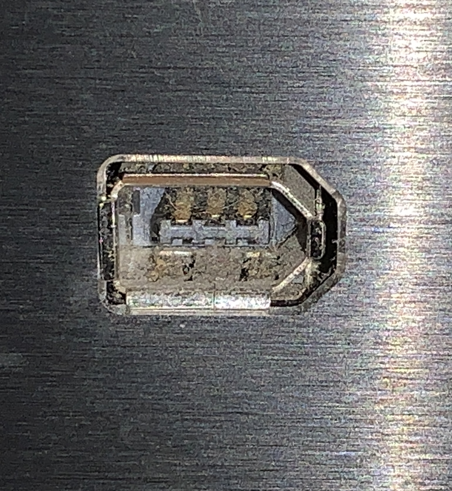

I have a PC that I was using as a HTPC under my TV, Windows 7 stopped booting on it a while ago and I've never managed to fix it.
Just spotted a Firewire connector on the front panel, prettu sure there is also a spare PCI-e slot buried under there somewhere.
[Attachment 75141 - Click to enlarge]
I may re-install Windows 7 on it and see how I get on.
