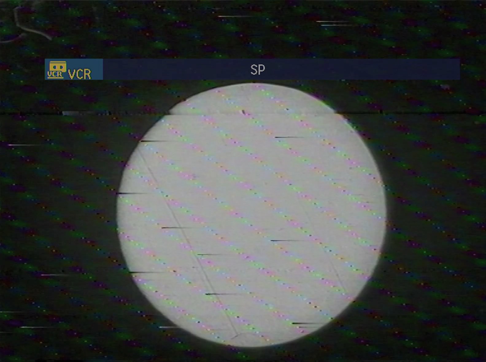

    My device is a Samsung DVD-VR355. It's not great I'll admit:
    [Attachment 57540 - Click to enlarge]
    [Attachment 57541 - Click to enlarge]
    Those diagonal lines of 'pixel defects' and color-blobs are moving. And yes - I did clean anything I could reach within the device (with rubbing alcohol).
