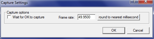

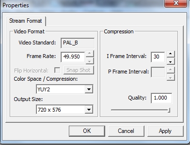

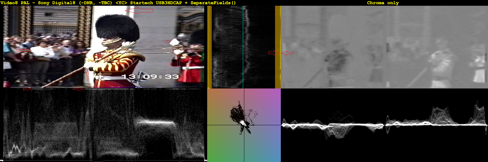

    I just received my new startech usb3hdcap.
    As member AVMiii, my first purpose for acquiring this card was for capturing analog PAL video footage ( Video8 /VHS ) with as good quality as possible, for archiving master copies. I intended after to further post process to get enhanced/restored versions to use on a PC environment and eventually to encode/author DVD copies ( I want to use lossless capture to reduce losses due to the further re-encoding ). Also, I as been attracted by what seemed to me like an almost general video capture device due to its broad input spectrum , portability/connectivity ( external device/USB3 ) and good HDMI capture quality.
    I wanted to try this device as the capture card offer for the present PC generation with windows 8/8.1 with PCIe, allowing losseless capture of analog sources (composite , svideo ) namely with applications like VirtualDub is almost absent. In this context we are faced with the resurrection of a XP PC with a used ATI or similar card or some sort of A/D USB or firewire converter that only allows lossy captures and sometimes obliges using a proprietary application in general with limited options.
    Only to do a inicial test i tried it on a normal laptop (i5 3210m 2,5Mhz, 6Mb Ram, SSHD( 8GB SSD+ 1TB Sata HD), Nvidia GF 630M 1GB ), and installed the micomsoft x capture-1 driver ( 1.1.0.140,1 , not the last one) as stated by member The Thrillness . The installation carried out flawless.
    My actual workflow for Video8 capture is:
    Digital8 Cam(tbc on )- svideo – USB3HDcap – laptop (usb3) – VirtualDub –lossless codec( HuffYUV /Lagarith)
    I have previously captured in Dv lossy format through firewire and this workflow as given to me the best results it´s why I have used a similar one
    Digital8 Cam (tbc on ) – firewire – PC – WinDv -dv sd file
    (I tried also an alternative workflow Digital8 Cam(tbc on /dnr off )- svideo – external TBC AVT8710 –ADVC-55 -firewire - PC – WinDv -dv sd file ) but didn’t see evidence of better results)
    With VirtualDub I tried first with the HuffYUV codec ( 32 bits no MT) 720x576 YUV2 4.2.2 and had no special problems , no drop or inserted frames, no jitter, no synch. video/audio problems. The Cpu load was between 25-35% . If preview is not used cpu load is marginal 6-12%
    I tried next the lagarith codec and again no problems , however the CPU load as been between 40-50%.
    The captured results seemed quite ok however even if they appear to have additional quality I would have expected a higher quality difference related to the previously captured DV lossy ones
    I also tried Xvid and H264 codecs but with these the Cpu load exceeded 100% and I got droped , inserted frames clear the machine as not enough power for using these codecs.
    However the usb3hdcap companion app “StreamCatcher” can capture H264 with low cpu load (about 30%) but the quality level is limited VBR or CBR ( about 8 Mbps bit rate as maximum). I have not tried the companion app for miconsoft driver I think called “VideoKeeper” I don’t know if it will work and could give better options than streamcatcher. Anyway these apps only have interest if using a under-powered machine and if quality is not the goal.
    I tried also HDMI captures through virtualdub and I have been very impressed with the results and quality I tried only with 720p and 1080i with no problems . To select the input to use I have tried 2 solutions, the capture filter in virtual dub or previous selecting the input through the companion app that can be closed after that.
    As I said I want to get a ,as good as possible master copy , however even if I have a minimum IT/ video known how, I´m still on my way through the video expertise learning curve and it will take some time to get there..
    In this context there are too many variables and options and I have some doubts about some of them.
    A mediainfo related to the captured files shows some figures that seems strange to me
    Display aspect ratio 5:4 and not 4:3
    Scan progressive with HuffYUY and not interlaced, however the footage as the typical aspect of interlaced , I think I have probably mixed up some options but can´t figure out which ones
    Can a more experienced user advice me if for this workflow , the selected virtualdub options are the correct ones to get the best results ?
    Also anyone knows the advantages of the new miconsoft driver update ?

    Hi FLP437. Thanks for the info. Hope my reply isn't too late.
    I would very much like to see some short samples if you'd be so kind. Particularly with TBC off, to see how it handles bad input. You can attach AVIs up to 500MB.
    Score one for the "DV's inferiority is exaggerated" crowd?
    Hmm. XviD is single-threaded but it should still work okay with SD resolutions, using a CPU from the past several years. x264vfw should also work well, with appropriate settings tweaked to your own setup.
    It isn't flagged, so a pixel aspect ratio of 1:1 is assumed. 720/576 = 5/4.
    You have Huffyuv's field threshold set to 576, which is a very poor choice. It means that only videos with 577+ lines will be encoded in interlaced mode. Since it's lossless, the video output you get is still the same, but the compression efficiency is perhaps worse. Set it to 288 instead. (And then use a different codec when you capture 720p...)
    It's entirely possible that MediaInfo will still say "progressive" regardless. It doesn't matter. It has no way of knowing the actual content type; it can only tell you flags.
    The Capture Pin looks weird; 50.000 frame rate instead of 25.000 and I'm surprised that the "I Frame Interval" under "Compression" isn't greyed out. Similarly, the Capture Filter says 288p @ 50, but if you're getting 25 fps interlaced files without compression artifacts I guess that's all fine.
    Just curious: what does the "VBI Lines" option of the Capture Filter do?
    You should figure out what the neutral setting of the Proc Amp's Sharpness Control is. I suspect it's 0, since the "32" default there is at the 1/8th position. There are devices that soften video when sharpness is set too low, but they typically position neutral at halfway. If you don't feel like feeding test patterns in to test, use the camera's on-screen menu text. The video is (over-)sharpened when haloes are visible.
    P.S. Why would you choose not to use the multi-threaded version of Huffyuv?!

    I will be grateful if you can give me your opinion about the sample capture and eventual problems related
    Thanks for uploading it. The level of line jitter looks low, so that's good.
    The #1 thing I see is blown-out brights. In every frame, objects are hitting the hard limit of Y=255 and clipping hard. Ideally you want them to just touch 235. The black level looks okay, so try lowering the Contrast control of the Proc Amp. (Don't worry about the visualizations in the image if you don't know what they are; the point is it's hitting the top of the scale.)
Name:	FLP437 - Sample1.png
    I could be wrong, but it looks like the chroma has been noise-filtered even with the camcorder's DNR turned "off". If so, I assume the camcorder is doing this and not the capture card. I don't consider this a defect, at any rate.

    1 -capture pin, with the last driver the frame rate appeared to be weird as it shows 50 ( could it be fields and not frames ) and now it shows 49,95 what is even more weird
    2- capture filter there are 2 new options, the vertical mirror and horizontal mirror.
    However this seems to have no visible impact on the output frame rate that continues at 25. Even on a standard sub-powered i5 laptop where I have tested it there were no drop frames or inserted frames and almost no jitter.
    I tried also the companion app for x capture-1 Video keeper to see if it works, but I had run into some problems .Ffirst the install language was English but the application itself was in Japanese ( eventually the idiom could be changed but it was difficult to select options in Japanese). Nevertheless I got the impression that this wasn’t going to work with the startech as it wasn’t able to detect the presence of the x capture-1, however it was not important it was a curiosity.
    I got a review from a Japanese site related to the X capture-1, I translated it with google translate and put it in attachment as they share a common hardware base, however the startech device as not the pass-through feature. Based on this review I’ve identified the analog video decoding chip and found a datasheet that I am putting also in attachment .
    Related the last post and blown-out bright the suggestion of trying the other options in color range doesn´t seem to work as it doesn't fix the option , but changing contrast level in the post process should work.
    By default the devices tries to capture at 50 frames as seen in capture settings ,it´s necessary to select 25 ( PAL ) and sometimes it returns to 50 ( or 49,95 now with the new driver ). But this happened already with the previous driver.
    Also by default in the capture filter auto resolution scaling & RGB24/32 output is selected

Name:	capture filter.jpg
Name:	capture settings.jpg
