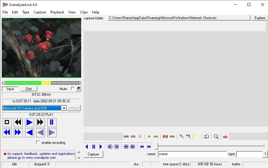

    Nope, It works perfectly in Windows 10 using ScenalyzerLive, I have the 500-USB device and I'm transferring a Digital8 tape via firewire right now to the device then from the device to a Win10 laptop using a regular USB cable, I can even control the camcorder functions from the application, See the screen shot:
