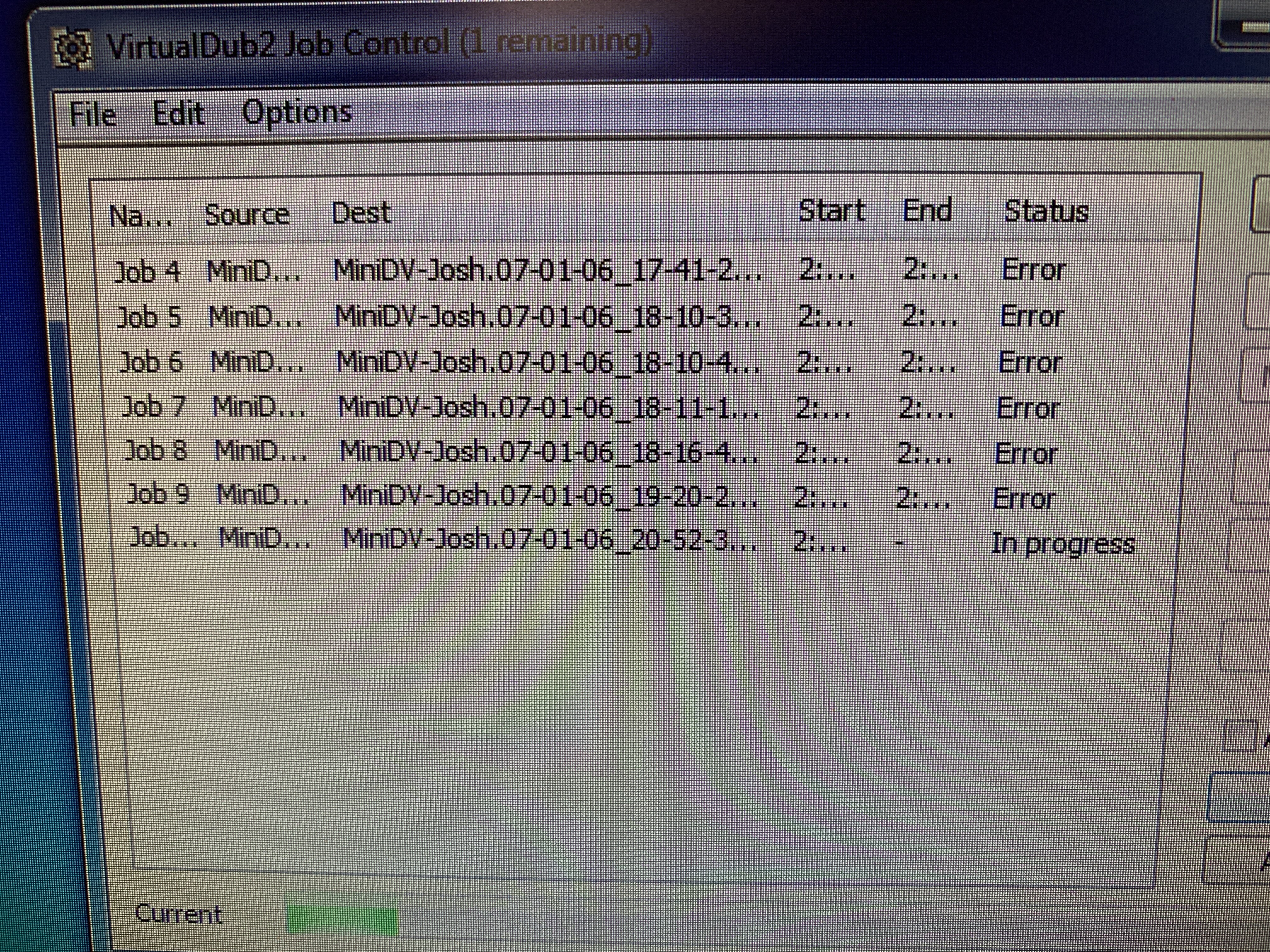

    So feeling brave, I added the filters, (Deinterlace, Denoise, Resize to 768x576), save video options Huffyuv v21.1. Everything else left as standard - Pixel Format RGB24, No Compression. Video set to Full Processing Mode.
    I saved the first 7 as a job que. When I hit Job Control / Start, everything apart from the last one immediately went to status Error. The only one that ran was the last one.
    Any ideas?
    [Attachment 75494 - Click to enlarge]
    UPDATED
    Sorry, before I ran the job, I moved the capture files to a different folder DOH!!

    May 2005
    Australia-PAL Land
    So feeling brave
    That's the spirit!
    Bummer on the errors.
    Hit F8 (Go>Log). I've never read it but there may be something in there.

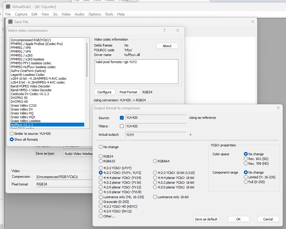

  14. Capturing Memories dellsam34's Avatar
    Jan 2016
    Don't use RGB24, use YUV2 instead.

    So feeling brave
    That's the spirit!
    Alwyn - read the update - I had moved the source files into a different folder - hence the error - all sorted now.

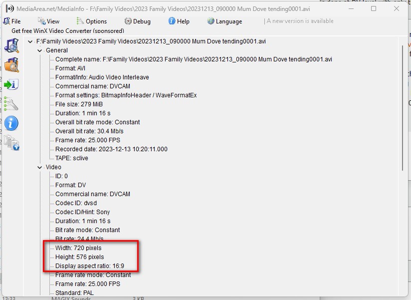

    How can I find out if Iv'e shot 16:9 aspect ratio?
    Sorry I missed this. There are a couple of ways: play it in VLC player and the "wide" 16:9 shape will be obvious. Or you can open the file in Mediainfo View>Tree or Text (a great file info program) and the shot ratio will be shown in the video data:
    [Attachment 75509 - Click to enlarge]

  24. Capturing Memories dellsam34's Avatar
    Jan 2016
    Originally Posted by JonnyAlpha View Post
    Iv'e already done a load using RGB24 - what would the benefits be in doing them again using YUV2?
    Happy to do them all again if needed.
    YUV2 is compatible with most script software, Outputing HuffYUV is just to reduce the overall size of the lossless files, It can also be uploaded directly to youtube without issues.

    Ok thanks, I had a look back in the save video window where RGB24 is set as default, whilst there are lots of other options YUV2 is not one of them?
    Did you mean YUY2?
    [Attachment 75517 - Click to enlarge]
    Did you mean YUY2?
    Ah - didn't spot that
    Would it be ok to re-open all of the clips that I have already clipped and filtered and re-save them without any filters again as YUY2? Then carry on with the remainder filtering and using YUY2 output format?
