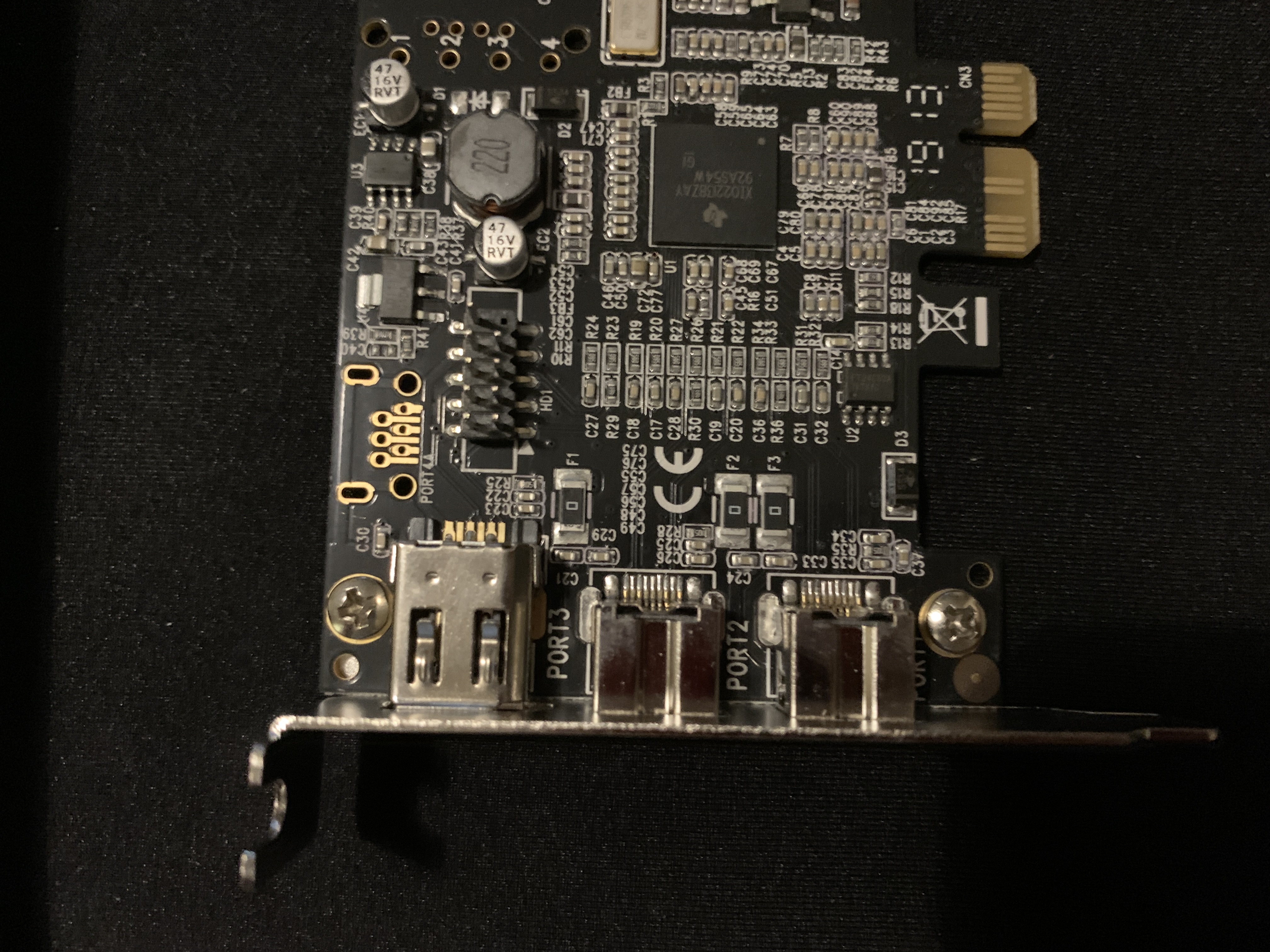

    The onboard chip is a XI02213BZAY.
    On the Texas Instruments Website it lists an XI02213BA which I hope is the same chips and is a x1 PCIe to 1394 Host Controller.

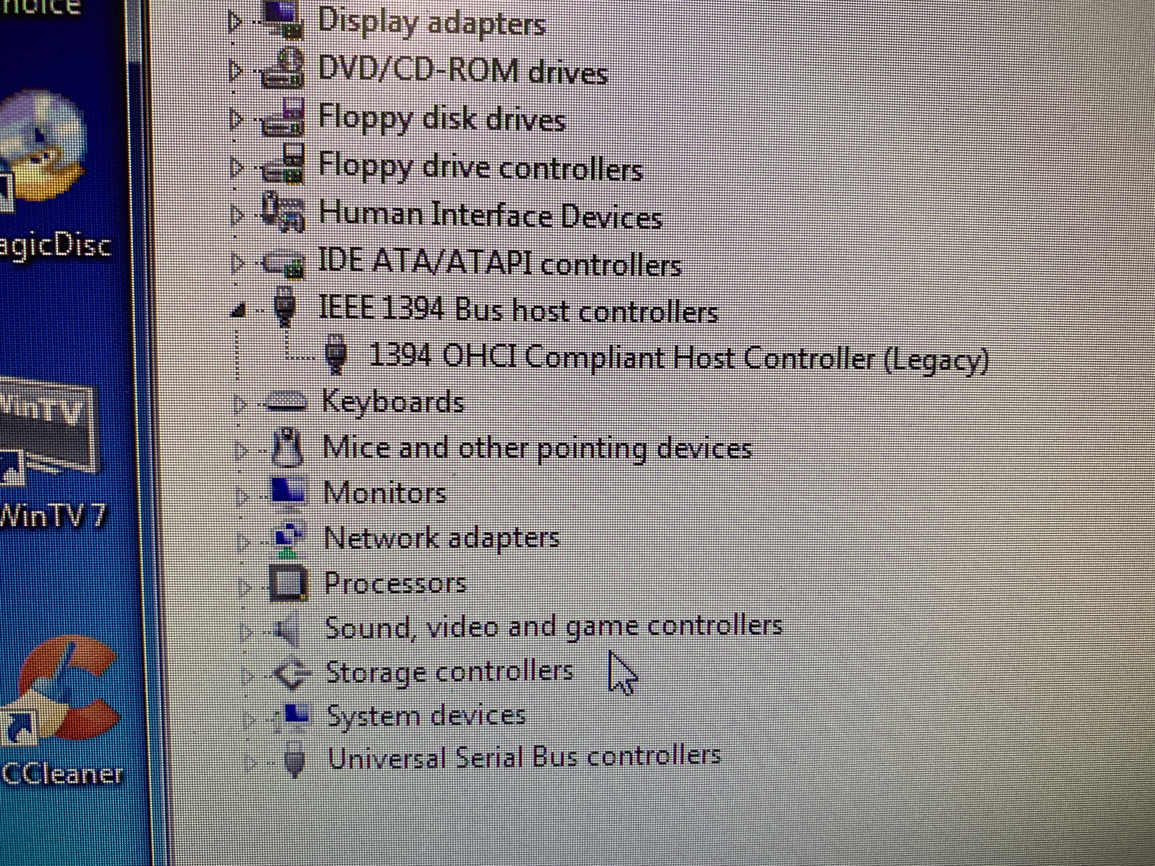

    Anyway I dug out another PC, that used to dual boot Windows 7 and XP on separate HDDs (that bit stopped working last few times I remember using it. Been in my garage not used for a few years.
    Wiped off the dust and fire it up. It booted into XP. I switched the Boot drive and now it boots into Windows 7.
    The Motherboard is an Abit ANM2-HD which has a 1394 connector on the motherboard.
    Before I installed the PCIe card the 1394 Host Controller is visible in Device Manager as a Texas Instruments device, assuming due to the onboard 1394.
    Anyway I put the PCIe Firewire Card and there was no change in Device Manager - should it have also shown the Syba card listed as a separate sub device?

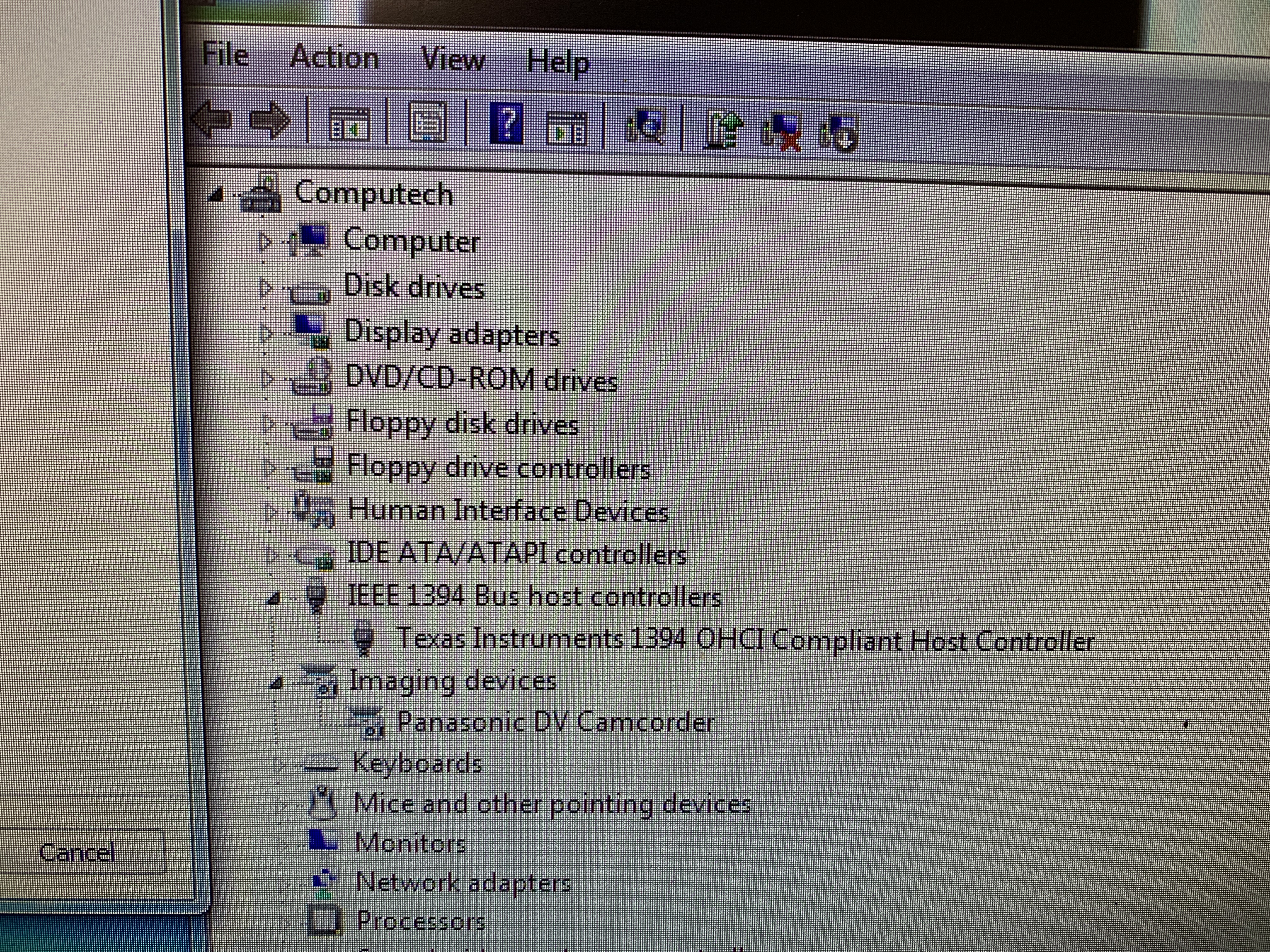

    Following the Studio 1 guide linked in my previous posts above, I changed the driver to Microsofts Legacy Driver.
    Now this is what it shows.
    [Attachment 75299 - Click to enlarge]
    I guess I won't know if the FireWire Card is working until my cable turns up - still waiting!!!
    Good question. Perhaps not. The system already knows it has Firewire in it, on the motherboard. I would remove the Syba card as it is not needed. My old machine had onboard Firewire and it has worked without issue on XP and then Win 7. I don't recall what driver was being used ie Legacy or otherwise, although I note David Knarr suggests using the Legacy driver for Win 7. I'm not sure what he is getting at there; my understanding is that the system driver in Win 7 is the one you want. That may be the "legacy" driver but I wouldn't be installing the MSI file over the top of the system driver unless the system driver didn't work.

    Maybe I missed somat but with all the various PCs that the OP is trying it is quite hard, for me, to establish which one(s) are responding.
    Now here's a potential issue. Any firewire connector beit on on the front or back of a PC is 'wired' to the mainboard. The wire may be soldered but with mine it has a pin connector - and you really do need a manual to determine where it goes for the next comment.
    Now I could well be wrong but let's just assume for one minute that any PC can only have one 1394 host interface. Plugging in a pci-e card expecting that to also work may be dissilusional due to conflict. So, to be sure, any wires from the visible port(s) need to be disconnected first.

    Back to Windows
    So this morning I tried the FireWire Card again. First I disabled the onboard Firewire and confirmed that it had disappeared from Device Manager.
    Then I shutdown and plugged the FireWire Card in and booted up.
    The card was still not seen in Device Manager.
    I tried to install the Legacy Drivers but the .inf file will not install.
    So after this card not working in two older Windows 7 PCs I am nearing the conclusion that it is DOA.
    After re-enabling the onboard FireWire, I downloaded and installed WinDV and plugged the Camera in. As soon as the camera switched on, it was recognised as an imaging device in Device Manager.

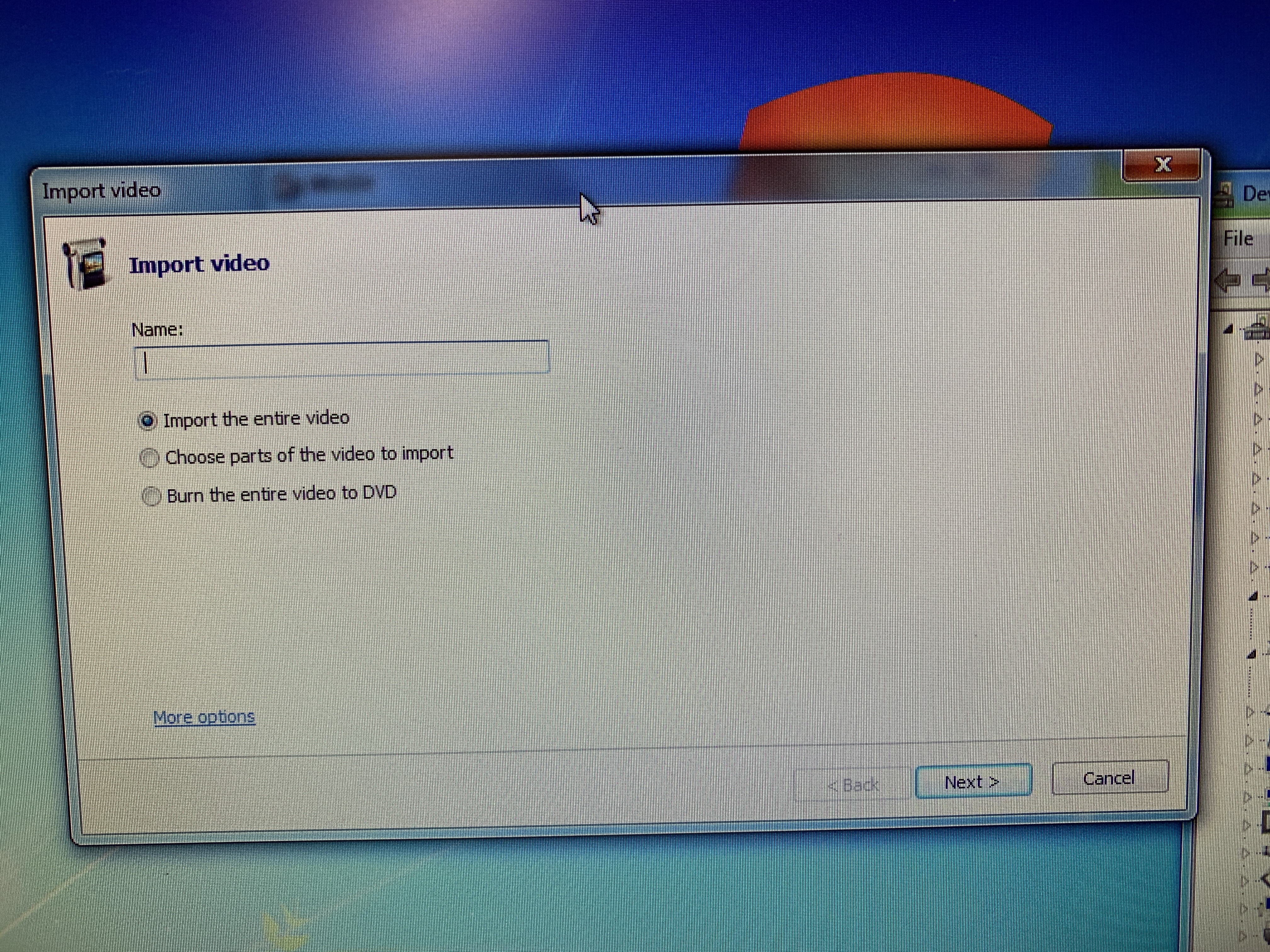

    And a window automatically appeared asking if I wanted to import the video, not sure if this had anything to do with WinDV?
    [Attachment 75328 - Click to enlarge]

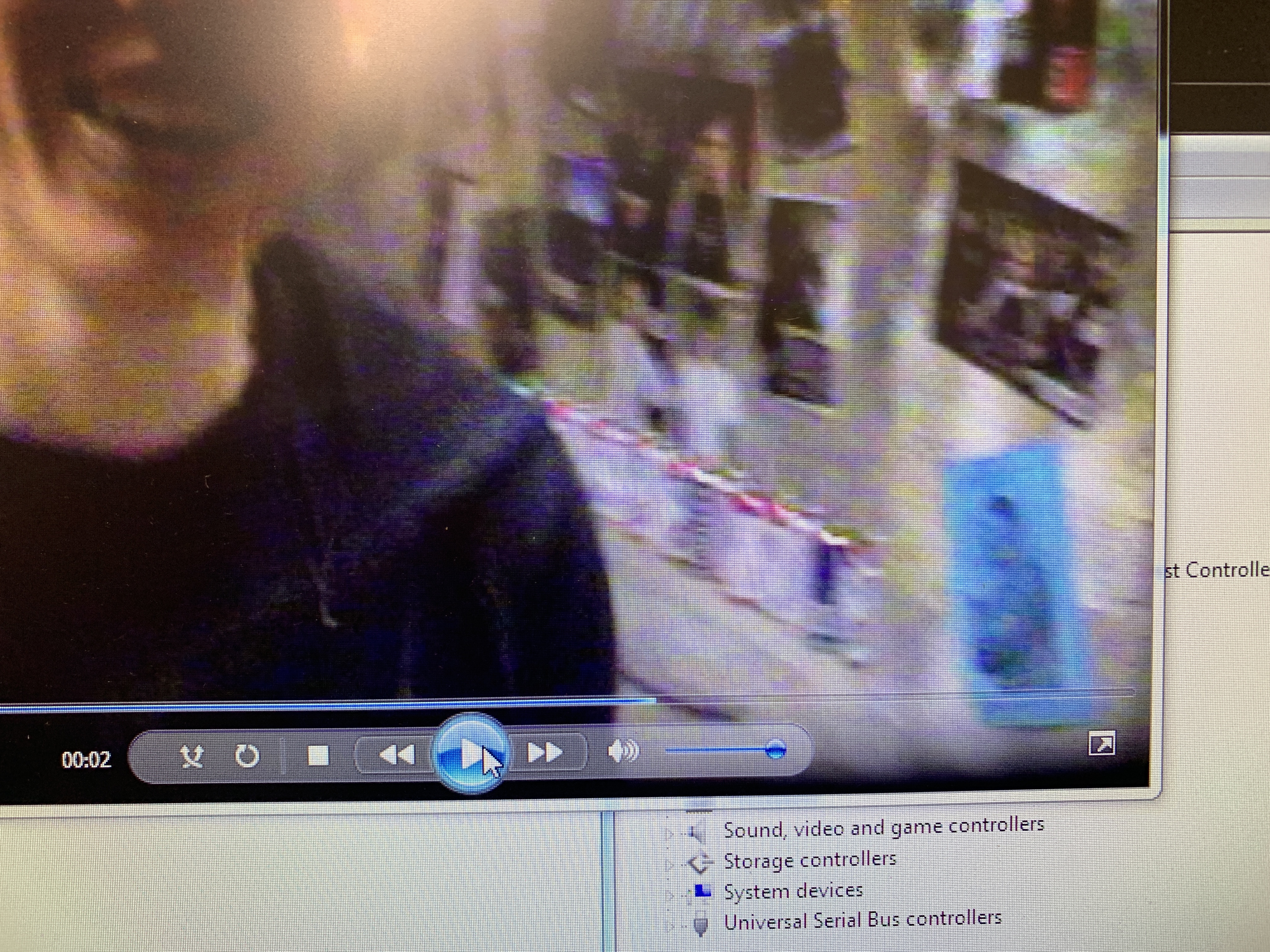

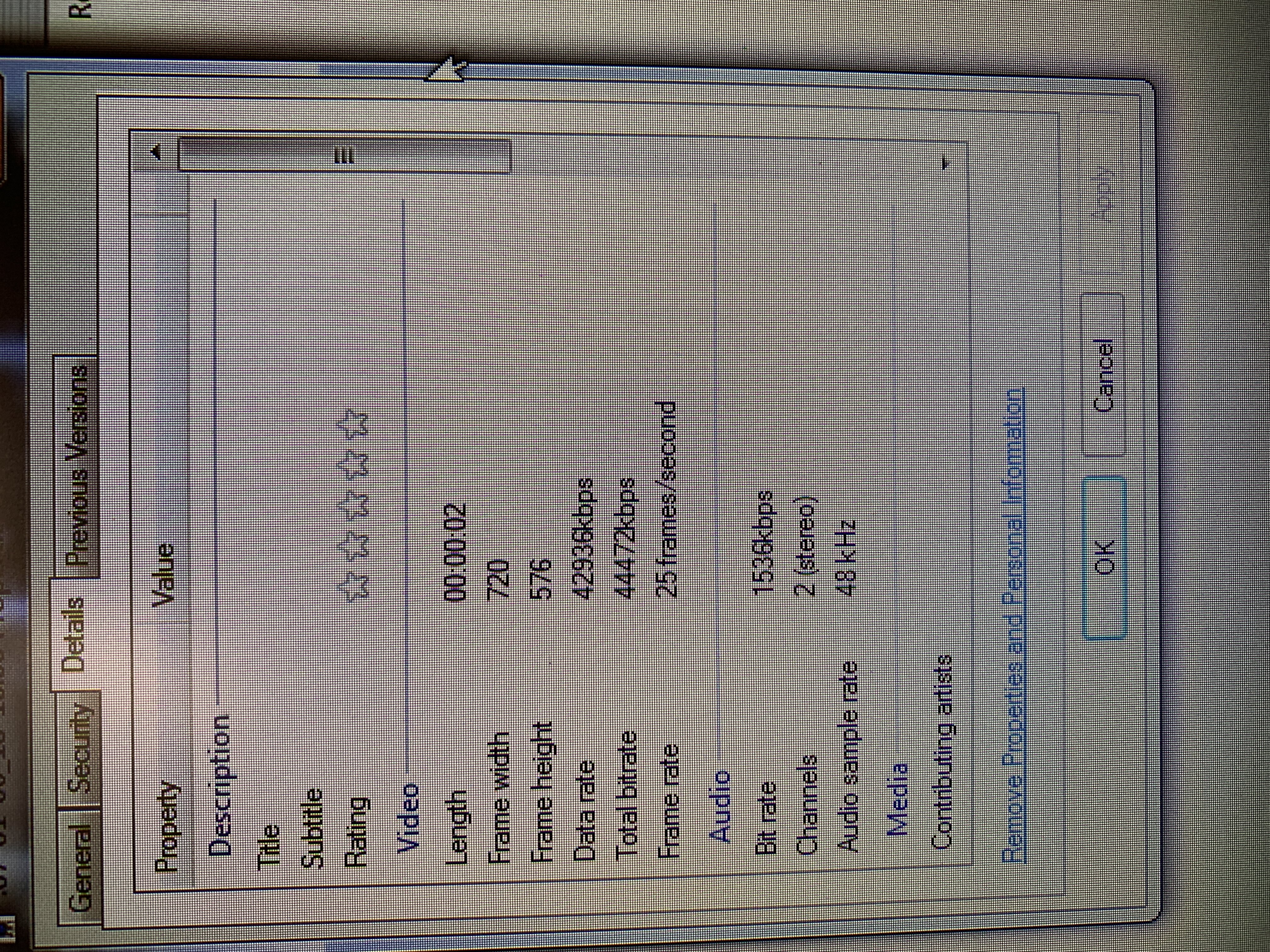

    After capturing a short clip in WinDV I checked the playback quality of the captured video clip.
    In Windows Media Player the clip seemed OK:
    [Attachment 75329 - Click to enlarge]

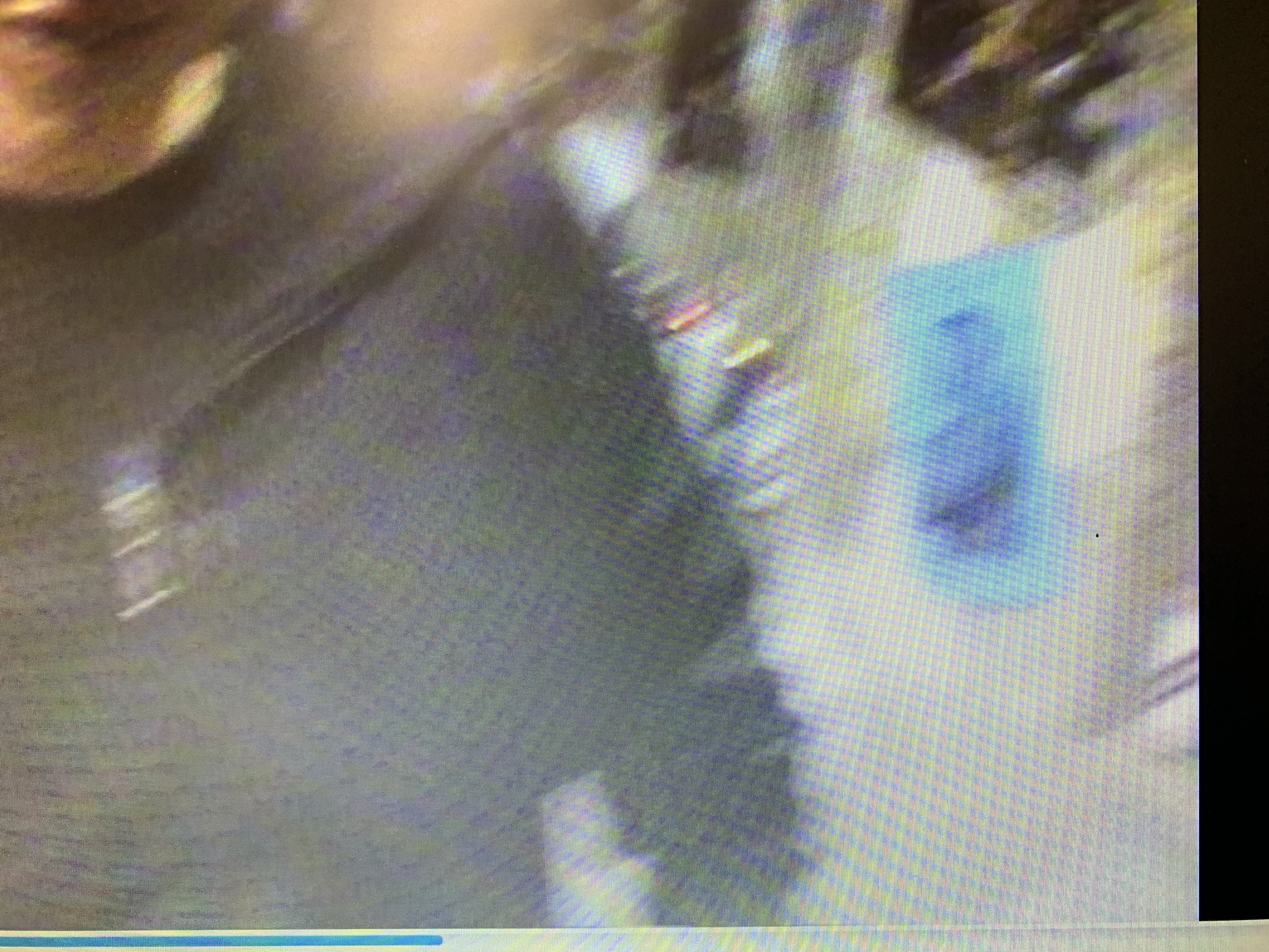

    However in VLC it is washed out (newly downloaded version of VLC:
    [Attachment 75330 - Click to enlarge]
    When I right click on the captured video clip file and select the 'Details' tab these are the settings:
    [Attachment 75331 - Click to enlarge]
    can anyone help with getting the correct import and export settings.
    I guess I need to read a guide on here ref capturing and encoding DV?
    Thanks for all the help so far.

    I did mention above: if you have Firewire on your motherboard, do not insert that PCIe card.
    The "Import Video" screen is a Windows screen: close it.
    If you are able to "import" (better, "transfer") some video with WinDV, that's great, because it can't do anything with the data except just transfer it. Just what you want for DV.
    I can't explain VLC's spazzo on the video.
    A great program for analysing files is Mediainfo. After installing, open a video file in it, go to View>Text, and you'll get a heap of data on the file. In this case, the critical field is the Video Format. If it says DV or similar, you're in business.
    You can set up WinDV to capture one long file or break it up into clips and named by date and time taken. I've let WinDV fall by the wayside because it no longer works for me, I use Scenalyzer. If WinDV works for you though, great. If you go onto the WinDV website, there is a great interactive feature (mouse pointer on each part of the screen) that explains each part.
    Once you've transferred the video onto your PC, you can edit, deinterlace, recode into MP4for general viewing. DV files generally are not supported by TVs. The only way I can play my DV files is through the Apple TV, but MP4s are playable by everything.

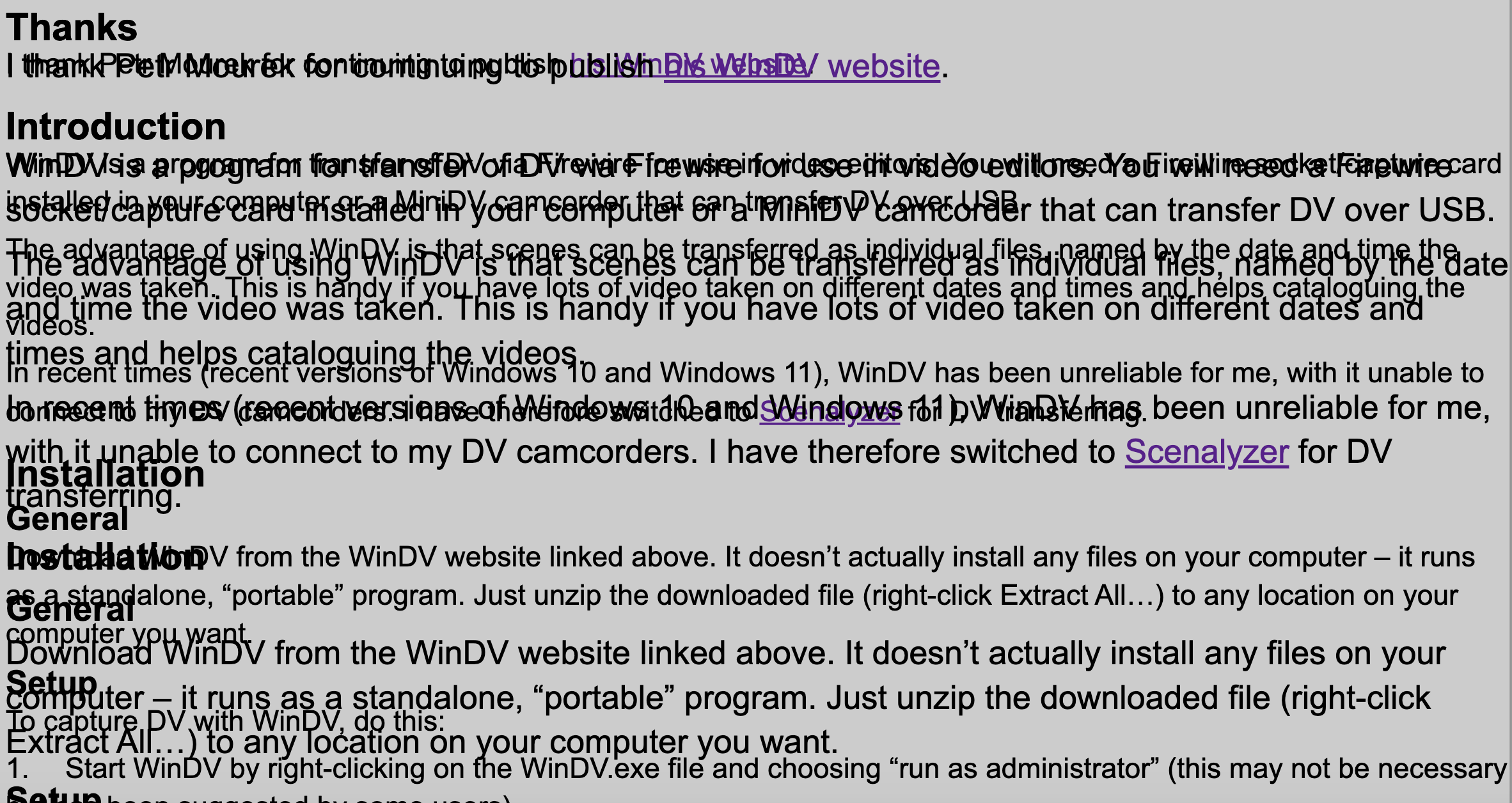

    I've resurrected my WinDV transfer/capture tute.

    As Alwyn mentioned, install mediainfo and send a text-mode report of that clip.
    The vlc 'window' looks odd so I suggest you look at the video settings for that rather than blame the DV clip.
    Even so, the bitrate for the DV clip is much higher than what is to be expected. Hence the need to see what mediainfo is reporting.

    Display aspect ratio : 4:3
    Frame rate mode : Constant
    Frame rate : 25.000 FPS
    Standard : PAL
    Color space : YUV
    Chroma subsampling : 4:2:0
    Bit depth : 8 bits
    Scan type : Interlaced
    Scan order : Bottom Field First
    Compression mode : Lossy
    Bits/(Pixel*Frame) : 2.357
    Time code of first frame : 00:00:00:17
    Time code source : Subcode time code
    Stream size : 161 MiB (95%)
    Audio
    Format : PCM
    Format settings : Little / Signed
    Codec ID : 1
    Duration : 46 s 760 ms
    Bit rate mode : Constant
    Bit rate : 1 536 kb/s
    Channel(s) : 2 channels
    Sampling rate : 48.0 kHz
    Bit depth : 16 bits
    Stream size : 8.56 MiB (5%)
    Alignment : Aligned on interleaves
    Interleave, duration : 497 ms (12.44 video frames)
    Sorry can't read it?
    [Attachment 75338 - Click to enlarge]

    Just use SClive to transfer and don't worry about what VLC or Mediainfo show.
  16. Member DB83's Avatar
    Jul 2007
    Yes, that guide is a visual 'mess'
    But no need to worry. Compare Alwyn's mediainfo report and yours and the critial info is identical. So what you have done is fine. As to what MS is reporting is anyone's guess.
    But I would still read the guide prepared by WinDV's author. There is a setting if you do not want each and every time you started your camera to be transfered as a separate clip. Under discontinuity threshold from 'Config' set it to 0 and the whole tape is captured as one.
    And WinDV is fine especially on a Win7 system.
    May 2005
    Australia-PAL Land
    Sorry about my resurrected WinDV guide. I was in a rush to bed. Fixed now, you'll probably need to clear your browser cache to get rid of the corrupted page data. For Chrome>three dots menu>Clear Browsing Data>untick everything except "Cached Images and Files">"Clear Data".
    Corrected guide for WinDV here.
  18. Member DB83's Avatar
    Jul 2007
    Works ok for me now (not that I needed it) and without any browser settings.
    May 2005
    Australia-PAL Land
    Thanks DB.
    Nov 2009
    Thanks Alwyn, sorted now.
    Nov 2009
    Excellent, we have a connection!
