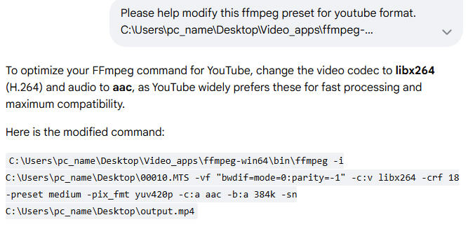

    Just sharing what I have done to de-interlace a video clip taken from a Sony DSC-HX20V camera in 1440x1080i (16:9) 25fps AVC(h.264) to 1440x1080p (16:9) 25 fps HEVC(h.265). I am not an expert so I use Google AI for the ffmpeg preset.
    C:\Users\pc_name\Desktop\Video_apps\ffmpeg-win64\bin\ffmpeg -i C:\Users\pc_name\Desktop\00010.MTS -vf "bwdif=mode=0arity=0" -c:v libx265 -crf 23 -preset medium -tag:v hvc1 -c:a copy -sn C:\Users\pc_name\Desktop\output.mp4
    Some how that stupid sign () is messing up the preset string. Just replace it with : and p. Please refer to his image.
    [Attachment 93284 - Click to enlarge]
    You may need to change the directory settings.
    ffmpeg = C:\Users\pc_name\Desktop\Video_apps\ffmpeg-win64\bin\
    source file = C:\Users\pc_name\Desktop\
    output file = C:\Users\pc_name\Desktop\
    If you need to speed things up, then you can ask Google AI for QSV(Intel CPU) and Nvidia(GPU) for hardware acceleration preset.
    I feel this is a cleaner approach. But I could be wrong.

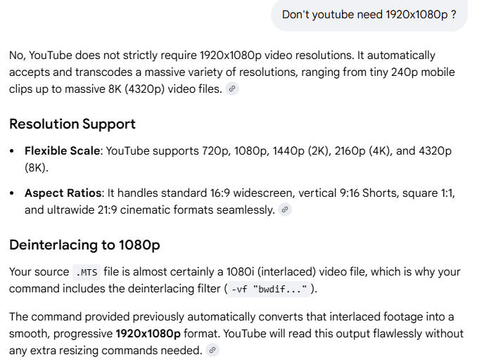

    BTW, I notice that youtube is using AVC 1920x1080p. Just launch google in AI mode and post the above preset and request for 1920x1080p in AVC format output.
    [Attachment 93285 - Click to enlarge]
    [Attachment 93286 - Click to enlarge]
