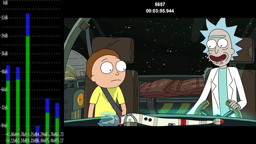

AudioMeter() displays the audio levels over the top of the video. It's exactly the same as using Histogram("audiolevels") in a script that contains video, but if the source is "audio only" it'll create a blank clip to display the audio levels. The same applies to the following functions when no video exists.
AudioMeterL(), AudioMeterR(), AudioMeterT() & AudioMeterB() display the audio levels to the left, right, above or below the video.
The output resolution never changes, so the video width or height is reduced, however the script can crop/resize and/or add borders to the video with the CropResize script as required (using CropResize is the default). If CropResize isn't loaded, the script reverts to "squishing" the picture with Spline36Resize and Borders=true has no effect, which isn't necessarily a bad thing, given the object of the exercise is mainly to view the audio levels.

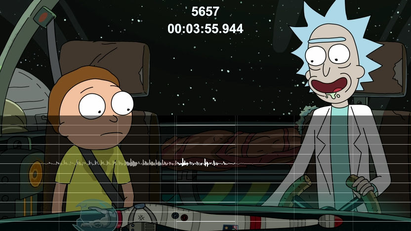

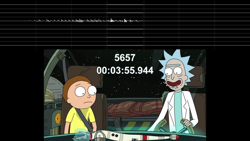

AudioWave(), AudioWaveL(), AudioWaveR(), AudioWaveT() & AudioWaveB() display the audio waveform rather than the audio levels. There's two additional options. "Zoom" for zooming in and out of the waveform and "Window" for specifying the number of frames either side of the current frame for displaying the waveform. The AudioWave functions require the Waveform plugin.
The examples below all make use of the CropResize script for resizing and adding borders, although it's not required.
AudioMeterL(FT=true)
AudioWaveT(Split=1.3, Size=2, FT=true)
AudioWave(Split=0.5, Size=1.5, FT=true)
AudioWave(Split=0.3)
AudioMeterR(FT=true)
AudioWaveT()

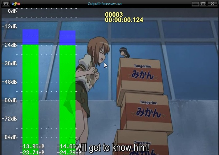

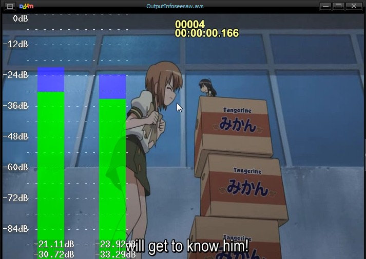

Inspired by Budman1's earlier screenshots I updated the AudioWave and AudioMeter functions to add the ability to display the current frame number and position in time over the video. They both need to be enabled independently as they can be CPU intensive and prevent the script from running in real time. It might depend how CPU intensive decoding the source is, and the resolution, but sometimes a script may run in real time when displaying the frame number or time, but not both.
There's a link for the new version dated 2020-01-10 in the opening post. -
There's another update for the AudioMeter & AudioWave script. It's dated 2020-01-17.
Fixed a silly that meant the displaying of the position in time couldn't always be disabled with Time-false (the default), and added another argument to save some typing.
Frame=true - Displays the current frame number.
Time=true - Displays the time (position)
FT=true - Sets Frame=true and Time=true together so there's no need to use them individually to enable both, and because I couldn't think of a better name than "FT". -
