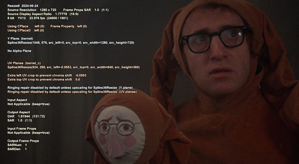

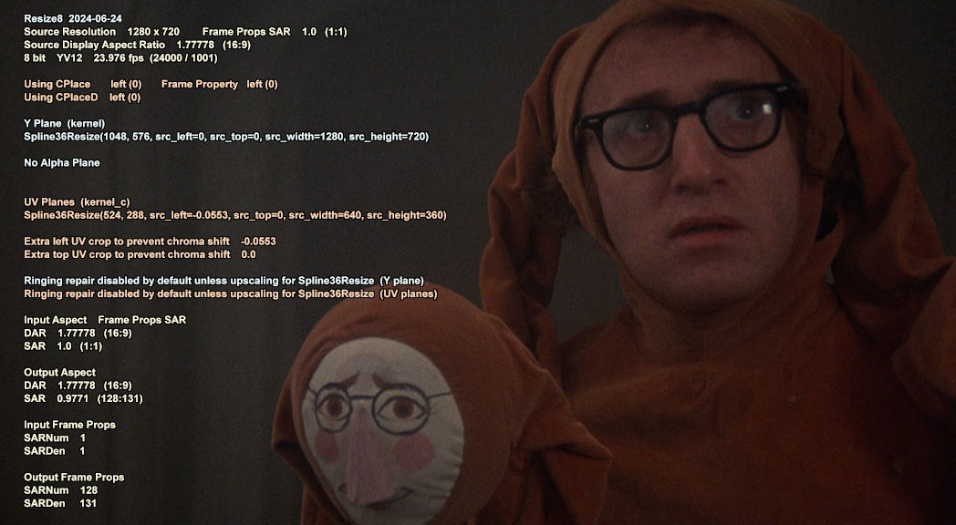

There's also a new argument named Info. Like the Show argument, Info=true displays the resizing strings as well as the input and output aspect ratios, but instead of displaying that info over a blank clip as Show=true does, Info=true displays it over the resized video.
Some examples:
Resizing a non-anamorphic 16:9 video to a different aspect ratio and calculating a new SAR.
The DAR remains unchanged.
Resize8(1048,576, Info=true)
Stretching a non-anamorphic 16:9 video while resizing and therefore keeping the original SAR.
The video has a new DAR.
Resize8(1048,576, keep=true, Info=true)

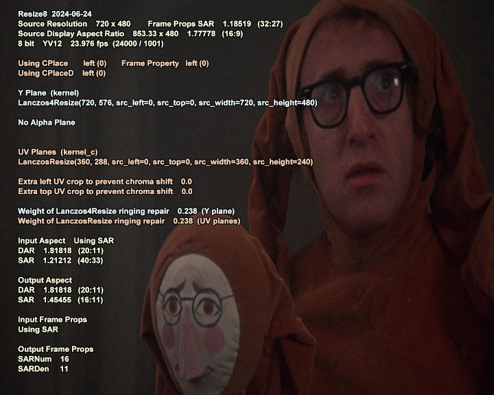

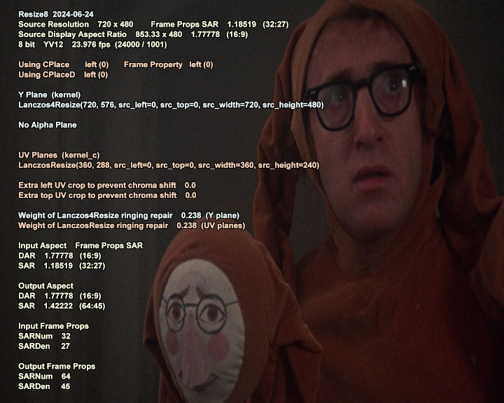

Resizing a 16:9 NTSC DVD to 16:9 PAL dimensions.
Resize8(720,576, Info=true)
Over-riding the SAR in frame properties for the 16:9 NTSC DVD and resizing to PAL dimensions.
Resize8(720,576, SAR=40.0/33.0, Info=true)
or
Resize8(720,576, DAR=20.0/11.0, Info=true)
or
Resize8(720,576, SAR=16.0/11.0, keep=true, Info=true)

New version dated 2024-06-22 in the opening post.
There's also a description of the new functionality, with some pictures to illustrate.Avisynth functions Resize8 Mod - Audio Speed/Meter/Wave - FixBlend.zip - Position.zip

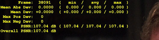

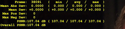

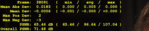

I have some scripts using this function, but I have the old version. If I update the plugin to the new version, is that all I need to do or I might have to tweak the existing settings in the scripts?
The original version and this one have the same default values and their default output's should be the same, assuming of course there's not a chroma location in frame properties other than "left", which would cause this version to handle chroma placement slightly differently. That's not really a negative though.
This version has a few new arguments added, but the original ones still remain, although one difference is when you specify a kernel with the original version it only applies to the luma resizing and the chroma resizing remains unchanged. For this version, specifying a kernel applies to both the luma and chroma resizing and you need to also specify kernel_c if you want a different chroma resizer.
This is the sort of thing I mean (I changed the function name for the original Resize8 to Resize8Old so I could use them together).
PropClearAll() # temporarily delete frame properties, just in case
A = Resize8Old(960,540)
B = Resize8(960,540)
Compare(A, B)
[Attachment 80128 - Click to enlarge]
When upscaling the default for kernel_c is Lanczos (and I'm upscaling).
A = Resize8Old(960,540, Kernel="Bicubic") # still uses Lanczos for chroma
B = Resize8(960,540, Kernel="Bicubic") # uses Bicubic for chroma
Compare(A, B)
[Attachment 80129 - Click to enlarge]
A = Resize8Old(960,540, Kernel="Bicubic", Kernel_c="Bicubic")
or
B = Resize8(960,540, Kernel="Bicubic", Kernel_c="Lanczos")
Compare(A, B)
[Attachment 80130 - Click to enlarge]Last edited by hello_hello; 5th Jul 2024 at 10:12.
