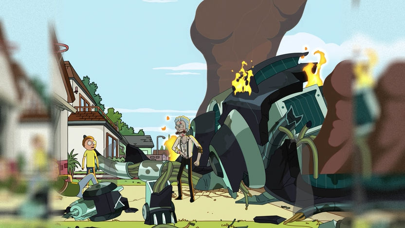

    In addition to the Avisynth version, FrostyBorders now comes in a VapourSynth flavour.
    Support for resizing based on a sample aspect ratio in frame properties has been added to both versions.
    FrostyBorders 2025-12-20.zip
    For anyone who experienced the FastBlur bug (occasional flashes of blocky color in the borders) FastBlur has been updated to version 0.3.2 and the bug should be fixed. Links: FastBlur 0.3.2 / FastBlur 4.0
    Post #2 has instructions for running either the Avisynth or VapourSynth version of FrostyBorders automatically while watching any video in MPC-HC or MPC-BE.
    Post #3 has instructions for running the VapourSynth version of FrostyBorders automatically while watching any video in SMPlayer or MPV Player.
    The simplest way to use FrostyBorders is to specify a width and height, and the script resizes and adds FrostyBorders as required.
    FrostyBorders(832,468)
    You can also specify cropping, and for anamorphic sources, the appropriate input display aspect ratio or sample aspect ratio.
    ie FrostyBorders(960,540, 6,4,-8,-2, InDAR=4.0/3.0)
    Many of the border options can be mixed and matched. Below are some examples.
    Brightness, contrast, saturation, blending, blurring, texture and temporal smoothing can be adjusted for most border types.
    The original and default frosty borders.

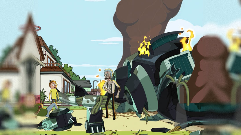

    Feathering.
    FrostyBorders(832,468, Feather=24)
    Clone borders (type 1).
    FrostyBorders(832,468, Clone=1)
    Clone borders (type 3) with border divider.
    FrostyBorders(832,468, Clone=3, BDivider=2)
    (Sides of picture heavily cropped to demonstrate)

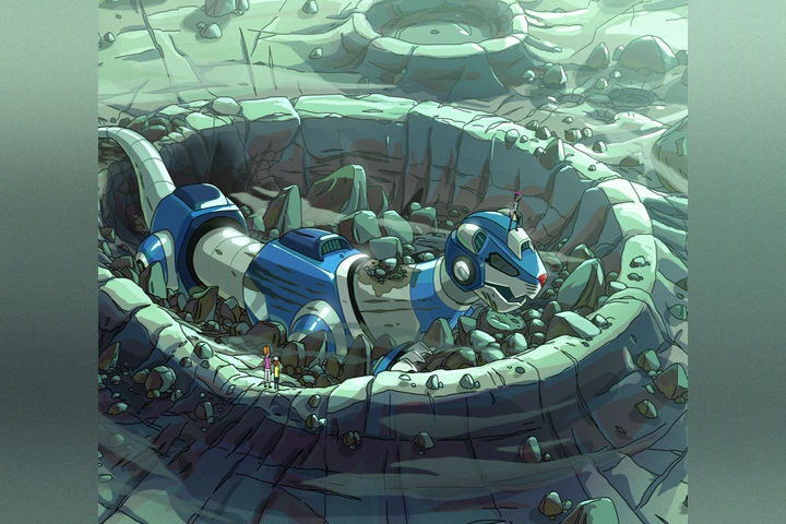

    Static frosty borders.
    FrostyBorders(832,468, FrostyStatic=8756)
    Color borders with gradient.
    FrostyBorders(720,540, FrostyGradient=true, BColor=color_teal)
    Frosty border thumbnails

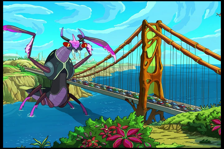

    ImageBorders
    ImageBorders 2021-12-09.zip
    A function for adding images as borders to a video, rather than plain black borders.
    Standard usage is to specify a width and height, and the image(s) to be used for the borders, and the script resizes and adds the image borders as required.
    Border = ImageSource("Border.bmp")
    ImageBorders(640,360, Border)
    A = AVISource("Video.avi").Trim(476,476)
    ImageBorders(640,360, A, Stretch=false)
    A = ImageSource("Elvis1.png")
    B = ImageSource("Elvis2.png")
    ImageBorders(640,360, A, B, InDAR=4.0/3.0)
    Picture courtesy of amaipaipai.

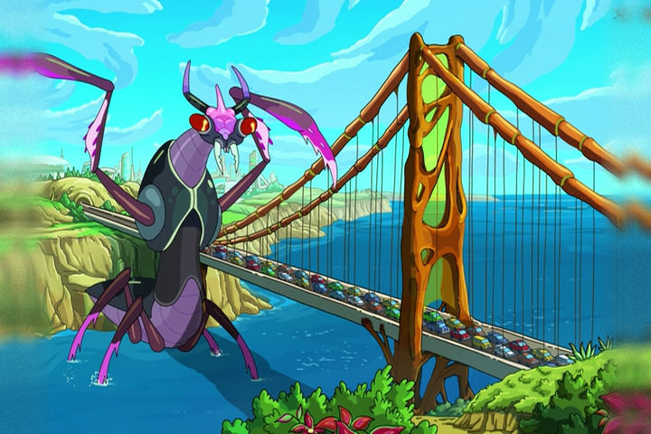

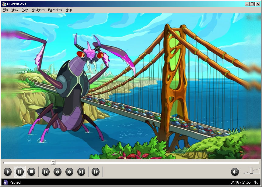

  4. So it's possible the FastBlur mod8 width problem only effects CPUs that don't support SSE4.1 (FastBlur 0.1).
    I don't know why I didn't do it originally, but the "mod8 width fix" version of FrostyBorders now pads the borders to mod8 if need be, blurs them, then crops them back to the original width. The output should be the same as the standard version of the script and there's no longer any output width or height restrictions.
    Both versions of the script are in the zip file in the opening post, now dated 2019-07-20.

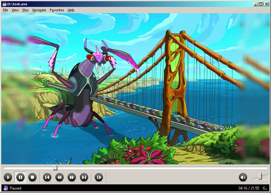

  8. Would you be able to feather the edges between the video and the boarders? I have attached 2 pictures. One is how the script acts now, and the other is the desired effect.
    jagabo was able to achieve this effect in his script. I have posted his below.
    uncropped = potplayer_source()
    src = uncropped.Crop(8,0,-8,-0)
    ZOOM = 1.167
    Spline36Resize(src, int(uncropped.width*ZOOM)/2*2, int(uncropped.height*ZOOM)/2*2)
    Crop(0, (height-src.height)/4*2, -0, src.height)
    alpha = Overlay(BlankClip(last, color=$000000), BlankClip(last, color=$ffffff).Crop(16,0,-16,-0), x=16, y=0).ColorYUV(cont_y=50).PointResize(width/16*2, width).BilinearResize(width,height)
    bg = Spline36Resize(width/16*2,height/16*2).Blur(1.4).Blur(1.4).Blur(1.4).Spline36Resize(uncropped.height*16/18*2,uncropped.height).ColorYUV(gain_y=-50)
    Overlay(bg, last, x=(bg.width-width)/4*2, y=0, mask=alpha)
    Spline36Resize(uncropped.width, uncropped.height)
    float(uncropped.width)/float(uncropped.height) < 1.77 ? last : uncropped

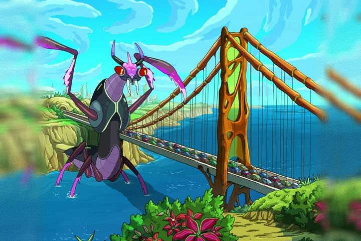

  9. I've used the FrostyBorders function a few times myself lately, which made me aware of some things that could be improved, most importantly ensuring the borders are fairly consistent regardless of resolution. Or to put it another way, the borders added to HD and SD versions of the same video should now look much the same.
    There's also new arguments for adding plain borders with a dark to light gradient and a "frosty" look, for picking a frame from a video with normal FrostyBorders and using those borders for the entire video, and for adding a black 2 pixel divider between the picture and the borders.
    The multithreaded resizers from the ResampleMT plugin are supported and there's a "RStr" argument for specifying resizer options.
    There's a link for the new version dated 2021-08-18 in the opening post.

  12. thebib62,
    I can't say I'm a fan of feathered borders. At least not in combination with the type of borders the FrostyBorders script creates, but I've added an option for feathered borders for you. Hopefully it's close to what you had in mind. I'll just add the link here as I haven't done a lot of testing but it should be okay.
    Link deleted. Link for newer version in opening post.
    It's enabled with FrostyBorders(w,h, Feather=true)
    If you prefer borders without the texture, try FrostyBorders(w,h, Feather=true, Texture=0)
    The blurring options won't do anything as the blurring part of the process is doing the feathering.
    It'll be slower as the only way to blur the existing borders into the picture is to do it with Overlay() after they've been added.
    It won't work when FrostyColor=true (there'll be an error message), but if you use it in combination with Frosty=false it'll blur the edges of plain colored borders, and if you're adding those you can adjust the brightness and saturation.
    [Attachment 60373 - Click to enlarge]

  13. Originally Posted by hello_hello View Post
    thebib62,
    If i am reading that correctly, I can not change the blur intensity/value?
    Thank you for adding that feature to frosty-boarders!

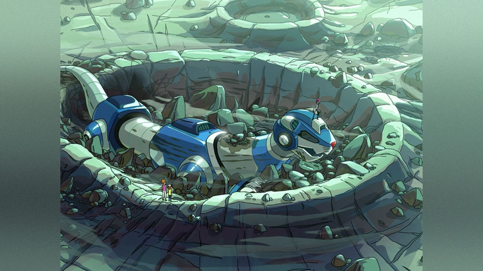

  17. thebib62,
    Looking at your screenshot I think it might be the texture over the borders you're not liking. It has to be included in the feathering but you can reduce it or disable it completely with Texture=0. The default is the height of the picture divided by 100.
    Unlike your screenshot though, FrostyBorders only uses 16 pixels or so from the edge of the picture to create the borders, so it won't have the same "mirror" type look, even when the blurring is reduced and the texture disabled, but that's by design.
    The FrostyBorders function is really just designed to add borders to an already "prepared" picture. For cropping etc, try the CropResize script in my signature. It'll do auto-cropping if the auto-crop plugin is loaded, and there's a cropping aspect ratio argument that can be used to (optionally) crop to a specific aspect ratio. It also has the ability to add FrostyBorders, although I'm updating it to add the feathering etc at the moment but I should be able to upload the new version later today.
    In order not to clutter the CropResize arguments with options that won't be used much, the "frosty" options are set by a separate function, so it'd work something like this. To auto-crop and ensure the cropped picture is 4:3 while adding black borders:
    CropResize(832,468, AutoC=true, CropDAR=4.0/3.0, Borders=true)

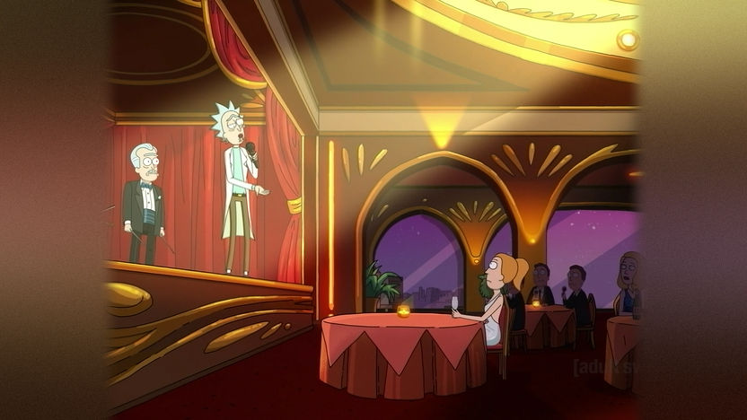

  18. The distortion that I was mentioning before was not the result of the texture value being applied. I've included another screenshot to better illustrate what I'm referring to. The screenshot included illustrates the image being what can only be described as squeezed or skewed at a certain angle. I would like to disable that and have an exact copy on the sides rather than whatever affect is being applied with frosty orders default value and apply a simple fast blur. The other screenshot shows how my current script acts. Also, it seems like the borders refresh at a slightly slower rate than the main video. I was wondering if I could set both the borders and the main video at the same refresh rate?
    As for the cropping, I'm very excited to try out your newly updated plug-in. Should be much easier to enjoy content with all different types of aspect ratios. With that being said, will your updated plug-in be able to force 720 X480 resolutions to 4 x 3 ratios? In other words, all media sourced from DVD do not have a 4 x 3 aspect ratio. It's usually up to the video player to squeeze the image to the correct aspect ratio. I've noticed with frosty borders and with the script that I've been using up until now, this type of media does not play nicely with these scripts. The image is stretched out and these scripts are not being applied to the correct aspect ratio. I'm hoping there is a script that can fix this issue. In the meantime, I've had to run a batch file that re-encodes the entire media file to force it into a 4 x 3 aspect ratio.
    The bat file i am using is below;
    for %%a in ("*.*") do ffmpeg -i "%%a" -vf scale=720:540 "%%~na.mp4"

  19. Originally Posted by thebib62 View Post
    Both those things were by design.
    The original idea was to create borders that change color with the video, but aren't too distracting. They weren't designed to be a duplicate of the picture as such. The script takes pixels from each side (128 or a bit more depending on the resolution), stacks them, runs TemporalSoften on them, then takes 16 or so TemporalSoftened pixels from each side, blurs them and stretches them out to the full border dimensions. The reason for running TemporalSoften over more pixels than are actually used for the borders was to ensure it's scene-change detection would generally be the same as if it was run over the entire picture. Anyway, the idea was to have borders that are quite temporally softened (I assume that's the lag you're referring to) except on scene changes when the borders would change instantly with the scene change.
    So yeah, it's pretty much designed to do exactly what you don't want, or so it seems.
    If you want to post the script for creating the borders you prefer, I could try to create a version that adds those borders, but what would be the advantage of that compared to using your current script? Not that I mind giving it a go if you want me to. We're in lockdown again where I am, so it'd give me something to do.

    There's two screenshots below as example of each. The first was resized to 960x540 with "square pixel" dimensions and the second is resized for a 16:9 720x480 DVD output. If you resize the second image to 16:9 dimensions as a player would on playback, it'll have the same aspect ratio as the first one.
    [Attachment 60502 - Click to enlarge]
    [Attachment 60503 - Click to enlarge]
    Anyway.... I haven't got around to finishing the new CropResize version yet so I haven't uploaded it. I'll try to pull my finger out and finish it off tomorrow but you can play around with the current version. It doesn't have the new FrostyBorder options, but maybe that doesn't matter if you prefer your current script for borders.

    A fake 4:3 NTSC pic to demonstrate:
    [Attachment 60521 - Click to enlarge]
    For PotPlayer, all you should need to do is keep the original dimensions, crop the black, and tell CropResize it's 4:3 in and you want 16:9 out (I'd still use 15:11 instead of 4:3 though).
    FCropResize(Clone=true, Feather2=true)
    CropResize(720,480, 10,14,-10,-24, Frosty=true, InDAR=15.0/11.0, OutDAR=16.0/9.0)
    [Attachment 60522 - Click to enlarge]
    If you have Potplayer set to resize to 16:9, it'll display correctly (same thing, only with MPC-HC).
    [Attachment 60523 - Click to enlarge]
