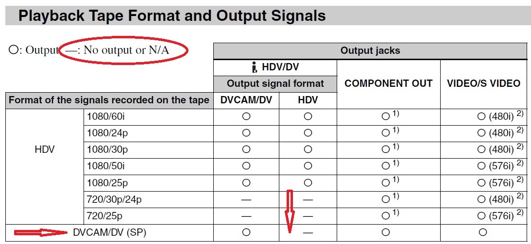

    I don't think you can transfer DV as HDV. Also check the deck standard, Is it in PAL or NTSC, Windows 10 is picky about this, If your computer is in the 60i region and you are trying to use the deck as 50i it may not show up.
    The cassette that I am driving are HDV 50i, from what I understand from that table the HDV i.link output should work
