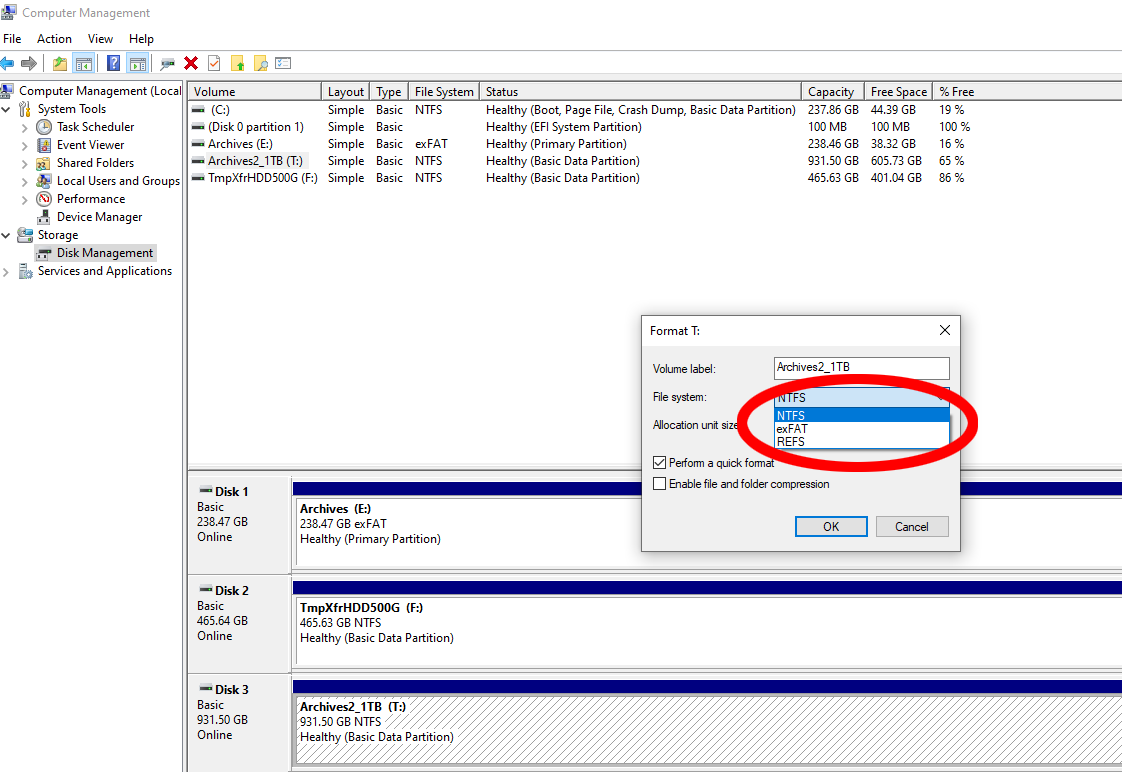

  7. Member Cornucopia's Avatar
    To do a reformat (which of course means wiping all the data currently on the drive!), you would do something like this:
    1. Right click on your computer icon in Explorer, choose "Manage"
    2. Click on "Storage/Disk Management" in the system tree. It will take a little while to read the drives & load. Look at the screencap and see a facsimile.
    3. Select your drive, when highlighted it will have diagonal shading.
    4. Right click & choose "Format..."
    5. Under "File system", choose NTFS or exFAT, not FAT32 (some drives & sizes wonʻt give you much options) - NTFS for best security/features/options/OS integration, exFAT for best cross-platform compatibility.
    6. Click "OK" and wait til itʻs finished.
    7. Use your drive as intended.
    [Attachment 76300 - Click to enlarge]
    <edit>aaahh, @Bwaak you beat me to it!
