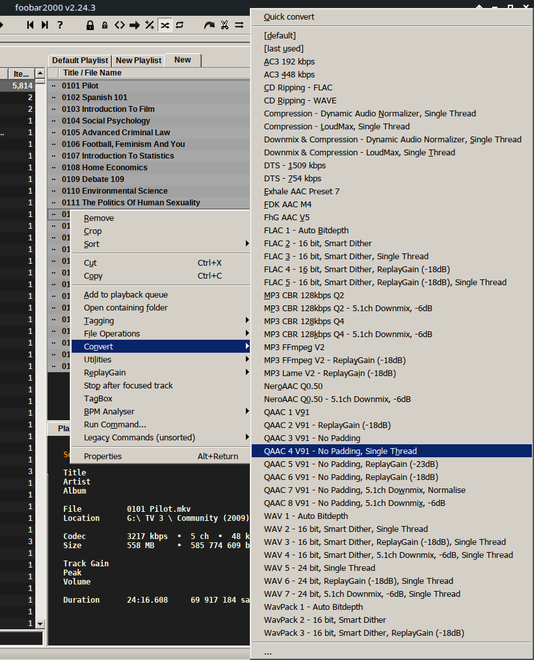

  6. Try this program. It's portable so you can just unzip it somewhere and run it.If I remember correctly I put the Encoders folder on the root of the C drive. If you attempt a conversion though and the program doesn't know where to find the relevant encoder, it'll ask you to show it where it is.
    https://forum.videohelp.com/threads/396860-foobar2000-portable-%28for-audio-encoding%29
    You can load all sorts of files into a playlist. It'll even accept MKVs and MP4s containing video and decode the audio within. You can convert multiple files simultaneously and even convert the same files to different formats at the same time if your hard drive and CPU can keep up. For AAC I'd recommend using the QAAC encoder presets. The one labelled "no padding, single thread" is a preset that enables the QAAC option to remove the padding from the beginning of the encoded file (lossy enocders add a little silence to the beginning and end of the audio). It'll only encode a single file at a time. The preset labelled "no padding" will encode multiple files simultaneously.
    I didn't have anything containing DTS audio handy as I always convert it, but this is the idea. Foobar2000 decodes lossy audio as 32 bit float, optionally runs it through a DSP chain if you tell it to, and most of the encoders accept 32 bit float as the input audio. Foobar2000 does it's decoding with ffmpeg, although you'll need to provide it a copy to use the presets that encode with ffmpeg. I didn't include it in the zip file to keep the file size down.
    [Attachment 86344 - Click to enlarge]

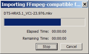

    This is the ffmpeg message I get when I open an DTS file:
    [Attachment 86353 - Click to enlarge]
