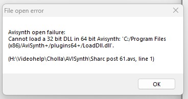

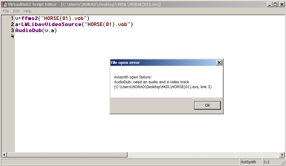

  1. I'm a novice or newb using avisynth with any program.
    I have added plugins to avisynth as other errors appeared.
    Those seem to be fixed now.
    I may install avisynth+ but I wanted to get avisynth working if I can.
    I tried to keep the code simple.
    These are the errors:
    [Attachment 81580 - Click to enlarge]
    [Attachment 81581 - Click to enlarge]

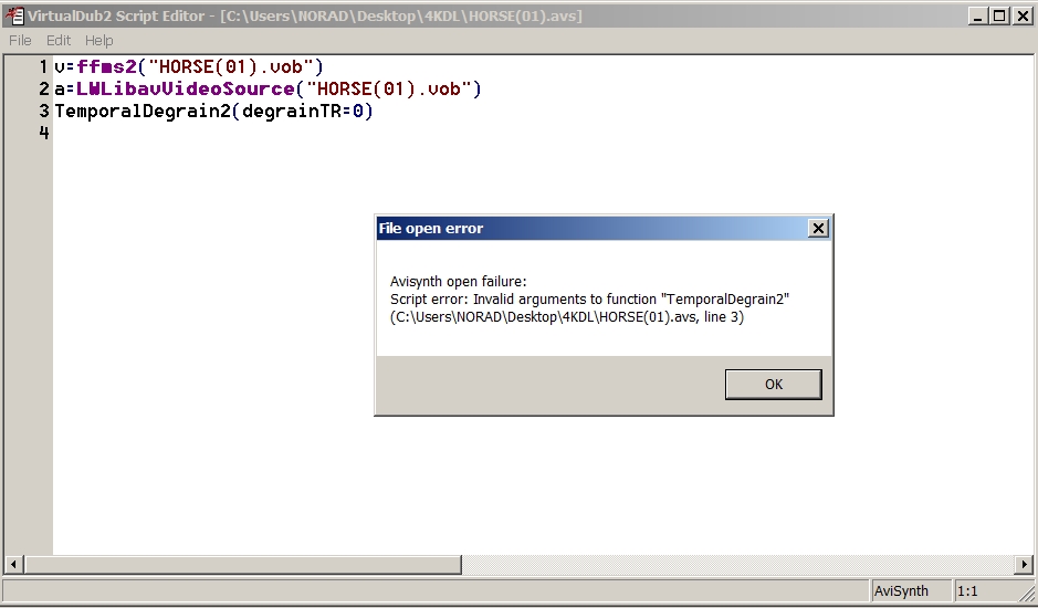

    For the second error:
    V = ffms2("source")
    A = LWLibavAudioSource("source")
    AudioDub(V, A)
    I'm not sure that zero would be a valid value for TemporalDegrain2's degrainTR argument but I could be wrong.
    Dump Avisynth and install Avisynth+. There's no point starting out with an obsolete version.
    And when you do, don't forget to add Prefetch(x) to the end of your script otherwise Avisynth+ will run in single threaded mode (where "x" is an integer specifying the number of threads). TemporalDegrain2 is quite slow, and in single threaded mode it might be slow enough to be impractical.
    http://avisynth.nl/index.php/SetFilterMTMode#Prefetch
  3. Originally Posted by hello_hello View Post
    I was trying what I believe would be the simplest setting first.
    http://avisynth.nl/index.php/TemporalDegrain2
    Suggested settings for removing the grain, sorted by increasing source grain
    degrainTR=0,postFFT=0 (aka Undot)
    degrainTR=0,postFFT=1,postSigma=value between 0 and 1
    degrainTR=1,grainLevel=-1,postFFT=0
    degrainTR=1,grainLevel=0,postFFT=0
    degrainTR=1,grainLevel=0,postFFT=1,postSigma=value between 0 and 1
    degrainTR=1,grainLevel=1,postFFT=0
    degrainTR=1,grainLevel=1,postFFT=1,postSigma=value between 0 and 2
    degrainTR=1,grainLevel=2,postFFT=0
    degrainTR=1,grainLevel=2,postFFT=1,postSigma=value between 0 and 2
    degrainTR=2,grainLevel=2,postFFT=1,postSigma=value between 0 and 2
    degrainTR=2,grainLevel=3,postFFT=1,postSigma=value between 0 and 2
    Any degrainTR above 0 not work for very fast-paced films with many particles flying around (explosions, rain). In this case only this setting will work:
    degrainTR=0,postFFT=1,postSigma=value between 0 and 4
    This is what I plan to do but I want to try the settings you suggest first.
    As I will probably use avisynth on one computer & avisynth+ on another computer.
    Both these computers are 32-bit OS's.

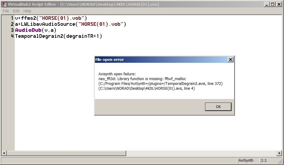

  11. If I set "TemporalDegrain2(degrainTR=x) to any setting except ) 0 I get this error:
    [Attachment 81677 - Click to enlarge]
    I added the "neo-fft3d.dll" that is related to it.
    Before that I was getting an error that avisynth needed it.
    "fftwf_malloc" is a part of "neo-fft3d.dll" as far as I can tell & not available seperately.
  12. FFTW 3.3.5 is a Fourier transform library required by neo-fft3d, fft3d and possibly a couple of other plugins. It's shown as a dependency on the wiki.
    http://avisynth.nl/index.php/Neo_FFT3D
    http://www.fftw.org/download.html
    It was once the case that some plugins required the dll to be named libfftw3f-3.dll and some required it to be named fftw3.dll. I don't know if that's still the case but it can't hurt to put it in the Windows/System32 folder with both names so you're covered. To make it easy there's a zip file attached with the two 32 bit dlls included.
    I deleted the script I used for the Horse sample but I'm fairly sure it was this.

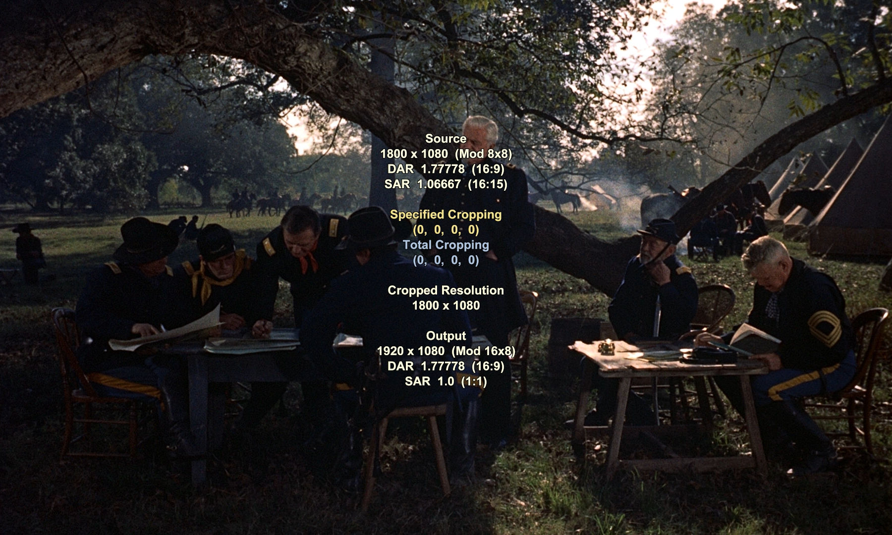

    To stretch it:
    FFVideoSource("D:\Horse.mkv", cachefile="D:\Horse.ffindex")
    Crop(60,0,-60,-0)
    TemporalDeGrain2(degrainTR=2, grainLevel=2)
    Spline36Resize(1920,1080)
    GradFun3()
    Prefetch(8)
    Even though stretching is evil and the main idea behind CropResize is to prevent it, with CropResize you can control how much the video is cropped and/or stretched by fudging the input display aspect ratio.
    Crop(60,0,-60,-0)
    CropResize(1920,1080) or CropResize(1920,1080, InDAR=5.0/3.0)
    Would result in maximum cropping and therefore no stretching when it's resized to 1920x1080 (the aspect ratio after cropping the black is 5:3 or 1.66667 and it'll be cropped to 16:9 before it's resized).
    Crop(60,0,-60,-0)
    CropResize(1920,1080, InDAR=16.0/9.0)
    Would cause CropResize to assume the 1800x1080 video remaining after cropping is supposed to display as 16:9, so it'll stretch it to 1920x1080 without applying any additional cropping.
    Any InDAR between 1.66667 and 1.77778 will give you some sort of compromise between how much the video is cropped and therefore how much it's stretched. You can use one of the cropping previews to preview the cropping (the video isn't resized while the cropping preview is enabled).
    No Stretching.

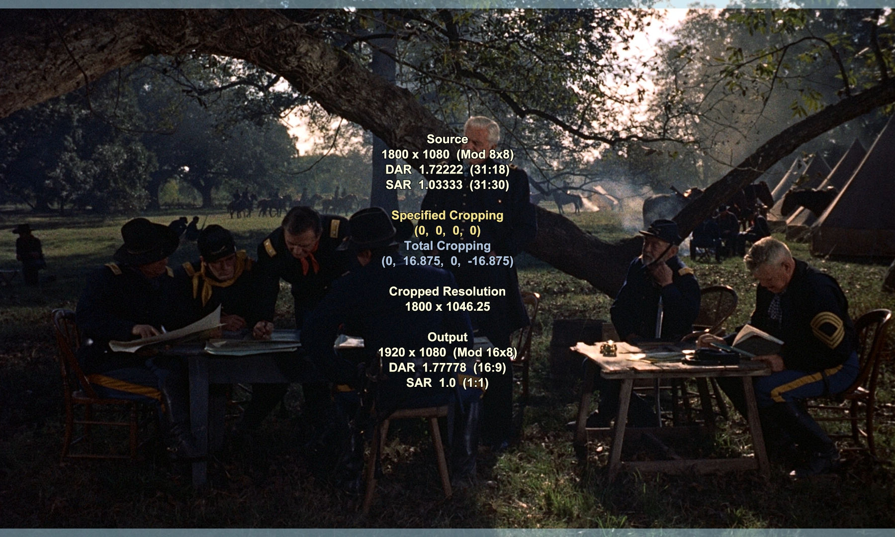

    Medium stretching.
    Crop(60,0,-60,-0)
    CropResize(1920,1080, InDAR=1.72222, CPreview=2)
    [Attachment 81717 - Click to enlarge]

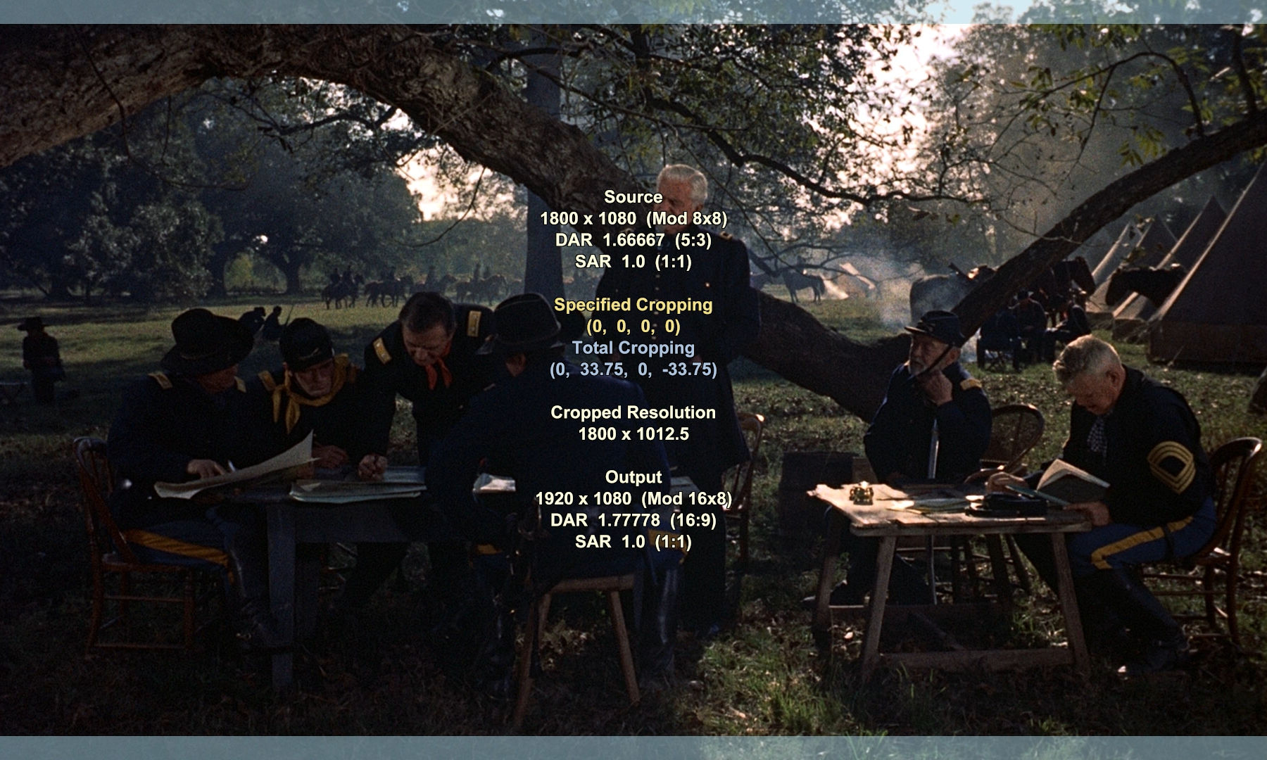

    Maximum stretching.
    Crop(60,0,-60,-0)
    CropResize(1920,1080, InDAR=16.0/9.0, CPreview=2)
    [Attachment 81718 - Click to enlarge]

  13. @ hello_hello,
    I used the .mts file. first.
    Then I created a .mkv file as you did.
    At least maybe the same way.
    I demuxed the .mts file with MKVToolNixGUI to .mkv & .m4a files.
    Then with ffmpeg converted the .m4a file from DTS to acc.
    Then muxed the back together with MKVToolNixGUI.
    At first I'm trying to keep the script even simpler.
    I do not have a "cachefile="D:\Horse.ffindex")"
    or a Horse.ffindex file. How do I create one ?
    I could not use that in the script.
    This is the simpler script I used:
    FFVideosource("Horse.mkv")
    TemporalDegrain2(degrainTR=2, grainLevel=2)
    Prefetch(2)
    If I can get it working with this script then I will try the more complex scripts.
    I did the same using the .mts file instead.
    Both the same results:
    Avisynth open failure:
    neo fft3d: Library function is missing: fftwf malloc
    Mar 2008
    Make sure you have FFTW 3.3.5 installed properly.
    The 64 version of fftw3.dll should be copied into \Windows\System32\
    and the 32 bit version of fftw3.dll should be copied into \Windows\Syswow64\
  15. @ davexnet,
    I already followed those instructions after I found out about the "bassakards" way to do it.
    There is no \Windows\Syswow64\ on Windows 7 32-bit.
    hello_hello posted the fftw3.dll & Alwyn also link me to some.
    They turned out to be the same files.
    Unless you believe the libfftw3f-3.dll is the cause of the Avisynth open failure .
    Why does
    TemporalDegrain2(degrainTR=0)
    load in VDub2
    but
    TemporalDegrain2(degrainTR=1)
    Or any number above 0. I believe the settings for TemporalDegrain2(degrainTR= are -1through 6 .
    Creates the error.
    Searching yeilds very little information on " fftwf malloc".

    If you look to TD2 code, you will see that neo_fft3d is called only when degrainTR>0:
      dgLimit = (degrainTR>0 && firstStepD && limitFFT==1) ? dgO.neo_fft3d(y=LumaD?3:2, u=ChromaD?3:2, v=ChromaD?3:2, sigma=limitSigma, sigma2=dgS2, sigma3=dgS3, sigma4=dgS4, bt=3, bw=limitBlksz, bh=limitBlksz, ow=dgOv, oh=dgOv, ncpu=fftThreads ) : \
    I ignore your installation and set-up, and why it fails. What may help is that you do not automatically load all the plugins but one by one starting from the primary.
    This is my set-up, AviSynth 2.60 32-bit, just as example (YMMV):
    # plugins directory
    plugins_dir="C:\Users\giuse\Documents\VideoSoft\MPEG\AviSynth\extFilters\"
    	# TemporalDegrain2
    Import(plugins_dir + "TemporalDegrain-v2.2.1.avsi")
    	# RgTools
    loadPlugin(plugins_dir + "RgTools-v1.0\x86\RgTools.dll")
    	# MaskTools2
    loadPlugin(plugins_dir + "masktools2-v2.2.23\x86\masktools2.dll")
    	# MVTools
    loadPlugin(plugins_dir + "mvtools-2.7.41-with-depans20200430\x86\mvtools2.dll")
    	# FFT3DFilter
    loadPlugin(plugins_dir + "FFT3dFilter-v2.6\x86\fft3dfilter.dll")
    	# FFTW
    loadPlugin(plugins_dir + "LoadDll\LoadDll.dll")
    loadDll(plugins_dir + "fftw-3.3.5-dll32\libfftw3f-3.dll")
    Start just adding the TD2 line. It will complain about RegTools missing. Add RegTools. It will complain about MaskTools2 missing. Add MaskTools2. And so on.
    edit: If you are not able to solve, just let me know. I can send you a basic set-up to start with, and then you can upgrade as wished
    edit2: example attached. Install AviSynt 2.60, unzip the cholla.zip dir and load the file example.avs in VirtualDub, after replacing my source file with yours. It should work. From there, you can upgrade the plugins, the filters and AviSynth.
    cholla.zip

    To save me 1/2 an hour of experimentation, is loaddll bitness agnostic? It works for both 32 and 64 bit?
    I did spend an hour. And I think I have an answer my own question. It appears that Loaddll doesn't work in 64bit VDub. I put the loaddll provided by Lollo into the plugins64 folder (as well as , and got a 32bit warning on any script I tried to open in 64bit:
    [Attachment 81765 - Click to enlarge]
    I didn't try the linking, because I assume it will still be loading Loaddll and the same error would therefore occur.
    Can someone (@Lollo, @Selur?) please verify then that Loaddll does not work in 64bit.
  30. If you're running 32 bit AviSynth loaddll() will only open 32 bit dll files. If you're running 64 bit AviSynth loaddll() will only load 64 bit dll files.
    If you are opening an AviSynth script with 64 bit VirtualDub you are using 64 bit AviSynth and can only load 64 bit dlls.
