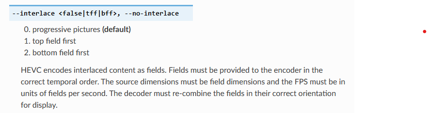

  3. Note that HEVC doesn't really shine until you get to larger frame sizes. So it won't be as beneficial with DVD videos.
    You will also have issues with interlacing. You will have to determine on a case by case basis how to encode. DVD's can be progressive, progressive with pulldown flags, progressive pulled down and encoded interlaced, or fully interlaced. Each must be handled differently.
    But you've raised a really good point. Many/most of the recordings are interlaced. I hadn't expected ACV1 or HEVC would have a problem with this, but I suppose they're only designed for progressive. It might be that I just ignore the interlaced videos entirely, and only convert the progressive ones.
    AVC and HEVC support interlaced perfectly fine, it is used here for the TV/Cable broadcasts every day.
    But you need to know what you are doing when (re)encoding your video.
    (AV1 is another codec, it does not support interlaced it seems)
    My question is,
    ¿are there software HEVC decoders that support interlaced video?
    At least until a couple of years ago, ffmpeg for example was unable to handle interlaced HEVC correctly.

    Nope - interlace can be supported only indirectly - you need to separate fields (simulate manually PAFF from h.264) and later guide your player to combine fields as interlace frame - this probably can be made with some pixelshader or using ffmpeg (ffplay) perhaps mpv (not sure on this) - i'm not aware of standardized way to HEVC native interlace support (to my knowledge it was designed explicitly to not support interlace directly - your encoding tool may behave cleverly and use for example Sequence Adaptive Frame Field to support interlace content but how it will be supported in player side this is big question mark).

    Yes, when searching for interlaced HEVC things are much more complicated then i first thought.
    So better stay with H264 when you want to use interlace.
    That works fine.
  9. True but still - interlace is just separate interlace frame to fields but except this no other interlace coding tools involved so literally you can do this manually and mark field dominance and later combine with help of some tools.
    If you check https://www.itu.int/rec/T-REC-H.265-202309-S/en (not the latest but freely available) then interlace source is described more thoroughly.
