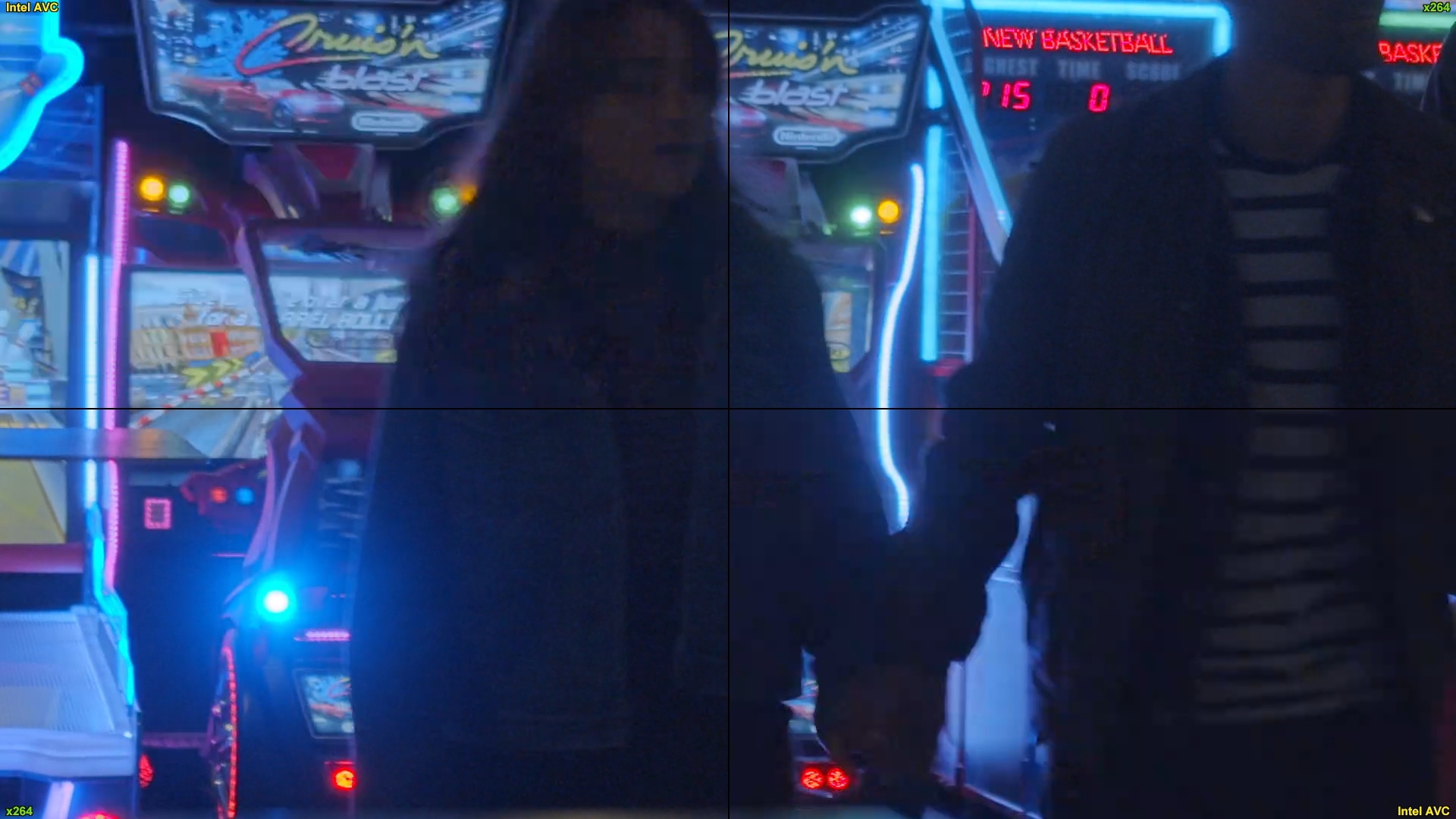

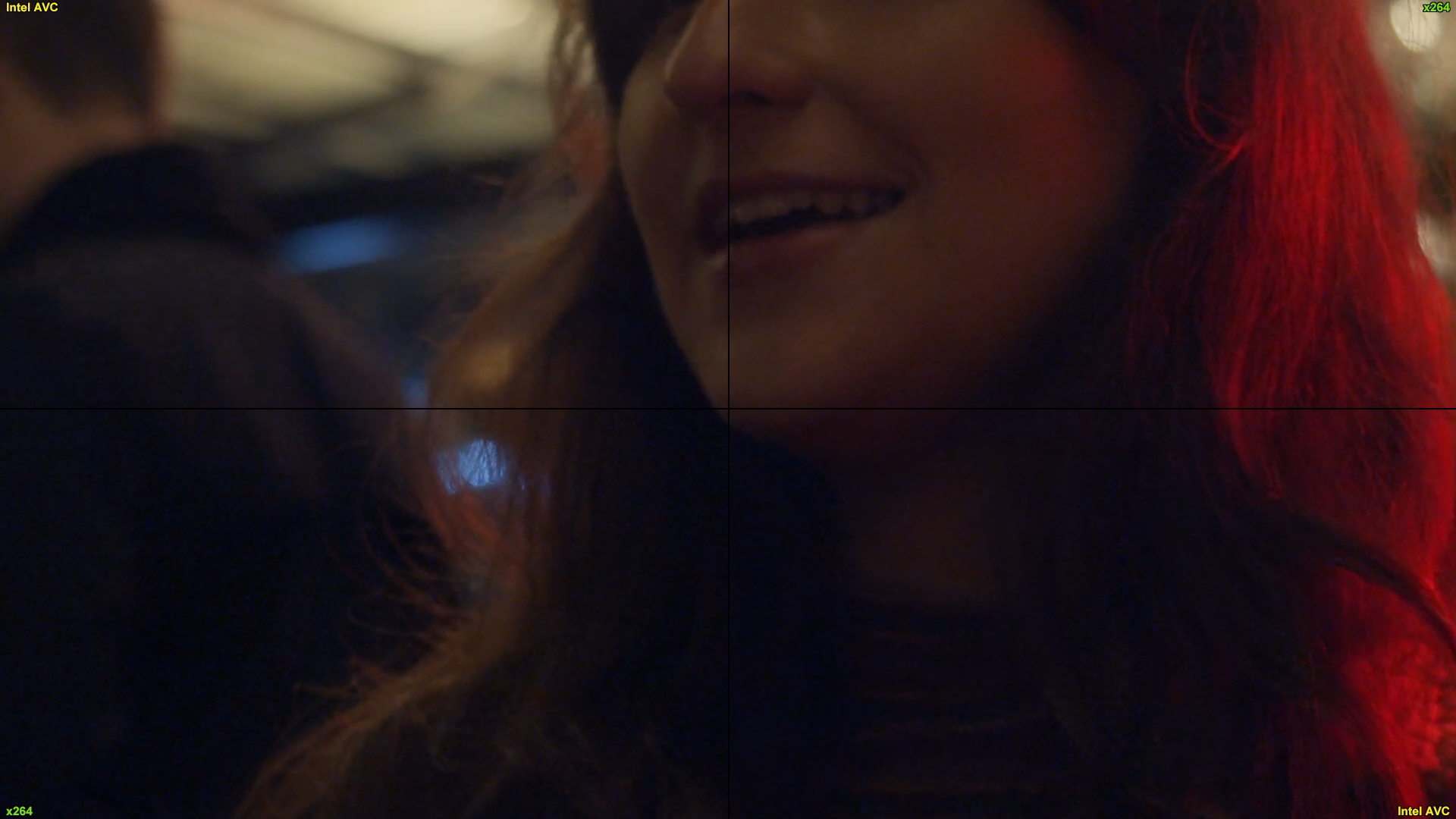

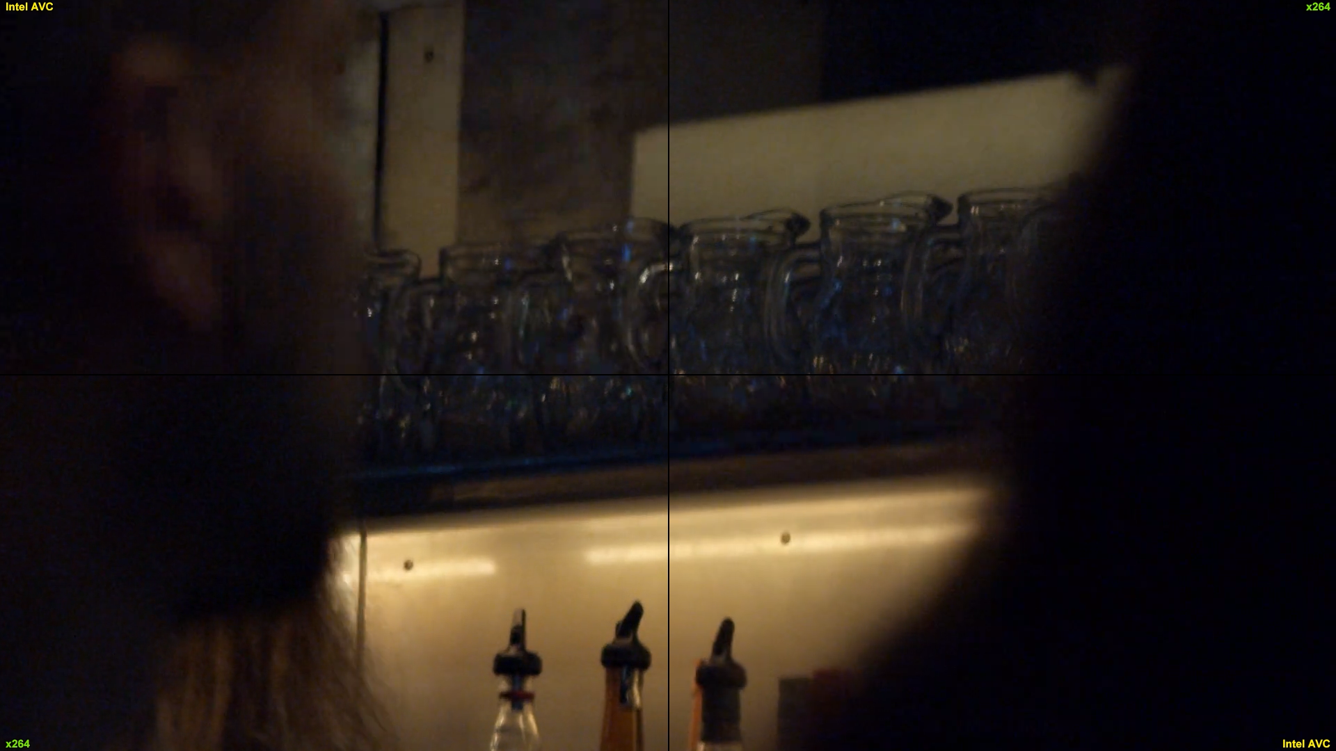

  14. Dinosaur Supervisor KarMa's Avatar
    Jul 2015
    US
    Originally Posted by sophisticles View Post
    To me, and maybe it's all the booze, but I can't tell the difference between these 2 encodes.
    With the last one, the girl's dark neck area just smears like crazy on the Intel QS AVC. There are other scenes with this smearing too with QS but it's hard to show with single frames.
    LoadPlugin(".............LSMASHSource.dll")
    A=LWLibavVideoSource(".............BMPCC_Food_Blogger x264 CRF 24.mkv").crop(960,260,-960,-260).crop(962,0,0,-542).AddBorders(2,0,0,2).subtitle(align=9, "x264", text_color=$7CFC00)
    B=LWLibavVideoSource("....................BMPCC_Food_Blogger Intel ICQ 25.mkv").crop(960,260,-960,-260).crop(0,0,-960,-542).AddBorders(0,0,0,2).subtitle(align=7, "Intel AVC")
    AA=LWLibavVideoSource("...............BMPCC_Food_Blogger x264 CRF 24.mkv").crop(960,260,-960,-260).crop(0,540,-960,0).AddBorders(0,0,2,0).subtitle(align=1, "x264", text_color=$7CFC00)
    BB=LWLibavVideoSource("....................BMPCC_Food_Blogger Intel ICQ 25.mkv").crop(960,260,-960,-260).crop(962,540,0,0).subtitle(align=3, "Intel AVC")
    N=StackHorizontal(B,A)
    S=StackHorizontal(AA,BB)
    StackVertical(N,S)

    Some screenshots of source/intel/x264
    View them at 1:1 or 100%. e.g. in a browser and pan around if viewing on smaller display . Or do I need to crop to areas and highlight some of the differences ? It should be pretty obvious differences (but then again, you couldn't see the different between a youtube encode and one with 2-3x higher bitrate, and very slow encoding)
    0139 - moderate picture degradation and block artifacts start appearing, blocky hair artifact on both male and female, jacket textures eroded . x264 is a b frame too ( that whole title section is pretty bad for Intel)
    0463 - girls shirt lines blurred, jean jacket textures are blurred tilted at the wrong angle (bad motion vectors ?), guys' jacket folds are smoothed away, missing button (what is it with some encoders like MC, Intel and dropping buttons !? are they not important or something ?)
    2051 - hair strands are blurred away in Intel encode. It looks moved at a different angle than the original (the motion vector problem)
