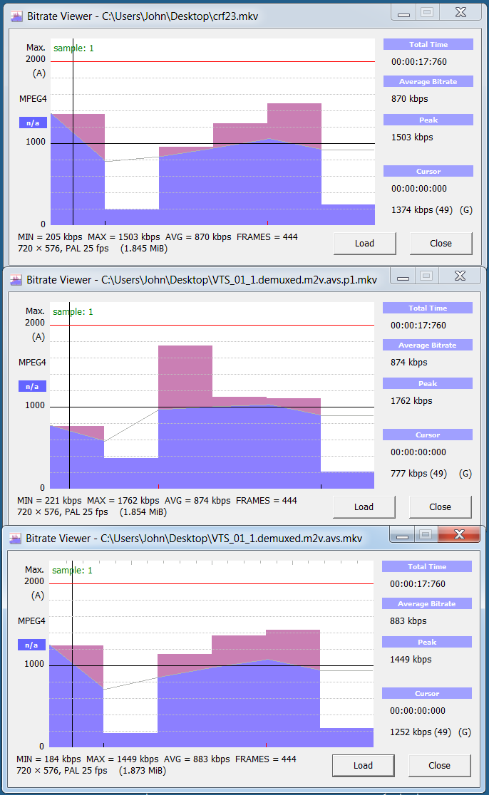

    Here's an example:
    [Attachment 39901 - Click to enlarge]
    Bitrate Viewer is in GOP mode so each bar represents one GOP. The source video is a silent film with lots of scratches, flickering, etc. But the titles have been replaced with noise free placards. The second and last GOPs are those noiseless placards, the others are the original film.
    At the top of the image is a CRF23 encoding. You can see that it allocated very little bitrate to the placards, much more to the other GOPs. In the middle is the first pass of a 2-pass encoding using ABR encoding. You can see it under allocated (relative to the CRF encoding) bits to the first GOP, over allocated to the second GOP, over allocated to the third GOP, etc. At the bottom is the result of the second pass. You can see that it has "corrected" those over/under allocations and produced a bitrate distribution much more similar to the CRF encoding.
