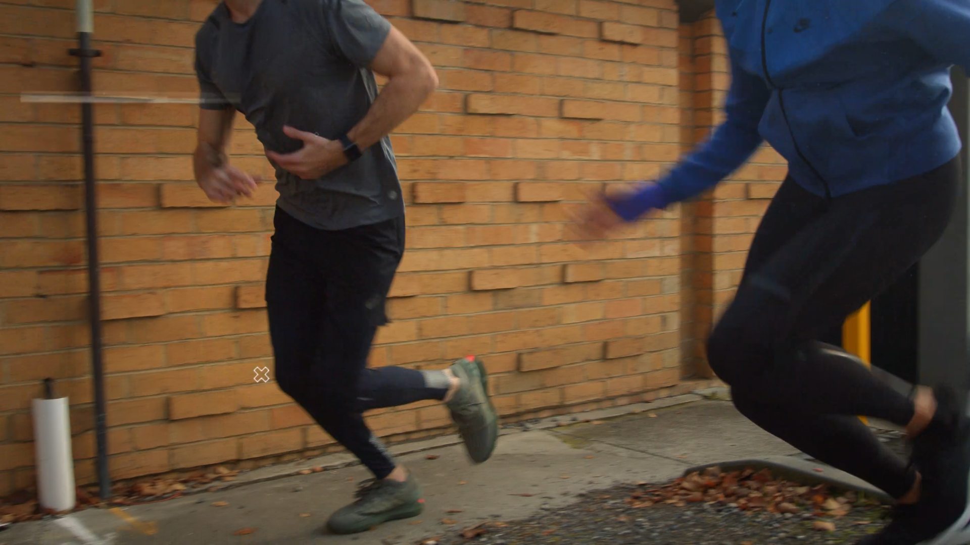

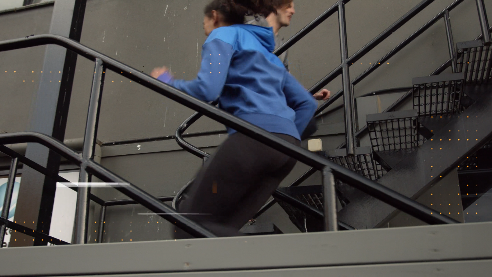

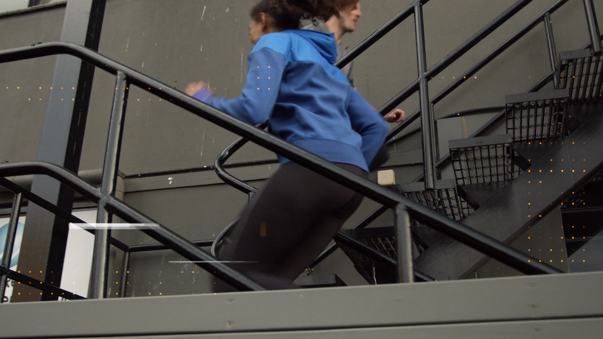

    Anyway.... I only downloaded the running action encodes. These screenshots are only part of the frame so I wouldn't have to resize down due to your obsession with comparing codecs at resolutions they weren't designed for, yet you still managed to show x264 is better, at least where there's movement.
    Where there's less movement, some differences could possibly be attributed more to encoding differences than quality as such, but any real test would include the source files in order to compare encoder "accuracy" where differences don't necessarily translate directly to visual quality.
    If you'd prefer to answer any of the above questions in the other thread, I've already asked many of them there, so I'd be happy to delete them from this post when you do.
    Hover over the thumbnails for a tooltip to show which screenshot was taken from which encode, or check the file names if you open them in a new tab.
    Ed: Whoops I accidentally labelled the QSV encodes as QSC. In my defence, C and V are next to each other on the keyboard.

    Anyway.... I only downloaded the running action encodes. These screenshots are only part of the frame so I don't need to resize down due to your obsession with comparing codecs at resolutions they weren't designed for, yet you still managed to show x264 is better, at least where there's movement.
    And you have an obsession with ignoring the official specs, again AVC can go all the way to 8K, but for you, I will d a bunch of 1080p and 720p tests.
    Where there's less movement any differences could possibly be attributed more to encoding differences than quality as such, but any real test would include the source files in order to compare encoder "accuracy" where differences don't necessarily translate directly to visual quality.
    And the day that video help allows the attaching of 3-5 GB files, I will be more than happy to include the source files. But I did tell you how I created them and you are free to reproduce the source files.
