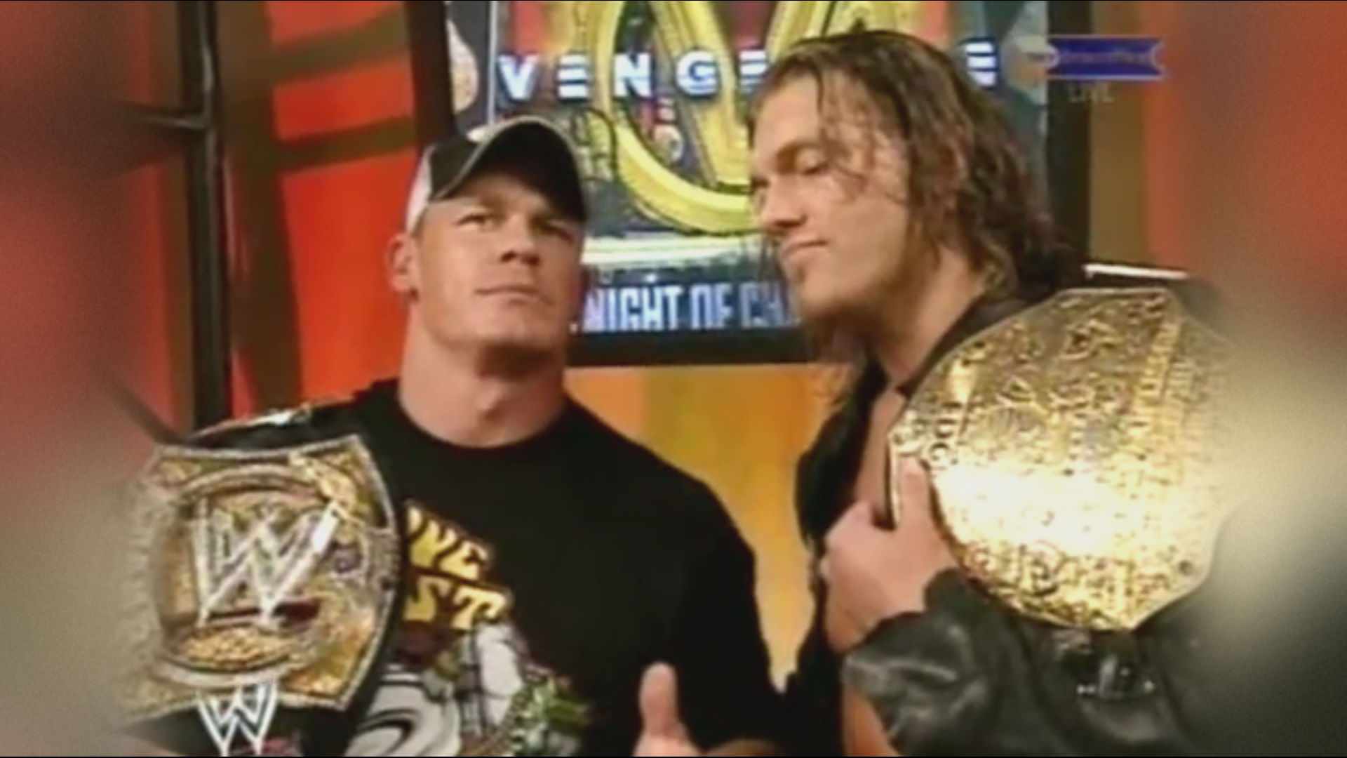

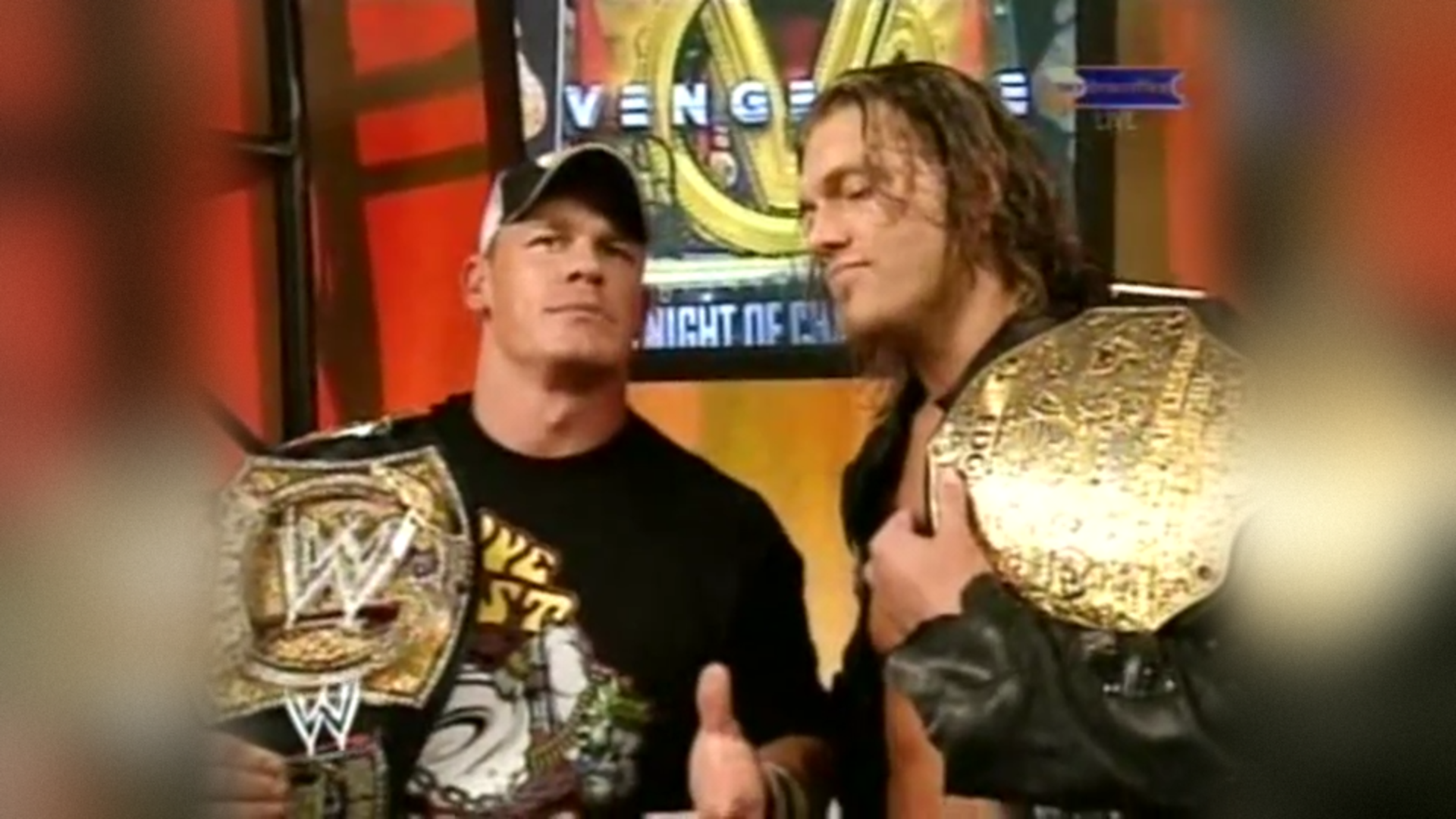

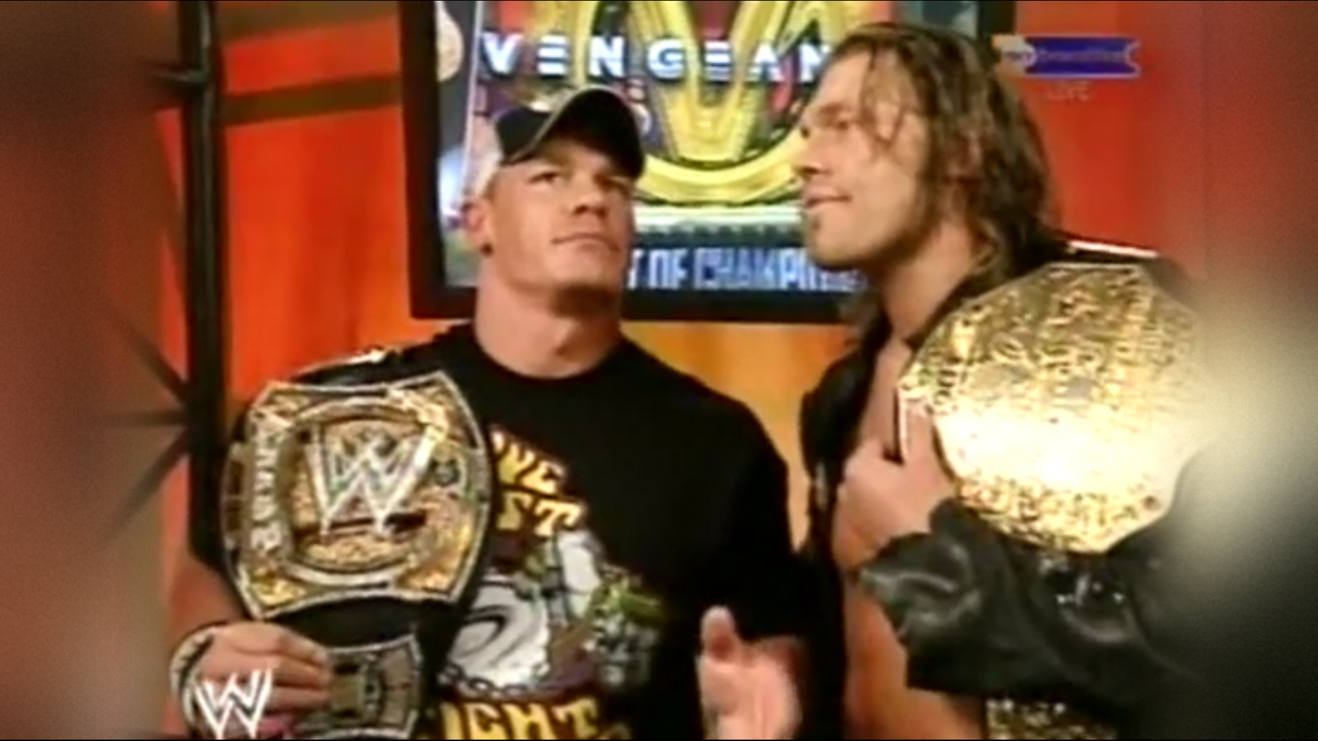

  1. Thank you for fixing that issue with Fcropresize! I was going crazy trying to figure out why my previous settings were not being applied correctly.
    The banding that's present in that screenshot is exactly how it shows up in my video player. The JPEG that I shared does not appear any worse than it does in my video player. I do notice the banding issue regardless if the video is full-screen or not.
    I've noticed that the banding issue that I brought up seems to only happen when there is a texture value applied. If the texture value is set to zero, then I don't notice the severe banding that was illustrated in the screenshot above. I'm using the latest version of AddGrainC (v1.8.3) https://github.com/pinterf/AddGrainC/releases
    I still have the test versions of crop resize that you've uploaded if you need them.
    CropResize(640,480,frosty=true)
    H = height( last)
    FCropResize(Clone=2, Feather=30, Blur=H/20.0, VBlur=H/20.0, Texture=0)
    CropResize(960,540,frosty=true)
    H = height( last)
    FCropResize(Clone=2, Feather=30, Blur=H/20.0, VBlur=H/20.0, Texture=5)
Name:	WWE Vengeance 2007 (Original PPV Broadcast).mp4_20211021_235830.675.jpg
Name:	WWE Vengeance 2007 (Original PPV Broadcast).mp4_20211022_000008.405.jpg

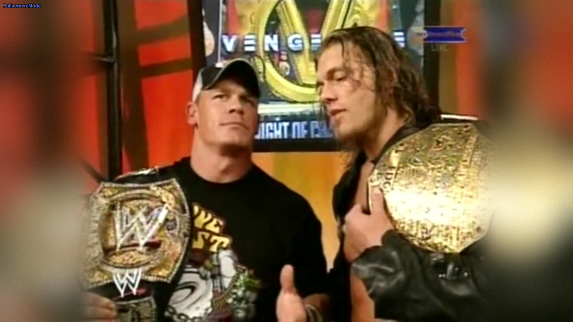

  2. thebib62,
    I'm not sure why AddGrainC should cause banding. I'm still using version 1.8.2 so I'll download the current version to see if it's any different.
    In the meantime I've just uploaded new versions of CropResize and FrostyBorders, both dated 2021-10-22 (another bug fix).
    Edit: I tried AddGrainC 1.8.3 and I still can't reproduce your problem. In fact there's banding in the picture here that's not as easy to see in the borders. You might need to upload a sample video.
    You could also try neo_f3kdb. https://github.com/HomeOfAviSynthPlusEvolution/neo_f3kdb
    It'll add the texture instead of AddGrainC when GPlugin=2. It does debanding but I think I disabled that and just used it to add grain. If I did, maybe I should change that.
    CropResize(640,480)
    H = height( last)
    CropResize(960,540, frosty=true)
    [Attachment 61394 - Click to enlarge]
    By the way, did you check out the negative values for Blur, VBlur and Texture(C) in the help file. They're designed to do something similar to Blur=H/20.0.
    And not that it's likely to be a problem, if the source is 4:3, but you've enabled frosty borders for the first CropResize too (in your example above).
    Another Edit:
    Give this version a spin with GPlugin=2 and compare it to the current CropResize, also with GPlugin=2. For this version I've enabled f3kdb's debanding and dithering (default settings). Texture and TextureC should work as before.
    FCropResize(Clone=2, Feather=30, Blur=H/20.0, VBlur=H/20.0, Texture=5, GPlugin=2)
    CropResize Test.avsi
    PS. With all that blurring and texture your clone borders are looking a lot like frosty borders now.

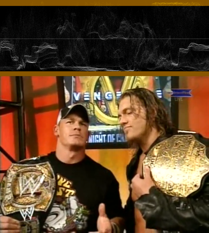

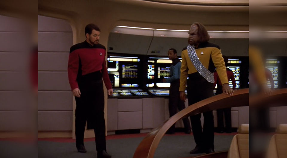

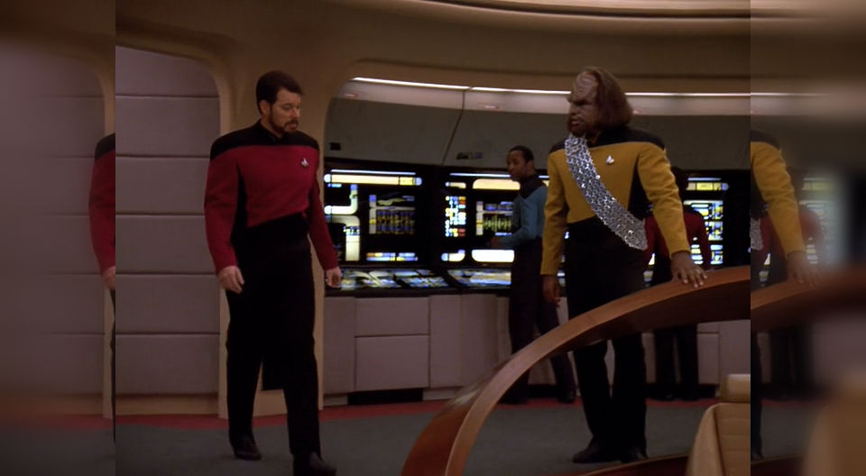

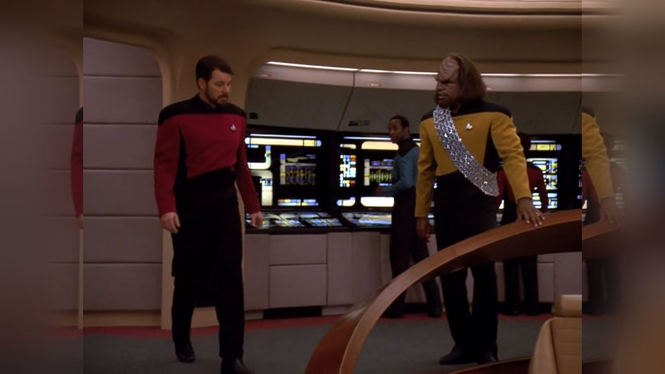

  4. I went ahead and tried the new versions of Fcropresize and frostyboarders and the test version of cropresize. all of which still produced the banding issue. I even switched video players. I've been using potplayer this whole time, and I tried media player classic, same result. I even downloaded the Neo_F3 KDB plug-in you linked to and it made no difference.
    I've noticed this issue with multiple video files, I'm assuming it would apply to any video file. I will share the video file with you.
  5. If your video card and/or PotPlayer is doing any picture enhancing, you may have to ask them to stop. If you compare the screenshots below to the ones you uploaded there's an obvious difference. Why it's only happening when you add texture I'm not sure, but I suspect the banding probably happens (more) with video that has out of range levels. These are all PNGs so you can see exactly what I'm seeing.
    This is a screenshot taken with MPC-HC, so it should be the video untouched from the script output (with Histogram), aside from a conversion from TV to full range levels for the screenshot (image formats are full range, so the player should save a screenshot that way). It matches what I'm seeing when I view the video so I'm confident what I'm seeing is correct. The only thing that's happening to the video I see is a conversion to full range RGB by ffdshow before it's sent to the monitor (my monitor is set to expect a full range input). As you can see there are out of range levels. Anything in the brown areas is outside TV range. Normally that shouldn't be an issue. When the video is converted to full range, anything outside of the TV range would be clipped to black or white.
    [Attachment 61401 - Click to enlarge]
    MPC-HC and the ffdshow script.
    Source
    H = height( last)
    [Attachment 61402 - Click to enlarge]
    MPC-HC via a script (no ffdshow)
    [Attachment 61403 - Click to enlarge]
    MPC-HC via a script (no ffdshow or texture)
    [Attachment 61404 - Click to enlarge]
    PotPlayer via a script (no ffdshow)
    [Attachment 61405 - Click to enlarge]
    I don't think it's a TV vs full range levels issue as such, because without the full range conversion the video looks more "washed out", but your screenshot doesn't look like that. I suspect there's some sort of picture enhancing happening.
    [Attachment 61406 - Click to enlarge]
  6. Interesting, thank you for looking into the issue for me. I will try to do some more bug testing on my end to see if I could figure out the exact cause of the banding after adding the texture value. It's strange that it works perfectly on your end. The only other difference I can think of is perhaps you're using the 64-bit version of FFD show? I'm running the 32-bit versions of every plug-in and media player to get frostyboarders up and running.
    I will definitely look into the video settings of each player to see if it's changing are enhancing the image at all. I'm assuming everything was at default settings while running pot player for those example screenshots that you posted?
    EDIT:
    Eureka! Wasn't expecting to find the solution so quickly after making my previous post. I went into Intel graphics settings and found an option that's labeled "noise reduction"... And lo and behold after disabling it I am no longer experiencing the banding issues.

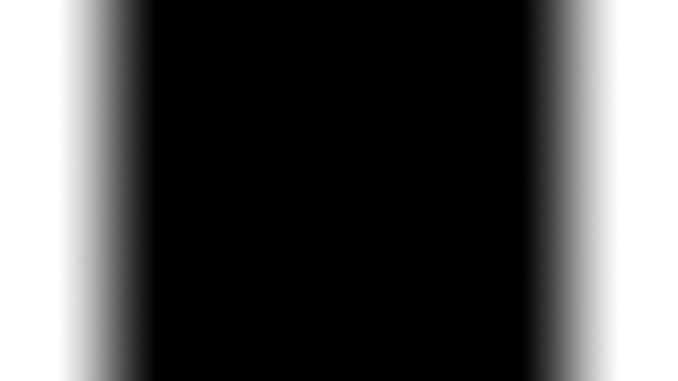

  12. I was looking through the original thread that you had linked to in your readme file crediting riffraff.
    https://forum.videohelp.com/threads/385341-avisynth-how-to-add-borders
    I noticed a post that caught my attention. I was wondering if you had played with the idea of that particular feature in frosty borders? I don't know how well the effect would work in Frostyboarders. I think the idea of having a gradient value start from zero and go to 100% would be an interesting implementation. I would have the blur and texture values start off at zero and slowly make their way to 100%.
    I don't know how time-consuming it would be to implement this feature or if it's even worth implementing in the first place. Would you happen to know any way to experience this effect?

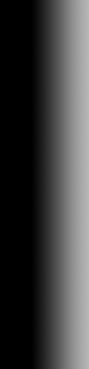

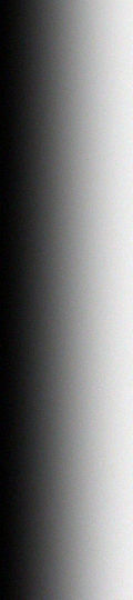

    This will create a 256x256 greyscale RGB ramp that increases from brightness 0 on the left to 255 on the right.
    function GreyRamp()
    black = BlankClip(color=$000000, width=1, height=256)
    white = BlankClip(color=$ffffff, width=1, height=256)
    StackHorizontal(black,white)
    BilinearResize(512, 256)
    Crop(128,0,-128,-0)
    You can then manipulate that as necessary (for use as a mask with Overlay(), etc.) This works with AviSynth 2.6 but may need to be changed for earlier versions where the exact behavior of BilinearResize may vary.
    Image Attached Images

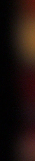

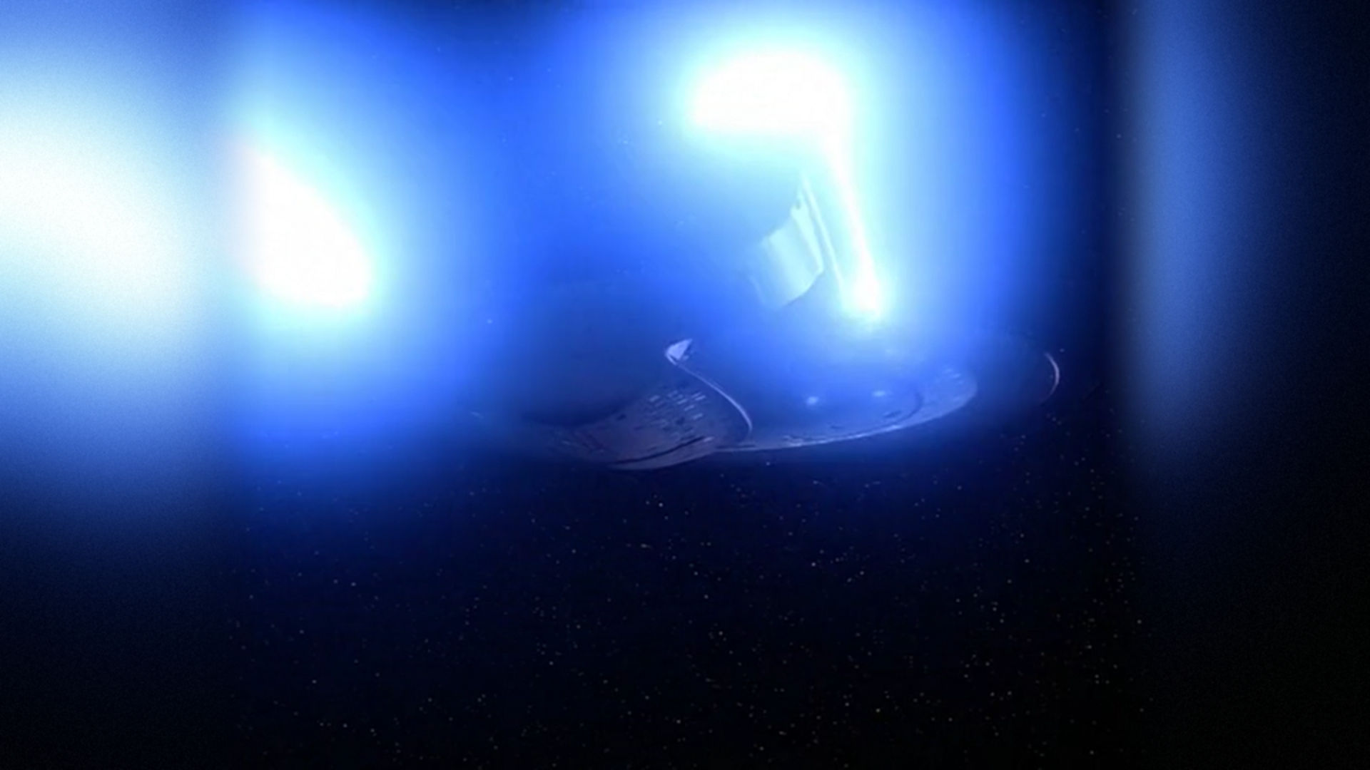

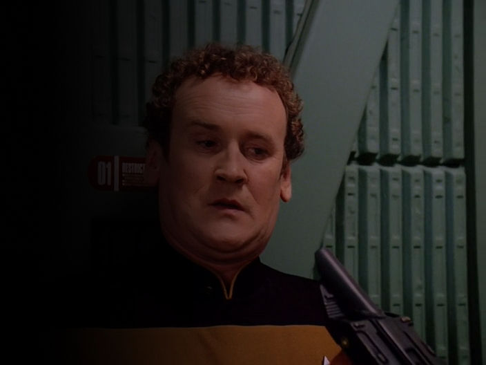

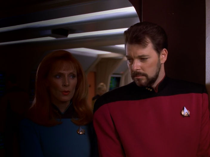

  13. Howdy.
    The greyscale ramp isn't hard, I'm using something similar to do the feathering, although with FastBlur rather than through resizing.
    There's a couple of examples in this post.
    https://forum.videohelp.com/threads/393762-ImageBorders-FrostyBorders-Scripts/page2#post2632715.
    For FrostyGradient=true, the border is a line of 8 pixels of whatever the border color should be, then another 80 pixels of black, then with the right amount of FastBlur it creates a nice gradient which is resized to the border dimensions. It's just a colored gradient though.
    The FrostyGradient=true method would probably work, but no matter how you blur it for the gradient, you'll probably end up with pretty blurry borders, picture-wise.
    To do it with the overlay-mask you'd probably need to have the picture overlayed on pure black, then use the mask to fade from black to picture. You could even add texture to the mask itself for a textured gradient, which may look super good or super bad, I'd have to try it.....
    After trying it, the effect is pretty much the same as adding a black/colored border and feathering it into the picture, only it'd be the border being feathered. Doing the blurring might be easier with a resizer in this case, so the gradient's predictable, and changing the black/white proportion in the mask before blurring might look better, but here's a quick suck-it-and-see on a 4:3 picture (I didn't try adding borders, I just wanted to see what it'd look like).
    A = last
    Black = BlankClip(A)
    HalfWidth1 = width(A) / 4 * 2
    HalfWidth2 = width(A) - HalfWidth1
    Mask = BlankClip(A, width=HalfWidth1, color=$FFFFFF)\
    .AddBorders(HalfWidth2, 0, 0, 0)\
    .ColorYUV(Levels="TV->PC")\
    .FastBlur(100, y_blur=0, iterations=3, dither=true)\
    .AddGrain(var=5, uvar=5, constant=true)
    # return Mask
    return Overlay(Black, A, mask=Mask)

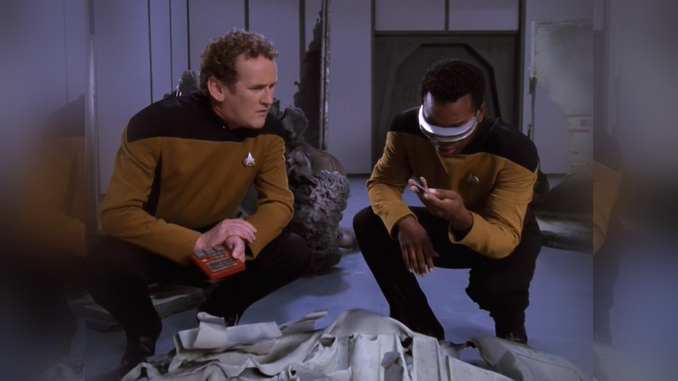

    [Attachment 61541 - Click to enlarge]
    I guess the alternative might be to use a dark version of the picture for the overlay, rather than a completely black picture, but do either of them float your boat? Any other thoughts?
    A = last
    Dark = A.Tweak(Bright=-50, sat=0.5, cont=0.5)
    # return Dark
    # return Mask
    return Overlay(Dark, A, mask=Mask)
    [Attachment 61542 - Click to enlarge]
    To also feather them into the clip would probably require two overlays, which might be a bit slow. For feathering I'm not sure how easy it'd be to create a gradient from black to white and then back to black. At least one that could be controlled easily gradient-wise, regardless of the border/picture size.
    Have a play with the above scripts if you like. Maybe you'll come up with something better.
    PS. To have the gradient fade from dark to light and also have the blurring decrease with the graident. I guess you could also blur the dark version of the picture, but I haven't tried that yet.
    Edit: Yes I have.
    Dark = A.Tweak(bright=-20, sat=0.75, cont=0.75).FastBlur(10, y_blur=10, iterations=3, dither=true)
    It goes in the opposite direction to what you'd want though... I think. It gets less blurry as it get brighter. To do it the other way around would probably require two Overlays with opposite masks, overlayed on each other.

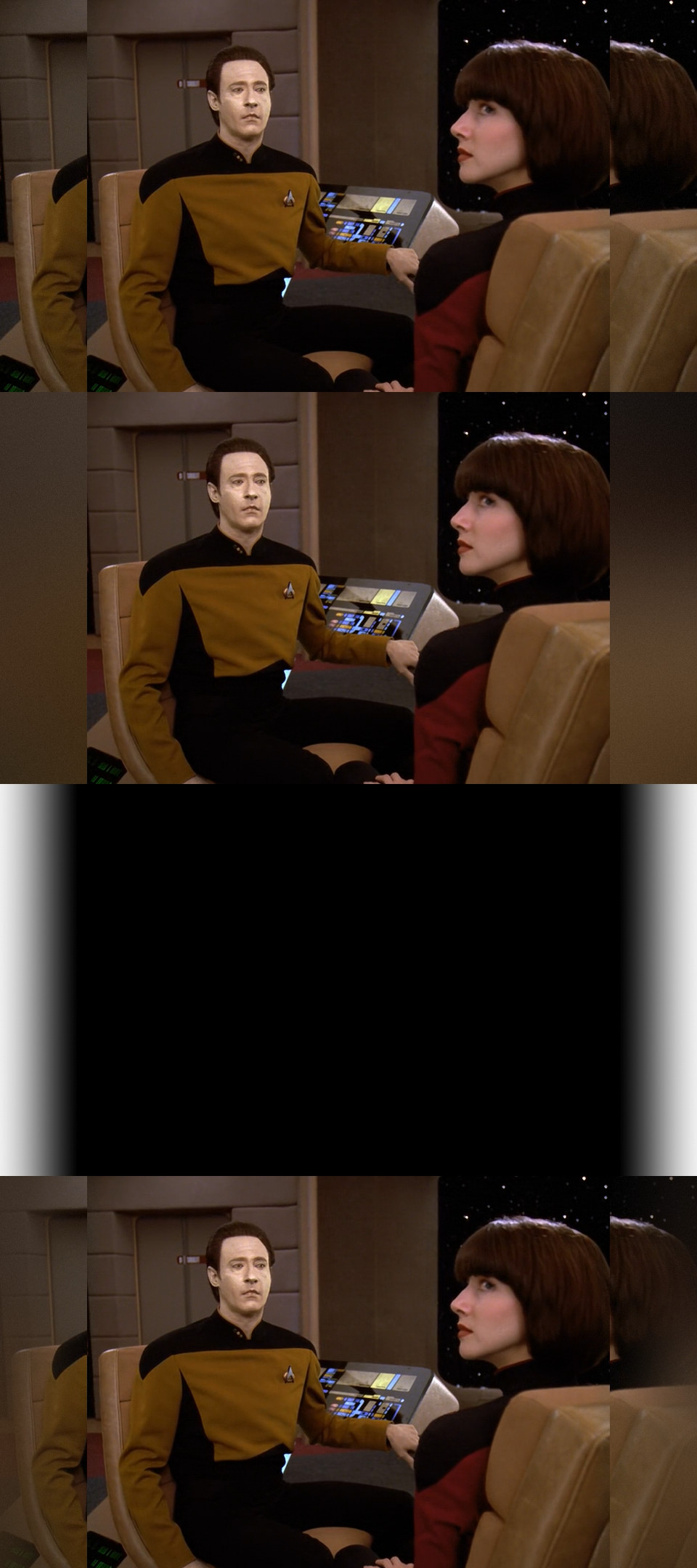

    Edit2. I don't think the "adding some black and blurring it" method will work well (similar to the FrostyGradient method).
    When it's just black to white it seems okay.
    SomeVideo
    CropResize(40, 540)
    A = last
    BlankClip(A, color=$FFFFFF)\
    .AddBorders(80, 0, 0, 0)\
    .FastBlur(30, y_blur=30, iterations=3, dither=true)\
    [Attachment 61543 - Click to enlarge]
    But after replacing the white with picture the gradient isn't as smooth because the brightness of the picture isn't constant. Plus, it has to be blurry as it's part of the gradient.
    SomeVideo
    CropResize(40, 540)
    [Attachment 61545 - Click to enlarge]

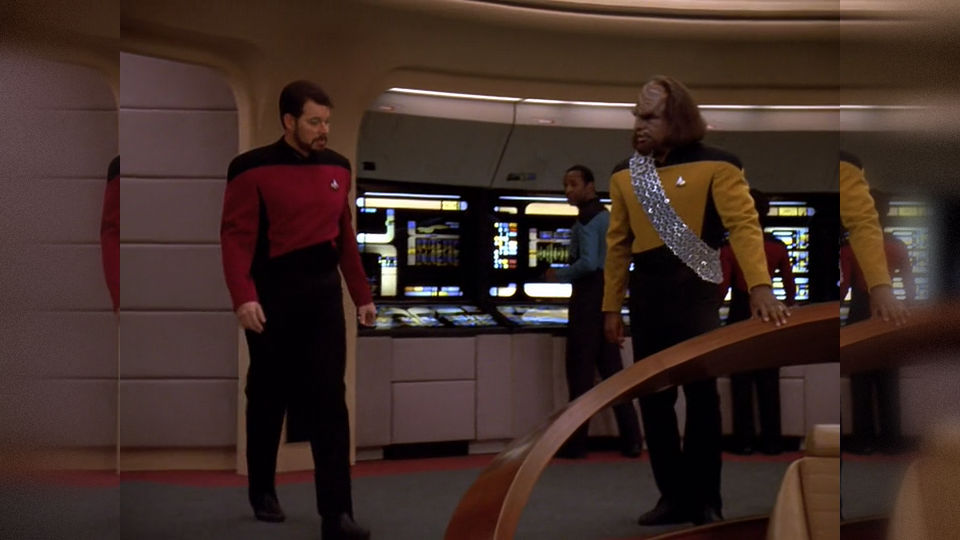

  14. You are pretty quick at implementing these ideas. It looks like you have the foundation of what I'm looking for set up but, rather than having it fade into black, I'd rather it fade into different levels of blur. I've attached a screenshot to better illustrate what I'm picturing in my head. With the screenshot shown below, the first section has a blur value of 10, then, 30 and then 60.
    Allow me to explain in detail. We would have the original 4 x 3 video with frostyborders enabled. Then, have a blur value of zero, then have it gradually increase to the blur value of let's say 60 as it reaches to the end of the video frame.
    So in other words, the closer frostyborders is to the original video the clearer it is, and the farther away from the original video the blurrier it becomes. Again, with a gradient value applied.
    I'm not sure how difficult it would be to implement this feature with blur. Also I'm not sure the type of performance impact this type of feature would make on lower end computers.
  19. I'm trying to get my head around your second screenshot. How did you do that exactly?
    It looks as though it'd take at least two overlays. I'm not sure how easy it'd be to do with just one, or even possible, as there's two versions of the border as best as I can tell. One that's not very blurred but feathered into the picture, and another very blurred version of the border for the gradient.
    I'll have to think about that one as how to do it isn't obvious to me at the moment.
  20. I made the second screenshot using a video editor. I did not edit any of your code to achieve the desired effect.
    It's a screenshot using your last bit of code for this effect, then imported into a video editor, I duplicated the screenshot two times. And feathered the left side and right side until the desired effect was achieved. Shown in the screenshot

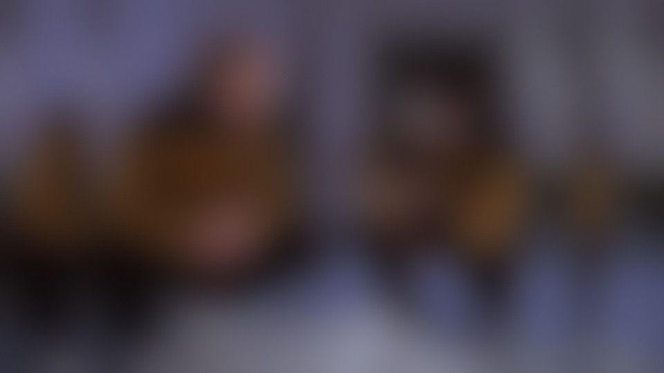

  23. Well I gave it a go but apparently I'm not clever enough to make a gradient that's effective enough to make it worth the effort. I tried different amounts of blurring and I adjusted the mask for the gradient well over 500 times, but I just can't get it to stand out, especially when the blurred borders are being blended into borders that already have some blurring. This is what was happening.
    1. Feathered clip
    2. Extra blurry borders
    3. Overlay mask
    4. The end result
    It'll probably take a bit of work to shoe-horn it in and have it work correctly for every type of border, but it's probably not worth it, even when Blur=0 (which prevents feathering).
    [Attachment 61692 - Click to enlarge]
    [Attachment 61693 - Click to enlarge]
  24. I adjusted the mask for the gradient well over 500 times, but I just can't get it to stand out
    I definitely appreciate your dedication. If it is a feature that's too difficult to implement, and the end result is not a desired one then we can just forget about it.
    My knowledge of AVI synth and coding in general is very minimal. So, I wouldn't have any idea of the amount of time or effort that would go into some of the requests that I have made. Up until this point, you've been able to go above and beyond with every single feature that I wanted. So for that I thank you. I also thank you again for trying very hard to get this to work.
    Would you be able to post the latest code that you use to produce the screenshots with? Maybe I can get lucky and play around with some of the settings myself. If I come up with anything that looks promising I will give you an update.
    Edit:
    your main issue with the examples you last shared stems from the fact that you're trying to feather the borders between the main video and Frostyboarders? I was quite happy with how the gradient looked with the non-feathered borders example you posted earlier. If that could be expanded upon without too much hassle that could be a good alternate method. With that being said, I don't have any ideas to expand upon it myself. Other than it being implemented into the main Frostyboarders script.
  25. I didn't use the standard frosty borders for the example in my previous post. They were Clone=1 borders with Feather=12. For the second screenshot I blurred them a lot more.
    It's a bit hard to post the exact script I used because I modified the FrostyBorders function, and there's variables that won't make sense outside of the function. You should be able to duplicate it this way though.
    The first screenshot.
    SourceVideo = Last.CropResize(720,540)
    BorderedVideo = \
    SourceVideo\
    .FCropResize(Clone=1, Feather=12)\
    .CropResize(960,540, Frosty=true)
    For the second pic I used the Clone=1 borders, blurred them more and added some more grain.
    GradientVideo = \
    StackHorizontal(CloneBorderLeft\
    .FastBlur(80, y_blur=80, iterations=3, dither=true)\
    .AddGrain(var=5, constant=true), \
    SourceVideo, \
    CloneBorderRight\
    .AddGrain(var=5, constant=true))
    If you don't want to crop off the borders and blur them individually, you can just blur the whole first clip.
    GradientVideo = \
    BorderedVideo\
    The gradient mask was this. I kept the total width 88 pixels (24 for the blank clip and 64 for AddBorders) because that's what worked for FrostyGadient=true, but you can change the ratio between the blank clip width and AddBorders to change the black/white ratio, and of course you can change the amount of blurring.
    GradientMaskLR = \
    BlankClip(SourceVideo, width=24, color=$FFFFFF)\
    .AddBorders(64, 0, 0, 0)\
    .FastBlur(25, y_blur=0, iterations=3, dither=true)\
    GradientMaskL = FlipHorizontal(GradientMaskLR).GaussResize(width, height)   # resize to the left border dimensions
    GradientMaskR = GradientMaskLR.GaussResize(width, height)   # resize to the right border dimensions
    # 120x540 for both borders based on the source dimensions above
    GradientMask = StackHorizontal(GradientMaskL, BlankClip(SourceVideo), GradientMaskR)
    And the output:
    Output = Overlay(BorderedVideo, GradientVideo, mask=GradientMask)
    StackedOutput = StackVertical(BorderedVideo, GradientVideo, GradientMask, Output)
    return Output
    # return StackedOutput
    I haven't checked what I just wrote, but I'm pretty sure it's right.
  26. Thanks for the code. I'll try playing around with it to see if I could get anything better from it.
    There is another issue that I notice with the script. When I'm using the clone options, I notice a type of shimmering effect that happens on the borders. It only seems to happen when the blur value is higher than 15. The higher the blur value, the more apparent the shimmering is. This also happens with the default Frostyboarders settings.
    I was wondering if this is happening to you as well? If so, is there a way to remedy this issue?
    If you have a look at the example video I posted before in regards to the banding issue I was experiencing, you'll notice the shimmering effect quite easily. I'll provide the Frostyboarders settings and I'm using currently so you can reproduce on your end. CropResize(640,480,frosty=true)
    FCropResize(Feather=50,clone=2,blend=0,texture=22, vblur=30,blur=20)
    CropResize(960,540, 10,0,0,0, frosty=true)

    I still see it with the example file you provided. If you look at the bottom left and right corners of the video between 38 seconds and 43 seconds you should see what I'm talking about. It happens with low quality medium quality and high quality videos that I've watched so far.
    What I'm witnessing may even be the limitations or behavior of fast blur and not necessarily Frostyboarders.
    The issue that I'm describing seems to only happen at the very corners of the video. Another way to describe what I'm seeing is the image appears to be wobbly. It's not consistent, depends on the scene. And the blur value.
    I know the GIF file that I provided introduces banding, that is not present in the final video. I hope that the shimmering effect that I described is clearer to see. It's almost as if the horizontal or vertical blur argument is too high and stretching the image during certain scenes and creates this shimmering effect. My issue with this shimmering effect is that it's very distracting and it pulls my attention towards the borders rather than focusing on the main video.
    Notice the left edge of the video as well.
    Using these settings makes the issue very apparent
    FCropResize(Feather=50,clone=2,blend=0,texture=0,blur=70)
