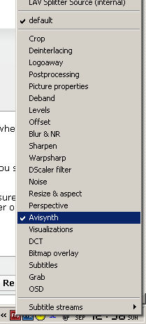

    I meant to ask, have you played around with ffdshow's presets? I ask because a preset can save each filter's configuration, including, I'm fairly sure, the syntax added to the Avisynth filter. And if you have ffdshow configured to display it's icon, you can easily enable or disable a filter or switch between presets with a couple of mouse clicks.
    [Attachment 60577 - Click to enlarge]
  4. Yeah I'm still here, excited about the new crop resize, and I'll play with the new Tsoft argument when I have some time later today. The more options we have for frosty borders, the better.
    I did not know about the ability to switch FFDshow presets. I was able to figure that out, and in my search for making frosty borders as automated as possible, I found something that may be the answer to what I am looking for. I'm hoping that you would be able to implement the "preset autoload conditions" setting I found in FFDshow. If you scroll down, there is a option for on pixel aspect ratio match and picture aspect ratio match.
    Maybe you knew about this before, what do you think? Do you think this would work? I'm assuming that this is sufficiently more effective than using the following line of code float(W) / float(H) >= 1.76 ? Source : \
    I would love to have each frosty borders script that I customized, automatically load for its appropriate video aspect ratio. My hope is to eliminate the need to manually switch between profiles and have that done automatically by FFDshow when a video meets a certain condition. I haven't had time to play with this yet.

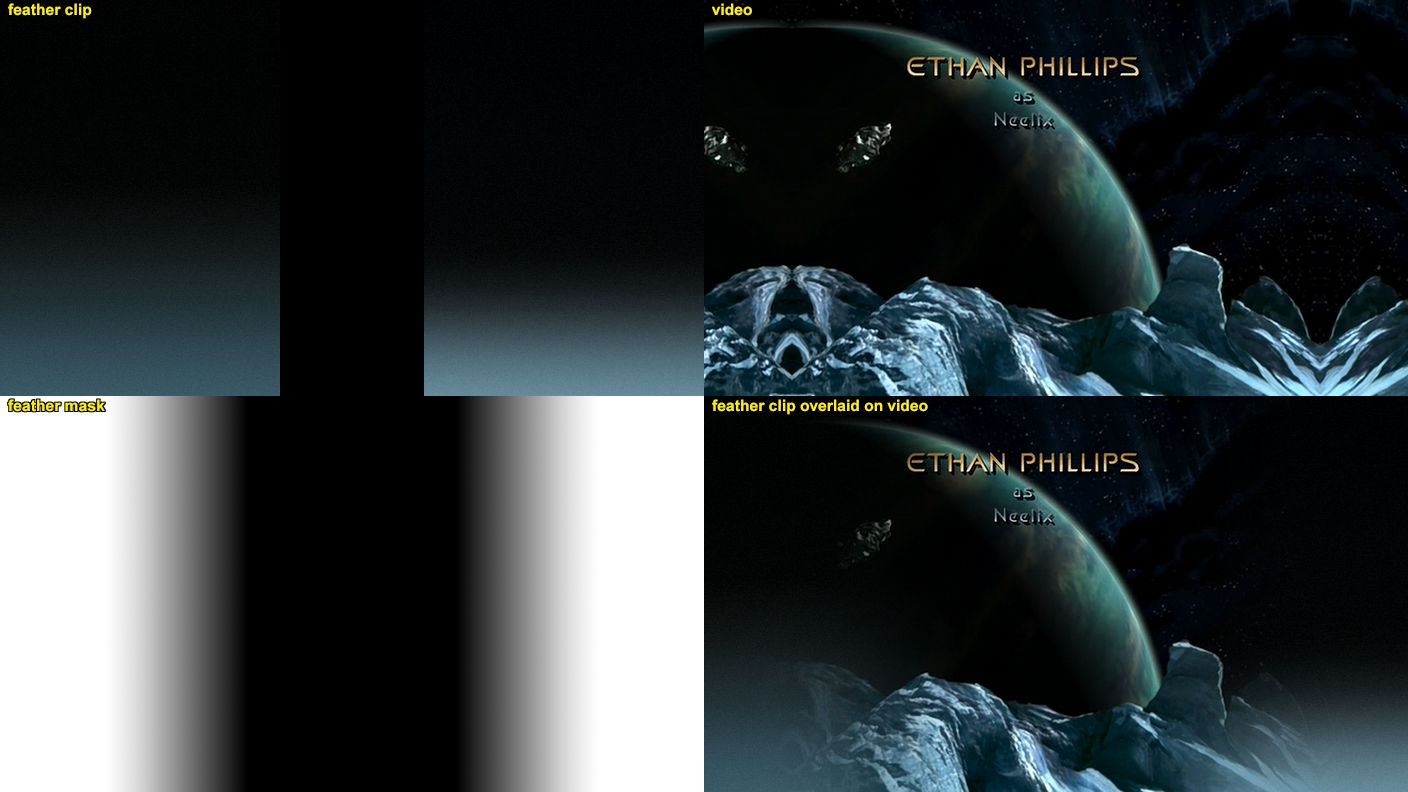

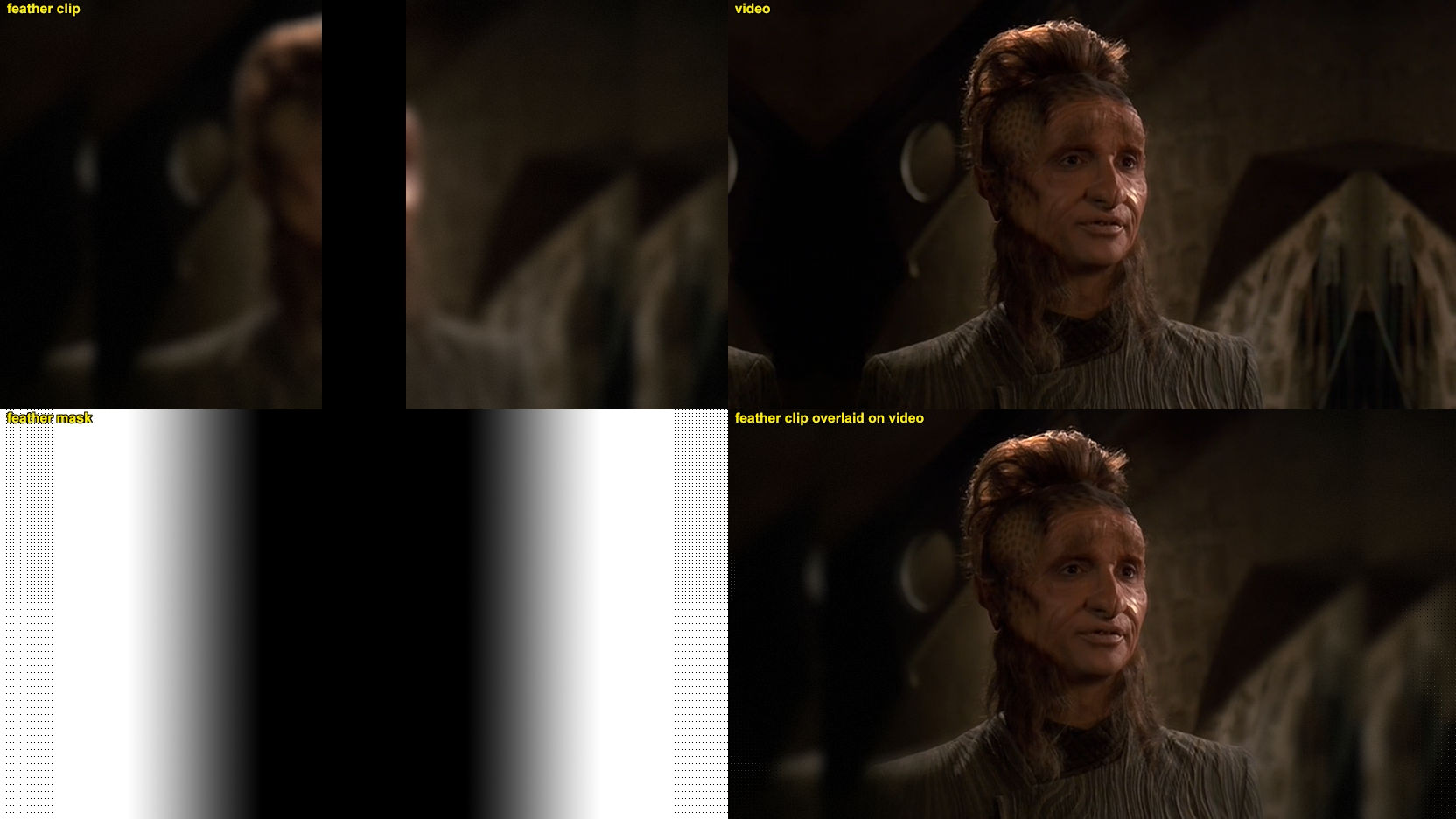

    By the way, if you give a crap, here's how the feathering works now. Bottom right is the final picture. The first is for Clone=1 borders and the second for Clone=2, so you can see why they look different. Clone=3 is feathered the same as Clone=1. The top left picture has backwards borders because that makes it very hard or impossible to see the picture edge under the feathering (sometimes you could see the edge when the borders underneath were black).
    Realistically, the more feathering you use, the more blurring and texture required.... in my opinion. If you have any other ideas though, let me know.
    Clone=1, Feather=32
    Clone=2, Feather=32

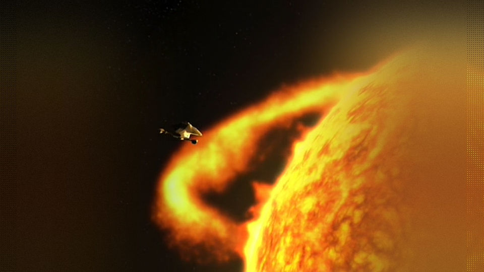

    This is the problem I'm having, which I think relates to another mod8 FastBlur issue when using an old CPU. The resolution didn't seem to matter, just certain values for blurring produce these artefacts.
    Edit: This issue is fixed with FastBlur 0.3.1
    [Attachment 61045 - Click to enlarge]
    Forcing mod8 values for everything involving FastBlur prevents the artefacts, but I'd like to avoid that limitation, so hopefully it's just a problem with old CPUs and large amounts of blurring. I'll test it myself on an old laptop later (newer CPU than the one in this PC), but could you try it for me to see if you have the same problem? The following produces artefacts for me every time. You should see it easily enough in brighter borders if the artefacts are there. Any source should do. The first instance of CropResize will crop it to 4:3 dimensions.
    CropResize(640,480)
    FCropResize(Feather=88)
    CropResize(960,540, Frosty=true)

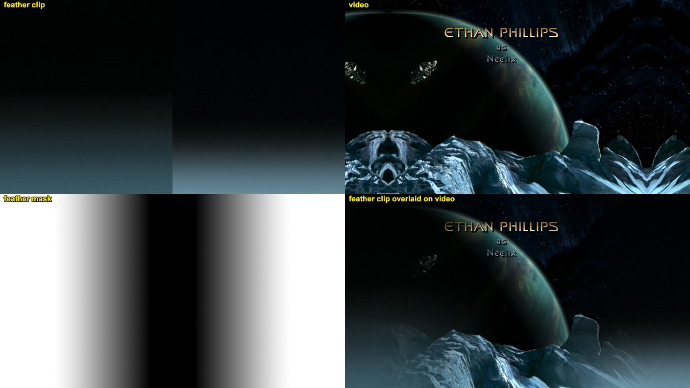

    At the moment, the only restriction for the Feathering argument is a minimum value of 2 and a maximum of 1/6th the video width (or height). Here's the magic formula which seems to work pretty well. I could try making the steps finer but I'm not sure the planets would still line up the same way.
    - The value specified for the Feather argument is multiplied by 3, rounded to mod2 and added to the border size. That becomes the area used for feathering each side (top/left in the pic below).
    - The value specified for the Feather argument is added to the border size and used to create white borders for the mask.
    - Finally, the value specified for the Feather argument is divided by 1.5 and used as the blurring value for FastBlur to blur the mask.

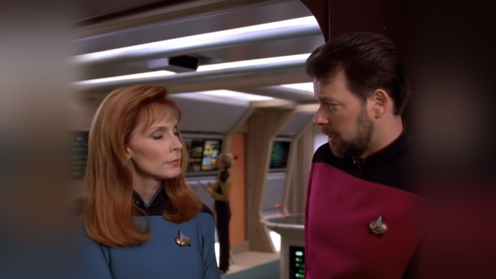

    FCropResize(Clone=1, Feather=64)
    CropResize(704,396, Frosty=true)
    [Attachment 61047 - Click to enlarge]
    That formula seems to work pretty well, but see what you think. The way it is though, even though there's no mod8 limitation now, it means each time the feathering value is increased by 2, the area used for feathering increases by 6 pixels, but hopefully, that's small enough steps.
    And of course once the two feathered sections meet, that's the limit. Feather=88 in this case. There's no error message. The script silently enforces that limit.
    [Attachment 61048 - Click to enlarge]

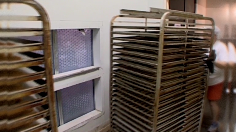

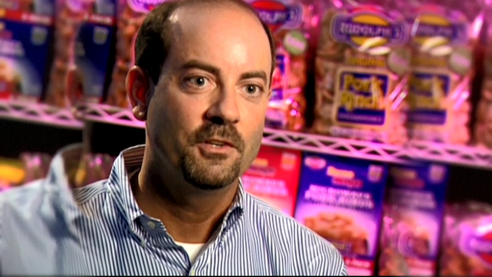

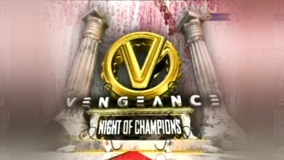

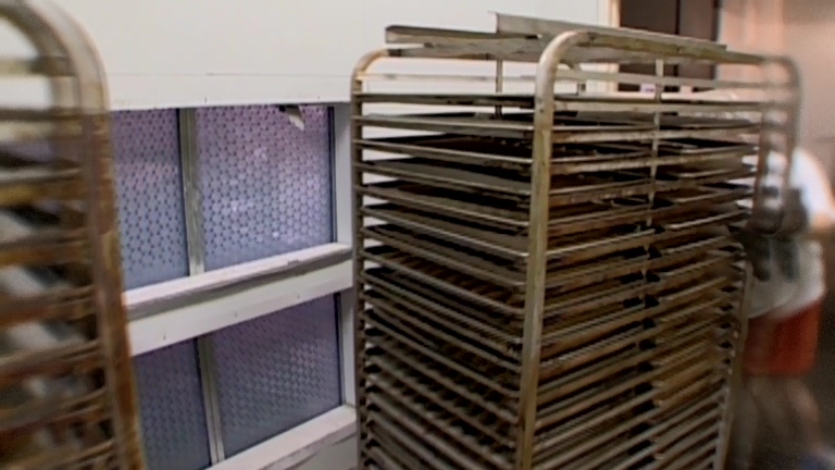

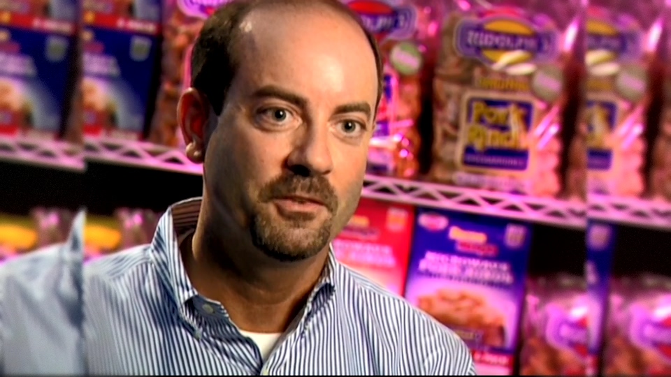

  19. When I tried
    CropResize(640,480)
    I got the same artifacts as you.
    Everything else seems to be functioning as expected, though!
    These are the values I use.
    CropResize(640,480)
    FCropResize(Clone=2, Feather=50, blur=3, vblur=3, texture=5, TSoft=0, blend=0)
    I am starting to warm up to
    CropResize(640,480)
    FCropResize(Clone=2, Feather=50)
    I love how clone=2 looks, its much better than clone=1, IMO, because the boarder between the video and FrostyBoarders are invisible.

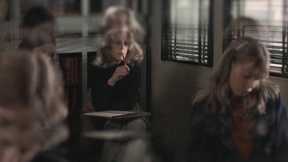

    Quick question about movie sized videos, these are my values for movie files, and I wanted to know if I set it up correctly.
    FCropResize(Clone=2, Feather=40, bright=0, cont=1.0, sat=0.85, TSoft=0, blur=5, vblur=5, texture=8)
    CropResize(960,540, 0, 135, 0, -135, Frosty=true)
Name:	Halloween 1978 35th Anniversary Edition BluRay 1080p TrueHD7.1 x264-D3FiL3R.mkv_20211002_084055..jpg
Name:	Halloween 1978 35th Anniversary Edition BluRay 1080p TrueHD7.1 x264-D3FiL3R.mkv_20211002_084047..jpg
  24. Yeah that's fine. You can use whatever values you prefer.
    I made the original FrostyBorders darker for letterbox borders because I find them more distracting than pillarbox borders, although I rarely add letterbox borders myself. I'd rather crop the sides for 16:9 when the aspect ratio is greater than 16:9.
    I'll confess... Clone=2, Feather=40 would drive me nuts for letterbox borders. I think the "ghosting" effect without lots of blurring and/or texture to hide it would give me motion sickness pretty quickly. I'm not a real fan fan of feathering even for side borders, but that's just me.
    For the remaining arguments, the correct value is the value you prefer.
