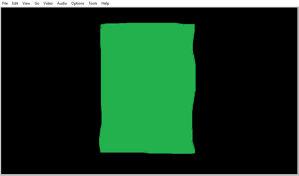

    sorry I have a video clip that is 720x1280 pixel but my screen is 16:9 1920x1080
    can I tell you into avisynth to auto add the correct black borders to the source so that the image appear with the correct aspect ratio, but outputting alwais my target resolution 1920x1080? or is there a plugin for avisynth that auto-pad or add the black borders to a video that don't match a target aspect ratio?
    thanks
  2. AddBorders(320,180,320,180) # left, top, right, bottom
    You can create a function like this to calculate the values automatically:
    function AddBordersToMake(clip v, int width, int height)
       left = ((width - v.width) / 4) * 2
       right = width - (v.width + left)
       top = ((height - v.height) / 4) * 2
       bottom = height - (v.height + top)
       AddBorders(v, left, top, right, bottom)
    Then call it like:
    AddBordersToMake(1920,1080)

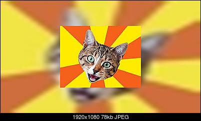

  4. I don't know why you can't figure out simple things like this yourself. Make the blurry image then use Overlay to overlay the original. Something like:
    function FuzzyBackground(clip v, int width, int height)
        background = v.Tweak(sat=0.67).BilinearResize(32,32).Spline36Resize(width,height) # big fuzzy background
        Overlay(background,  v,  x=left, y=top)
    call with:
    FuzzyBackground(1920, 1080)

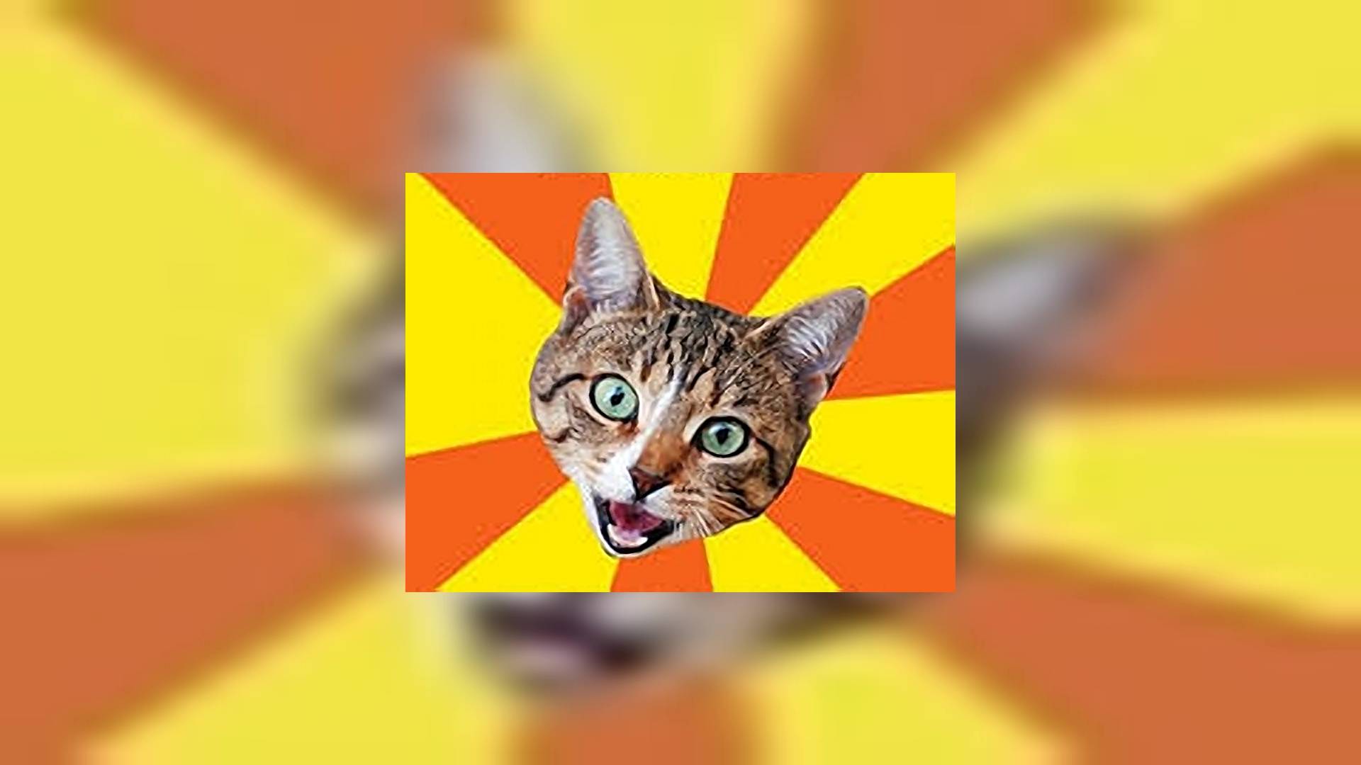

  5. Originally Posted by jagabo View Post
    because I'm a Cat : very low intelligence - big softness
    but please I need a help: in your image Image
    [Attachment 43336 - Click to enlarge]
    the image of the cat results "reframed" inside the screen. For example, I have another source that is 854x480: if I apply the AddBordersToMake(1920,1080) the source image appear as your example: re-framed.
    Is the a way to tell to avisynth that it have to keep the source the largest possible in the screen, while respecting the aspect ratio?
    THANKS THANKS

  7. Originally Posted by marcorocchini View Post
    Of course.

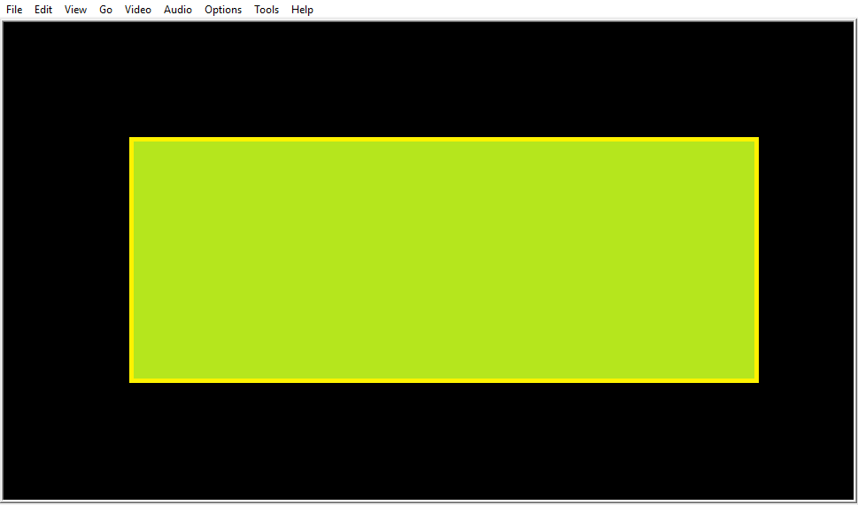

  9. Thankcats but I need to "stretch"and expand the original source when this is < 1920x1080 of widh/hight but alwais keeping the original aspect ratio. And "fill" the "uncovered" with black or mirrored blur same-image as background.
    In the case of a source that is 720x 1280, using AddBordersToMake I get this result very well.
    But, in the case of a source image that is - e.g.- 900x500 or 854x480 or a format that have witdh or height < 1920x1080 I get a result like this
    [Attachment 43349 - Click to enlarge]
    [Attachment 43350 - Click to enlarge]
    so I wonder if there is a way to collate at least one of the two edges between witdh or height to maximize the screen occupied by the source

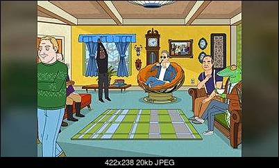

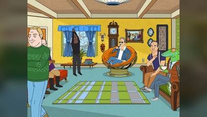

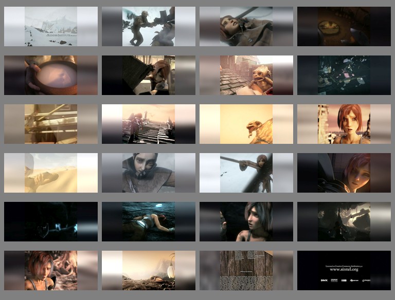

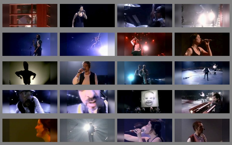

  13. While I was perusing the marcorocchini help forum, it occurred to me a fuzzy background might be an interesting addition to my CropResizeBorder script. I'm in the middle of creating a new version at the moment that should be faster, easier to use, and will do sub-pixel cropping (the current one is limited to mod2 cropping), so for the moment I replaced the current script's ability to add borders with an ability to add a fuzzy background instead (stealing jagabo's method).
    Temporary version of the script: CropResizeBorder Fuzzy.avsi
    jagabo's FuzzyBackground function is at the very end of the script if you want to tweak the brightness or colour etc.
    Either of these methods will give you a 1280x720 resolution while adding a fuzzy background instead of borders as required (you can resize to whatever resolution you like).
    CropResizeBorder(1280, 720, Cmode="RB")
    or
    CRB(1280, 720)
    Using a 4:3 image as an example:

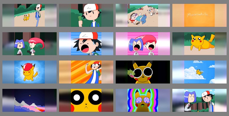

  16. I generally don't like coloured borders either, so I tried to make them less offensive.
    This version only uses a few pixels to create the borders, but not the edge ones, because that seems to suck, but close to the edge, and the borders are more washed out. If I had to have coloured borders, something like this would be better. It's easy enough to adjust the brightness and contrast in the functions at the end of the script (there's two of them now).
    CropResizeBorder_LessFuzzy.avsi

    ST_B2 = """CRB (OutWidth=?, OutHeight=?, Cmode="RB")"""
    ST_C2 = """PicDAR adjusts the cropping & display aspect ratio of the picture itself.\nBorders are added to the sides or top / bottom according to the specified OutWidth & OutHeight.\nTherefore, OutWidth & OutHeight determine the overall resolution\nand cropping / PicDAR determine the picture resolution."""
    ST_A3 = """Crop & Resize Width Only"""
    ST_B3 = """CRB (Cmode="RW")"""
    ST_C3 = """This mode is intended to ensure only the width is resized for anamorphic sources,\nalthough for non-anamorphic sources it will only crop and resizing is disabled.\nFor anamorphic sources, the height is cropped to the specified mod,\nthe width is resized for square pixel dimensions, then the width is also cropped.\nNon-anamorphic sources are simply cropped (same as Cmode="NR")."""
    ST_A4 = """No Resizing, Cropping Only"""
    ST_B4 = """CRB (Cmode="NR")"""
    ST_C4 = """Resizing is disabled so the pixel aspect ratio is unchanged.\nPicDAR adjusts the cropping & display aspect ratio of the picture itself.\nMod overcrops as required for final picture width & height.\nOutWidth & OutHeight have no effect."""
    ST_A5 = """Clean Up Borders (No Resizing)"""
    ST_B5 = """CRB (Cmode="B")"""
    ST_C5 = """Borders are cropped and always added back for the original resolution\n(for both anamorphic and non-anamorphic sources).\nResizing is disabled so the pixel aspect ratio is unchanged.\nMod / PicDAR adjusts the cropping as required for final picture width & height.\nOutWidth & OutHeight have no effect."""
    ST_Dw = """Width = """ + string(width(AddingBorders)) + \
    """, Left Border = """ + string(Left_Border) + """, Right Border = """ + string(Right_Border)
    ST_Dh = """Height = """ + string(height(AddingBorders)) + \
    """, Top Border = """ + string(Top_Border) + """, Bottom Border = """ + string(Bottom_Border)
    ST_Ew = """Picture Width = """ + string(New_Picture_Width)
    ST_Eh = """Picture Height = """ + string(New_Picture_Height)
    ST_F = string(Final_MC_Resized_Width) + """ x """ + string(MC_Height)
    ST_G = string(Final_HMC_Resized_Width) + """ x """ + string(HMC_Height)
    ST_H = string(Total_Width) + """ x """ + string(Total_Height)
    ST_I = string(Final_Source_Resized_Width) + """ x """ + string(Source_Height)
    st01 = """Resolution set by cropping & PicDAR"""
    st02 = """Resolution set by cropping"""
    ST_J01 = (PicDAR > 0) ? st01 : st02
    st03 = """Cropped Height x PicDAR = Width"""
    st04 = """Cropped Height x Cropped DAR = Width"""
    ST_J02 = (PicDAR > 0) ? st03 : st04
    st05 = """OutHeight x PicDAR = Width"""
    st06 = """OutHeight x Cropped DAR = Width"""
    ST_J03 = (PicDAR > 0) ? st05 : st06
    st07 = """OutWidth x PicDAR = Height"""
    st08 = """OutWidth x Cropped DAR = Height"""
    ST_J04 = (PicDAR > 0) ? st07 : st08
    ST_J05 = (Source_Pixel_Aspect_Ratio == 1) && (OutWidth == 0) && (OutHeight == 0) ? ST_J01 : \
    (OutWidth == 0) && (OutHeight == 0) ? ST_J02 : \
    (OutWidth == 0) && (OutHeight > 0) ? ST_J03 : \
    ST_J04
    st09 = """OutHeight x PicDAR = Width + Borders"""
    st10 = """OutHeight x Cropped DAR = Width + Borders"""
    ST_J06 = (PicDAR > 0) ? st09 : st10
    st11 = """OutWidth x PicDAR = Height + Borders"""
    st12 = """OutWidth x Cropped DAR = Height + Borders"""
    ST_J07 = (PicDAR > 0) ? st11 : st12
    ST_J08 = (Source_Pixel_Aspect_Ratio == 1) && (OutWidth == 0) && (OutHeight == 0) ? ST_J01 : \
    (OutWidth > 0) && (OutHeight == 0) ? (ST_J04) : \
    (Output_Storage_Aspect_Ratio >= Final_Picture_Aspect_Ratio) ? ST_J06 : \
    ST_J07
    st13 = """Anamorphic Display Size\n(set by cropping & PicDAR)\n""" + ST_F
    st14 = """Anamorphic Display Size\n(set by cropping)\n""" + ST_F
    ST_J09 = (PicDAR > 0) ? st13 : st14
    st15 = """Anamorphic Picture Display Size\n(set by cropping & PicDAR)\n""" + ST_F
    st16 = """Anamorphic Picture Display Size\n(set by cropping)\n""" + ST_F
    ST_J10 = (PicDAR > 0) ? st15 : st16
    ST_K = """Total Resolution\n""" + ST_H
    ST_L = """Total Display Size (including borders)\n""" + ST_I
    ST_M = """Both OutWidth & OutHeight must be greater than zero to add borders."""
    ST_N = """OutWidth & OutHeight have no effect\nPicDAR adjusts the cropping and therefore the output resolution"""
    Subtitle_ColourA = (Final_Cropping_Resizing == Cropping_Resizing1w) || (Final_Cropping_Resizing == Cropping_Resizing4w) ? (color_paleturquoise) : (color_aquamarine)
    Subtitle_ColourB = (Final_Cropping_Resizing == Cropping_Resizing1w) || (Final_Cropping_Resizing == Cropping_Resizing4w) || (Final_Cropping_Resizing == Mod_Cropped) ? (color_aquamarine) : (color_paleturquoise)
    Subtitle_ColourC = (Subtitle_ColourA == color_paleturquoise) || (Subtitle_ColourB == color_paleturquoise) ? (color_paleturquoise) : (color_aquamarine)
    Fsize1 = (Total_Width / 39)
    Fsize2 = (Total_Width / 45)
    Fsize3 = (Total_Width / 49)
    Fsize4 = (Total_Width / 52)
    Fsize5 = (width(Final_Cropped_Video) / 49)
    Float_Total_Width = float(Total_Width)
    Y01 = round(Float_Total_Width / 38.0)
    Y02 = round(Float_Total_Width / 20.5)
    Y03 = round(Float_Total_Width / 14.2)
    Y04 = round(Float_Total_Width / 5.15)
    Y05 = round(Float_Total_Width / 4.55)
    Y06 = round(Float_Total_Width / 3.9)
    Y07 = round(Float_Total_Width / 3.55)
    Y08 = round(Float_Total_Width / 3.2)
    Y09 = round(Float_Total_Width / 2.78)
    Y10 = round(Float_Total_Width / 2.6)
    Cpreview1_Info = \
    (Final_Cropped_Video == Height_Mod_Cropped) ? \
    Final_Cropped_Video\
    .subtitle("""When OutWidth & OutHeight are zero (or unspecified) and the source is anamorphic and\nbeing resized to square pixels, the height is cropped before the width is resized, then\nthe width is resized and cropped to the specified mod (the source is cropped twice).\nThis ensures width and height conform to the specified mod and the height is not resized.\n\nThe cropping preview is the cropping before the width is resized, therefore\nsome additional picture "may" be cropped from the width after it's resized.""", lsp=10, x=-1, y=Y05, size=Fsize5, text_color=color_white) : \
    Final_Cropped_Video
    Cpreview2_Info = \
    [* Crop & Resize *] \
    (Cmode == """R""") ? \
    (Final_Output\
    .subtitle(ST_A1, x=-1, y=Y01, size=Fsize2, text_color=color_aquamarine)\
    .subtitle(ST_B1, x=-1, y=Y02, size=Fsize4)\
    .subtitle(ST_C1, lsp=10, x=-1, y=Y03, size=Fsize4, text_color=color_azure)\
    .subtitle(ST_Ew, x=-1, y=Y06, size=Fsize1, text_color=Subtitle_ColourA)\
    .subtitle(ST_Eh, x=-1, y=Y07, size=Fsize1, text_color=Subtitle_ColourB)\
    .subtitle(ST_J05, x=-1, y=Y09, size=Fsize2, text_color=Subtitle_ColourC)) : \
    [* Crop & Resize & Add Borders - Without Borders *] \
    (Cmode == """RB""") && (Total_Picture_Aspect_Ratio == New_Picture_Aspect_Ratio) ? \
    (Final_Output\
    .subtitle(ST_A2, x=-1, y=Y01, size=Fsize2, text_color=color_aquamarine)\
    .subtitle(ST_B2, x=-1, y=Y02, size=Fsize4)\
    .subtitle(ST_C2, lsp=10, x=-1, y=Y03, size=Fsize4, text_color=color_azure)\
    .subtitle(ST_J08, x=-1, y=Y09, size=Fsize2, text_color=Subtitle_ColourC)\
    .subtitle(ST_M, lsp=10, x=-1, y=Y10, size=Fsize4, text_color=color_azure)) : \
    [* Crop & Resize & Add Borders - With Borders *] \
    (Cmode == """RB""") ? \
    (Final_Output\
    .subtitle(ST_Dw, x=-1, y=Y04, size=Fsize3)\
    .subtitle(ST_Dh, x=-1, y=Y05, size=Fsize3)\
    .subtitle(ST_K, lsp=10, x=-1, y=Y08, size=Fsize2)\
    .subtitle(ST_J08, x=-1, y=Y09, size=Fsize2, text_color=Subtitle_ColourC)) : \
    [* Crop & Resize Width Only *] \
    (Cmode == """RW""") && (Source_Pixel_Aspect_Ratio == 1) ? \
    (Final_Output\
    .subtitle(ST_A3, x=-1, y=Y01, size=Fsize2, text_color=color_aquamarine)\
    .subtitle(ST_B3, x=-1, y=Y02, size=Fsize4)\
    .subtitle(ST_C3, lsp=10, x=-1, y=Y03, size=Fsize4, text_color=color_azure)\
    .subtitle(ST_Ew, x=-1, y=Y06, size=Fsize1, text_color=color_aquamarine)\
    .subtitle(ST_Eh, x=-1, y=Y07, size=Fsize1, text_color=color_aquamarine)\
    .subtitle(ST_J08, x=-1, y=Y09, size=Fsize2, text_color=color_aquamarine)\
    .subtitle(ST_N, lsp=10, x=-1, y=Y10, size=Fsize4, text_color=color_azure)) : \
    [* Crop & Resize Width Only - Anamorphic Source *] \
    (Cmode == """RW""") ? \
    (Final_Output\
    .subtitle(ST_Eh, x=-1, y=Y07, size=Fsize1, text_color=color_paleturquoise)\
    .subtitle(ST_J01, x=-1, y=Y09, size=Fsize2, text_color=color_paleturquoise)\
    [* No Resizing, Cropping Only *] \
    (Cmode == """NR""") && (Source_Pixel_Aspect_Ratio == 1) ? \
    (Final_Output\
    .subtitle(ST_A4, x=-1, y=Y01, size=Fsize2, text_color=color_aquamarine)\
    .subtitle(ST_B4, x=-1, y=Y02, size=Fsize4)\
    .subtitle(ST_C4, lsp=10, x=-1, y=Y03, size=Fsize4, text_color=color_azure)\
    .subtitle(ST_J01, x=-1, y=Y09, size=Fsize2, text_color=color_aquamarine)) : \
    [* No Resizing, Cropping Only - Anamorphic Source *] \
    (Cmode == """NR""") ? \
    (Final_Output\
    .subtitle(ST_J09, lsp=10, x=-1, y=Y09, size=Fsize2, text_color=color_aquamarine)) : \
    [* Clean Up Borders (No Resizing) *] \
    (Cmode == """B""") && (Source_Pixel_Aspect_Ratio == 1) ? \
    (Final_Output\
    .subtitle(ST_A5, x=-1, y=Y01, size=Fsize2, text_color=color_aquamarine)\
    .subtitle(ST_B5, x=-1, y=Y02, size=Fsize4)\
    .subtitle(ST_C5, lsp=10, x=-1, y=Y03, size=Fsize4, text_color=color_azure)\
    .subtitle(ST_J01, x=-1, y=Y09, size=Fsize2, text_color=color_aquamarine)\
    .subtitle(ST_K, lsp=10, x=-1, y=Y10, size=Fsize2)) : \
    [* Clean Up Borders (No Resizing) - Anamorphic Source *] \
    (Cmode == """B""") ? \
    (Final_Output\
    .subtitle(ST_J10, lsp=10, x=-1, y=Y08, size=Fsize2, text_color=color_aquamarine)\
    .subtitle(ST_L, lsp=10, x=-1, y=Y10, size=Fsize2)) : \
    nop
    Video_Out = \
    (Cpreview == 1) ? (Cpreview1_Info) : \
    (Cpreview == 2) ? (Cpreview2_Info) : \
    (Final_Output)
    return Video_Out
    # ========== IsReallyFloatCRB Helper Function =============================================
    function CropResizeBorder_IsReallyFloat(val v)
        s = ""
        try {
            s = Hex(v) [* fails on float arguments! *]
        catch(err_msg) {
            s = "true"
        return (IsFloat(v))
        \ ? (s=="true") [* s<>"true" if Hex succeeds *]
        \ : false       [* eliminate clips, strings, booleans  *]
    # ========== FuzzyBackground Helper Function =============================================
    function CropResizeBorder_FuzzyBackground1(clip v, int "Total_Width", int "Total_Height")
        Background1 = v.crop(0, 32, 0, -(v.height-64))
        Background2 = v.crop(0, (v.height-64), 0, -32)
        Background3 = StackVertical(Background1, Background2)
        Background4 = \
        Background3.Tweak(sat=0.33, bright=75, Cont=0.1).\
        BilinearResize(32,32).BilinearResize(Total_Width, Total_Height).\
        Blur(1,1).Blur(1,0).Blur(1,0)
        Left = ((Total_Width - v.width) / 4) * 2
        Top = ((Total_Height - v.height) / 4) * 2
        Overlay(Background4, v, x=Left, y=Top)
    function CropResizeBorder_FuzzyBackground2(clip v, int "Total_Width", int "Total_Height")
        Background1 = v.crop(32, 0, -(v.width-64), 0)
        Background2 = v.crop((v.width-64), 0, -32, 0)
        Background3 = StackHorizontal(Background1, Background2)
        Background4 = \
        Blur(1,1).Blur(0,1).Blur(0,1)
    thank you cat, probably I need some month to try this but usefull ^^
  18. Or a dark fuzzy reflection?
  19. Originally Posted by marcorocchini View Post
    The basics are in fact very simple. The idea is you can resize any video to any dimensions but instead of distorting the picture if the source/resize aspect ratios are different, the script automatically crops picture as required to make them the same. Specifying resizing and cropping is much the same as if you were using an Avisynth resizer. The included wrapper functions are effectively shortcuts for enabling options.
    This resizes to a width of 1280 while cropping 12 pixels from the top and bottom. The script automatically calculates the correct height.
    CR(1280, 0, 0, 12, 0, 12)
    The following would crop 10 pixels from each side and 50 from the height, then resize to 1280x720, but if the image isn't 16:9 after cropping (because 1280x720 is 16:9), the script will automatically crop it to 16:9 before resizing.
    CR(1280, 720, 10, 25, 10, 25)
    The following does much the same thing, except instead of cropping away picture in order to resize to 16:9 it'll add borders instead (which is what you asked about in your opening post).
    CRB(1280, 720, 10, 25, 10, 25)
    The CRA() and CRBA() functions are the same as above except they also auto-crop any black bars with autocrop.dll.
    The above functions are 99.9% of what I use the script for.
    I've been working on the new version sporadically and I'm close to finishing it. I can't imagine why I didn't think of creating a script like this years ago instead of a few months ago as it can be very tedious having to calculate and adjust cropping/resizing for every encode. The script still gives you as much control as you want over the output but you don't have to do the maths.
  20. jagabo, is there a plugin for applying changes to colour/brightness/stretch etc to a picture in a non uniform way? There's a word I'm looking for, but a description might be (for example) progressively darkening the image from the edges towards the centre.
    I ask, because my interest in creating borders that aren't completely black comes from owning a Plasma, but some sort of "3d depth effect" would probably make them more bearable. I saw quite a good example of it on a DVD a while back but I can remember what DVD it was at the moment. And the word I'm looking for.... I think I'm having a dumb day.
  21. Originally Posted by hello_hello View Post
    For color/brightness - one way is with a gradient mask, with mt_merge or overlay
    But I'm guessing you want to use a procedural method , ideally without some pre-made physical mask or gradient file ?
    For stretch/resize, there is a non uniform resize function that was part of some plugin. But I can't recall the plugin...offhand. I'll have to look
    EDIT: it was warpedresize, part of simpleresize
    http://avisynth.nl/index.php/SimpleResize

  24. Here's another one. I've only tried it on a few videos so far, but it seems to be sufficiently unobtrusive
    and not-unpleasant to look at (when not really looked at, if you know what I mean).
    I've added fixed noise and temporal softening to the mix.
    [Attachment 43381 - Click to enlarge]
    https://youtu.be/pvrjKZWFCmM
    (2 min preview) (updated)

    EDIT added cross-blending for symmetry per hello_hello's suggestion below, and other minor changes
    Last edited by raffriff42; 21st Oct 2017 at 07:47. Reason: script version 2.4 (revert from 2.5)

  26. Thanks hello_hello. I dunno, with what I've seen so far, I think the asymmetry actually helps.
    In this concert footage, one side of the screen is often brighter than the other:
    [Attachment 43389 - Click to enlarge]
    I've been watching a variety of things with it (live - no re-encoding), and it actually enhances the experience way more than it distracts.
    EDIT oh you want anime?
    [Attachment 43390 - Click to enlarge]

  27. I haven't played with it much yet, but I'm still leaning towards symmetry.
    They're still not completely symmetric, which I assume has something to do with the temporal softening and one side being offset a little, or something obvious I'm missing (I haven't had a close look at the script yet) and that's probably a good thing, but I did try sticking the following in between the "extract left and right edges" and "stretch" sections of the script. Just to see. Maybe they could be blended slightly unevenly as a compromise.
    L=overlay(L, R, opacity = 0.5)
    R=overlay(L, R, opacity = 0.5).FlipHorizontal()
    Without and with screenshots below. I haven't tried watching a video with the borders either way yet.

  29. hello_hello, I'm coming around to your point of view. I added in a cross-blending argument to the script above.
    And now below, blurred borders for all 4 sides; it looks like post #4 but with added (optional) temporal blur & fixed pattern noise, as in the first script. It does not look as good as the first one (in my opinion) for the case of side borders only. BTW I'm growing less fond of temporal blur, depending on the source, but the noise is needed: without fixed pattern noise, heavy blurring has really nasty banding problems at times.
    ### add soft borders
