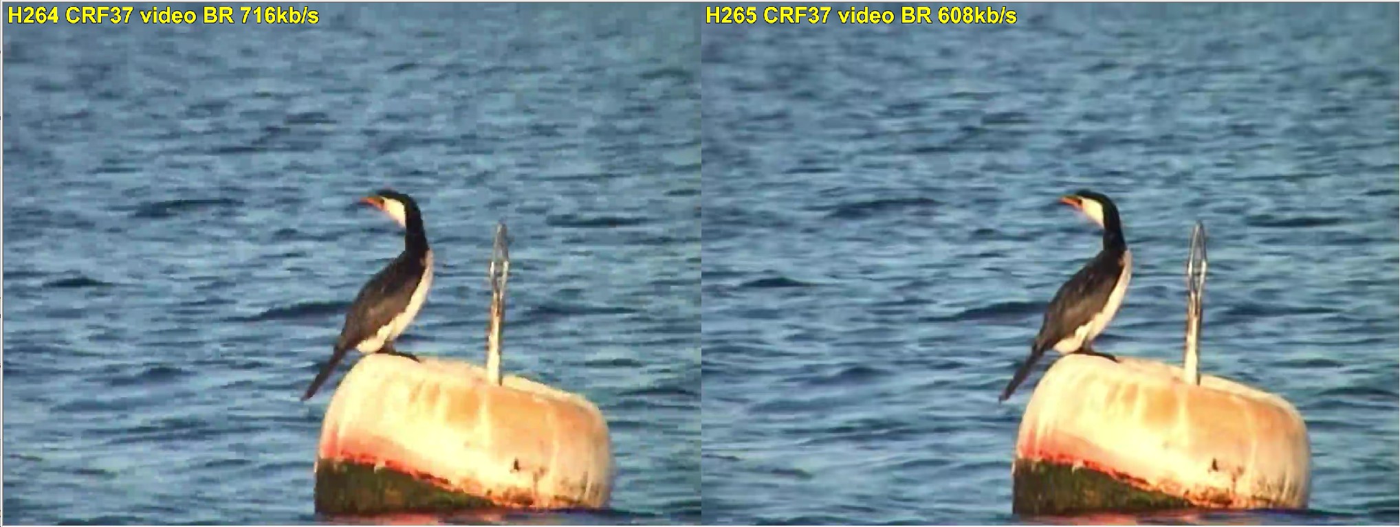

    Comparison between H264 and H265 at CRF 37 using Handbrake:
    [Attachment 92439 - Click to enlarge]
