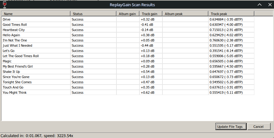

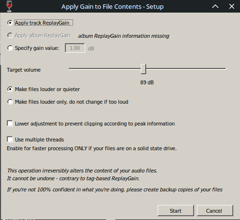

foobar2000 can scan tracks using the EBU R128 scanning method and save the over-all volume in tags. It works the same way as the ReplayGain spec, only the EBU R128 scanning method is a little more accurate than the original ReplayGain algorithm. By default (I think) foobar2000 will adjust the volume on playback according to the volume info in the tags after you've scanned the tracks and saved the tags (an entire track is simply adjusted up or down in volume), so you could scan a bunch of tracks, save the ReplayGain data, and see what you think of the playback result before you convert and/or compress the audio itself, assuming you need to. The ReplayGain data can also be saved in SoundCheck tags for Apple devices to read, and foobar2000 can also use the ReplayGain info to physically adjust the volume of MP3 and AAC audio without re-encoding, or it can use the volume info to adjust the volume while converting. The default ReplayGain volume is -18 dB or -18 LUFS, whereas its -23 LUFS (I think) for the official EBU R128 standard and -16 LUFS for SoundCheck.

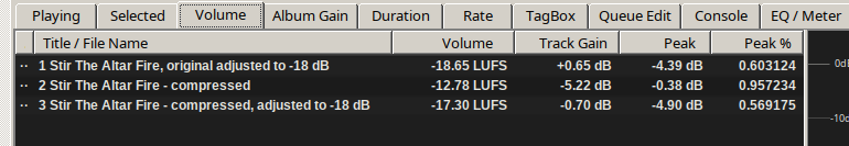

It's not the latest version, but I uploaded a portable version of foobar2000 a here while back. It has playlist columns for displaying the track volume after a ReplayGain scan (foobar2000 doesn't have them by default, and they're not necessary for ReplayGain to work, but I like to be able to see the volume info easily). It looks something like the screenshot below (the tracks being displayed below were physically adjusted to roughly -18 LUFS, hence the volumes being displayed are all close to that).

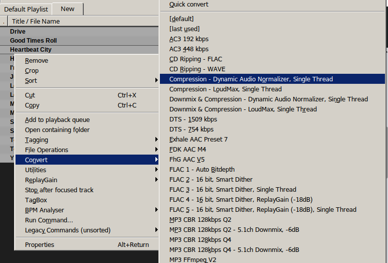

PS. If you still want to compress the tracks (although hopefully you wont need to), you can compress them with Dynaudnorm, scan the compressed versions, save the volume info, then re-encode them while adjusting them to the same volume. The version of foobar2000 I linked to should have converter presets for compressing with Dynaudnorm, but unfortunately it's a 2 step process if you want to adjust the tracks to the same volume after they've been compressed.Last edited by hello_hello; 26th Jul 2025 at 10:09.
