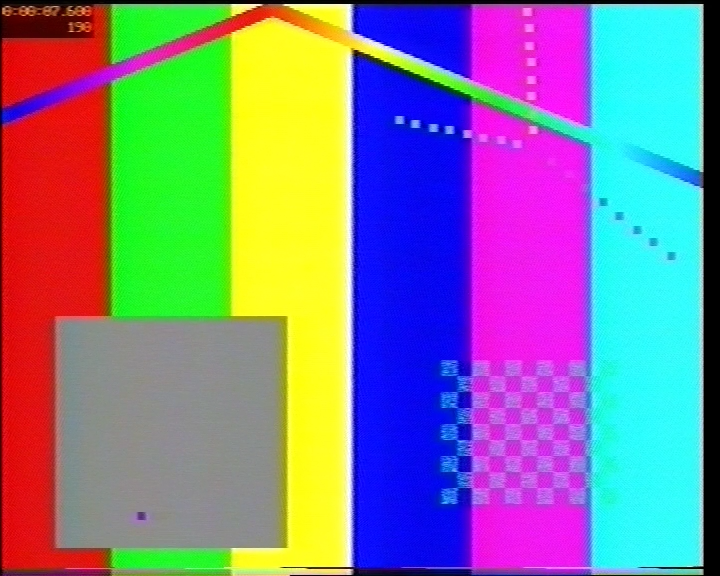

    Just wondering if anyone knows what settings should be used for the capture filter for this card. I wanted it as raw as possible in VDUB.
    I have made a small capture with the sharpness at 128 (middle ground) and instead of being neither sharpening or softening the image, I felt like it added too much sharpness to it. To add extra confusion, the default is 16 (out of 256).
    Has anyone examined these settings to see if there's an optimum to make them as raw as possible?

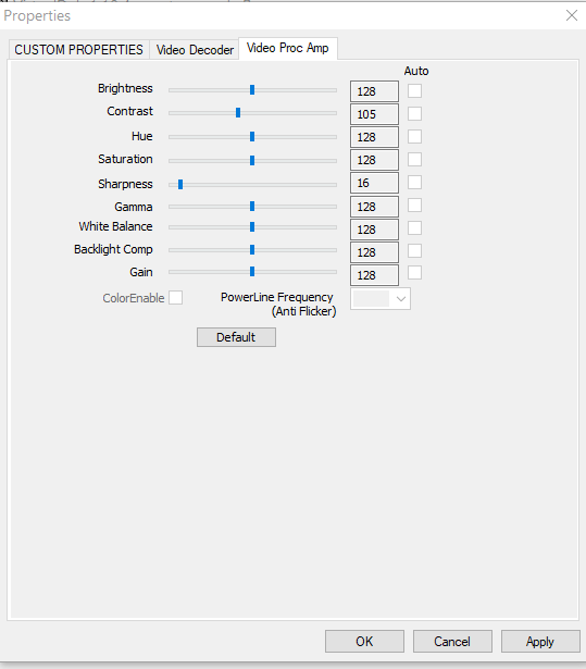

    Image attached.
    [Attachment 91165 - Click to enlarge]
  2. My "standard" settings:
    Brightness: 128
    Contrast: 90....100
    Sharpness: 0 or leave at default 16.
    For brightness and contrast settings use the histogram. Depends on your setup.

    I did some tests at 16, 64 and 128 sharpness, and all I really noticed was that at 128 sharpness, the bitrate went through the roof, presumably from all the noise that got amplified.

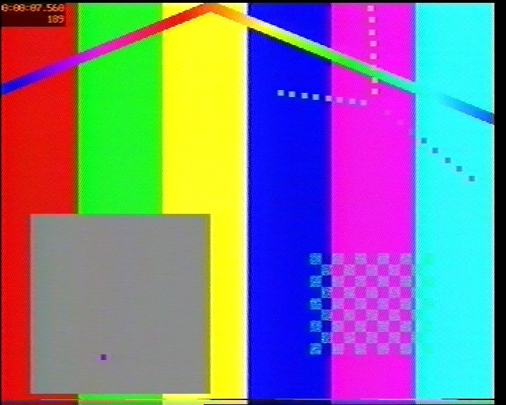

    Originally Posted by lollo View Post
    Oh thanks so much for this! I did actually search the forum for a test similar to this and couldn't find anything.
    I've actually done tests at 16, 64 and 128 sharpness. Unfortunatly this was done on a crappy VCR I just happen to have wired up and the only VHS was one with a test tape on it. I'll post them though in case anyone wants to comment, but it might be a bit futile.
    (Also just noticed that the 16 one is not the same frame, but should still give an idea).
    16:
    [Attachment 91169 - Click to enlarge]
    64:
    [Attachment 91170 - Click to enlarge]
    128:
    [Attachment 91171 - Click to enlarge]

    I'd leave it at default. "Middle" is not best, for example, the contrast on 105 is better than "in the middle" of 128. The default values have been chosen by IOData for a reason so there's probably a good argument for leaving them there for the Sharpness, at least. Brightness and Contrast are very different kettles of fish, where each tape may need adjustments.
    Using Imgsli, you can see the difference between 64 and 128. 16 and 64 are much closer:
    https://imgsli.com/NDQ5NzU0/1/2

    Thanks Sharc for the driver number!
    Thanks for that comparison Alwyn!
    I notice looking at the difference between 16 and 64 in that comparison, that certain parts that naturally blur together, have their pixels flug hard in one direction at 64. Like if you have a slow gradient, the pixel colour slowly changes, but at 64, you suddenly get pixels beside each other that are complete opposites and you lose the slow change in colour you'd expect. To me, this is an additional sharpness being added.
    Long story short, I'll stick with 16!

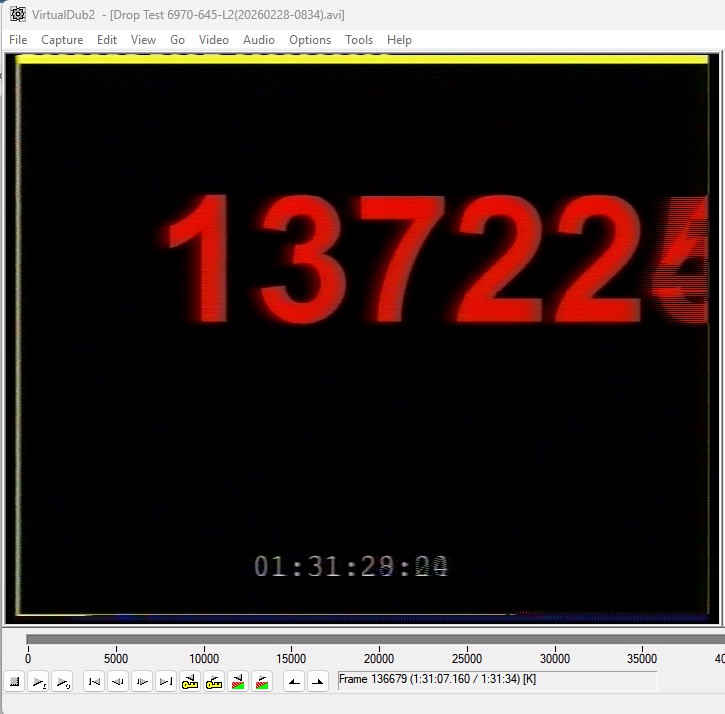

    Originally Posted by RGR
    AmarecTV is mediocre at best, mainly because of the constant dropped frames in every configuration.
    No it doesn't. I just did another test, different config to last time, and over 90 minutes, AmarecTV did not drop or insert one frame. You need to stop making grandiose, sweeping statements that are incorrect. Probably a reinstall of Windows might help you because you obviously have a messed-up capture system or workflow.
  24. These days dropping / inserting of frames depends mainly on the condition of the tape and the condition of the VCR, IMO. Watch the analog signal delivered to the capture card with an oscilloscope (line sync pulses, field/fame sync pattern) and be surprised how ugly these can look and imagine how a capture card would handle these ....
    In the past the hardware architecture of the PC often presented a bottleneck (video/audio clocking architecture, bus arbitration, mass storage writing speed, desktop PC vs notebook, etc) even when the CPU load appeared to be low. Vdub has settings to handle legacy audio/video PC architectures - which may unfortunately have an adverse effect on todays systems, especially if these many Vdub settings applied incorrectly.
    There is little reason these days why frames (fields) should be dropped / inserted provided that the tape and VCR are in good condition. Performance comparisons would be more meaningful with mediocre/poor tapes. A comparison should also include the details and trustful indications of the capture tool's report (log).
    Bottom line: Draw your own conclusions, valid for your actual case.
    But you haven't actually tested anything...
    I tested both AmarecTV and VirtualDub in many possible combinations -- and only VirtualDub was reliable (certainly more reliable than AmarecTV).
    AmarecTV, of course, reported 0 dropped frames, but unlike you, I had counted those frames and I know that in every case AmarecTV was simply wrong.
    My reference point isn't the logs, but the source. I'm digitizing the analog source, not the logs...
    https://forum.videohelp.com/threads/416658-Nero-Video-Grabber-vs-Hauppauge-WinTV-USBli...00#post2765023
    Explain this then. The first frame of the capture is 545.
    [Attachment 91380 - Click to enlarge]
    It is pointless linking us to your old posts. They prove nothing.
