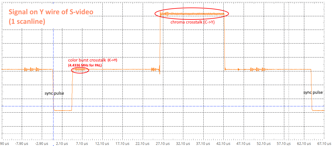

  9. Low quality Scart->S-video adaptors and poorly screened cables produce crosstalk between C and Y and may cause crawling ants/checkerboard patterns, similar to Composite dot crawl.
    Tests made with a mediocre quality adapter/cable showing the chroma -> luma crosstalk, for example.

    Yes, in principle the Y/C signals available on S-Video and SCART are the same but:
    - inside the machines less care is given to the routing of the signals to SCART connector
    - the SCART connectors in the devices are lower quality then the S-Video connectors
    - the SCART cables are lower in quality (i.e Monster Cable "Monster Video 3" S-Video versus any of the Monster Cable SCART to S-Video)
    - any other reason related to the manufacturers being considering (unfortunately) SCART a low end connector, while in fact it also vehicles RGB and could be the best.

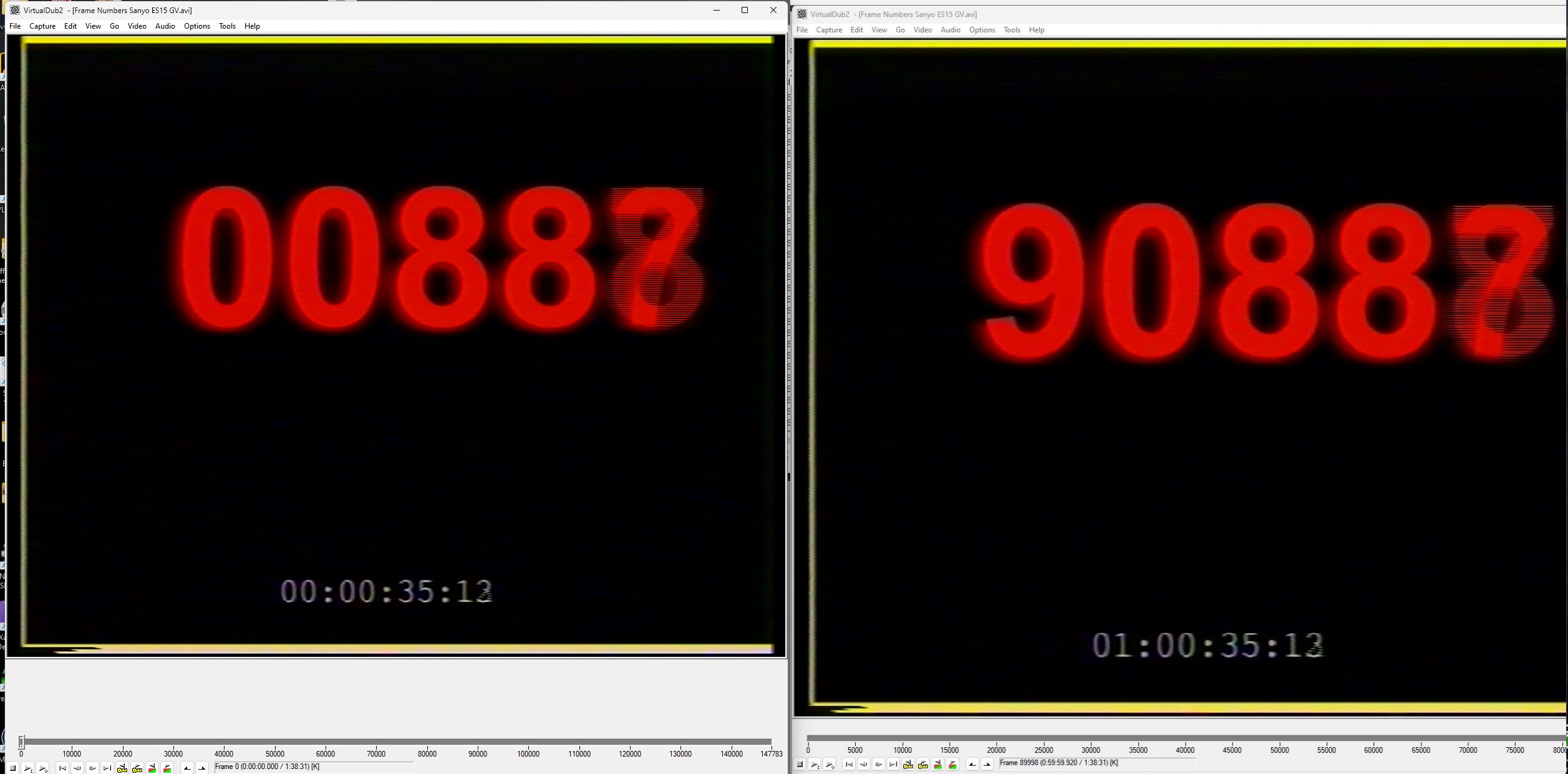

    Round 2 - drops/inserts and sync - capturing 1h tape.
    Part 1 - TBC off -- Philips VR1100 (JVC HR-S7700 clone), edit/distinct mode, BEST on --> stick (S-Video) --> AmarecTV 3.10

    No process -- I simply loaded a file generated by AmarecTV or Vdub into VDub (+deinterlace if necessary).
    Maybe AmarecTV doesn't report drops (it doesn't report me -- 0 drops), but it drops a lot of frames, most in the test.
    The test procedure is described above, you can also see the screenshots -- these are 180000 numbered frames recorded on a VHS tape. It was enough to set the dump to a frame with a counter of 0 and move forward 180,000 frames (I checked every few to a dozen thousand). Then you can see that AmarecvTV's reports have nothing to do with reality.

    Originally Posted by aramkolt View Post
    The idea is that each frame gets its own number visually burned in and the LTC audio decryption in a linear editor can be compared to the "realtime" time code.
    Yes, I have over 180,000 frames, each numbered. The video-audio sync test is at the beginning and at the end (after 1h). In the middle I have a couple of test clips to compare video quality, but that's later -- for now I'm just gathering material.
