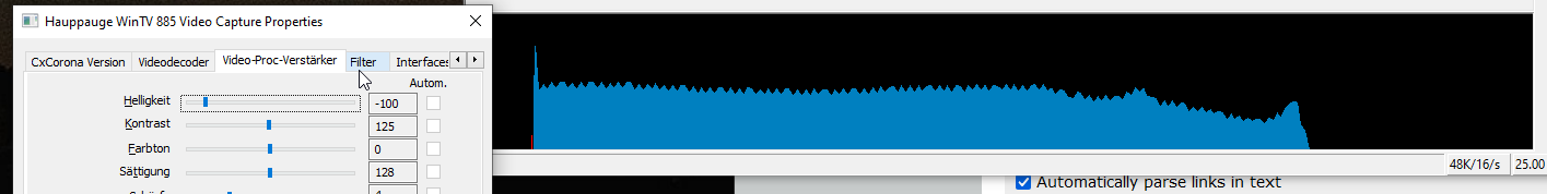

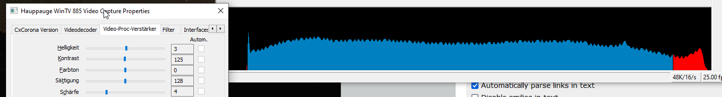

  2. Originally Posted by Alwyn View Post
    Set your brightness and contrast correctly using the VDub histogram, as per my guide here.
    Hey Alwyn,
    so I used the method as per your guide. Changing contrast has the exact effect that you specified - however, changing brightness never really changes anything on the left hand side "no go zone" (see screenshots). The video itself obviously changes in brightness massively. Thanks.
  3. @Bermuda1: FWIW here the waveform monitor of your capture 1.2....avi of post#30. You can see that the wavy signal below the picture fluctuates nicely between 16 (darks) and 235 (brights), so the contrast setting reduction from 128 to 120 was nearly perfect. No need to change anything.
    (Perhaps set the contrast to 119, just nitpicking )
    Added: Also, the RGB clipping at 255 is very moderate only. You are good to go.

    @Bermuda, your first histogram is better, Brightness-wise. But because the Brightness moves the whole histogram to the right, you need to then lower the contrast to bring the right end back, out of the red.
    So, set the left edge first with brightness, then adjust the right edge with the contrast.
    I do find that bumping up against the left end is OK, whereas the right edge must be kept inside the red. As Sharc mentioned, you can fine-adjust the "levels" in post-processing, so if your captures need a little more contrast, that can be adjusted.
    Last edited by Alwyn; 13th Sep 2024 at 02:35. Reason: Spelling and got my lefts and rights mixed up! Contrast controls the right end.

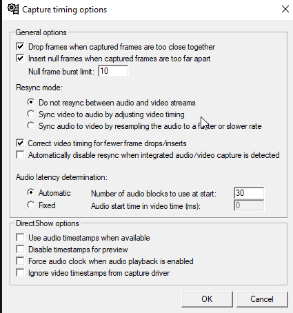

  6. Thanks. This has been incredible helpful and I am very happy with the video settings.
    After recapturing, I now face the issue that audio and video are not in sync. I attached my "Timing" settings and "Disk I/O" settings. What am I doing wrong?

  11. Video Restorer lordsmurf's Avatar
    You need to:
    - auto disable resync when integrated
    - disable timestamps for preview
  12. Originally Posted by lordsmurf View Post
    You need to:
    Thanks for the suggestions. Unfortunately, it did not have any noticeable impact. There is still a massive lag between video and audio when I use VirtualDub.

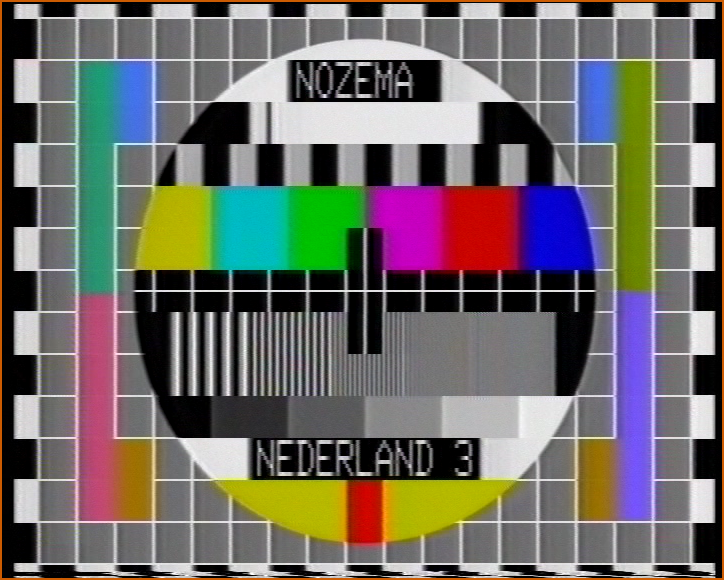

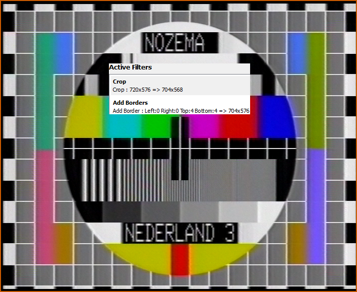

  30. Member The_Doman's Avatar
    Feb 2004
    Netherlands
    I basically have to crop AT LEAST 6 pixels from the bottom (resulting in 6 x 1.3333 = 7,99998 so almost 8, an even number) to get an even number to crop from the sides? Meaning, I cant actually crop just 4 from the bottom as this would not get me an even number for the sides, right?
    If you really want more "perfection" you could center the image after cropping by adding top and bottom borders.
    Really useful if you need to crop a lot extra VHS head switching noise.
    But be careful, with YUV you need to use MOD 4 sizes when cropping/centering vertically!
    For example you could do something like this.
    This is from DV pass-trough, I added a 2 pixel border, and the pictures are (of course) not AR resized!
    I let the player(s) resize and, depending on the destination, de-interlace too.
    [Attachment 82384 - Click to enlarge]
    [Attachment 82385 - Click to enlarge]
