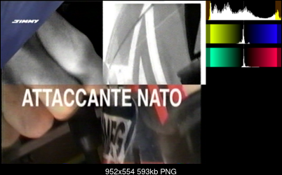

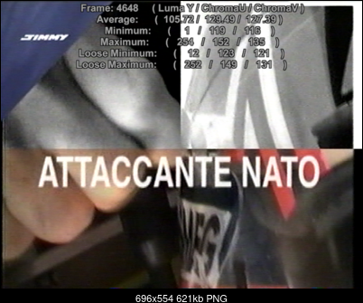

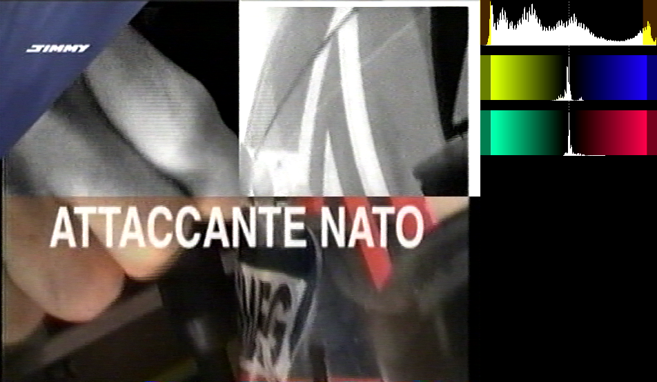

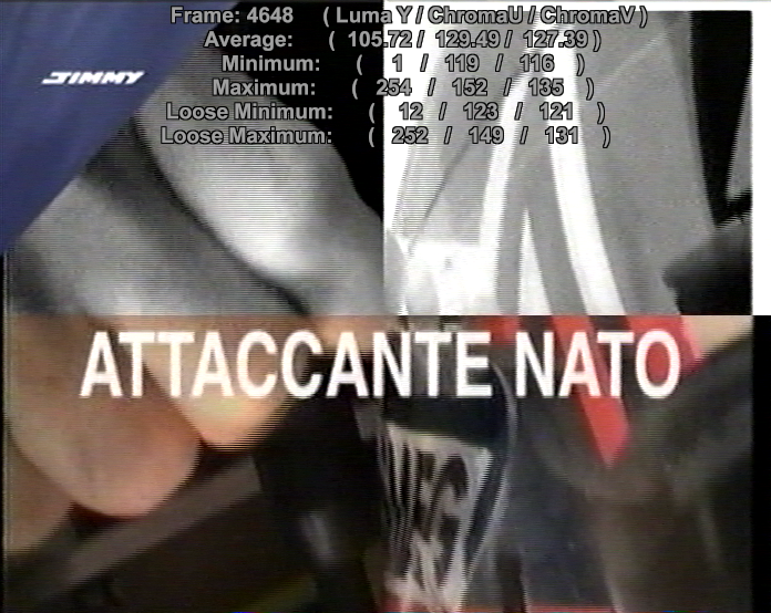

    Because my new capture PC hardware, as per the Hauppauge USB-Live 2 (https://forum.videohelp.com/threads/418254-Info-Hauppauge-USB-Live-2-capturable-range) I did an update of the drivers for my IOData GV-USB2 to latest available (thanks a lot to Alwin for providing me the 115 drivers; for some unknown reason I was unable to download the latest IOData drivers myself on their site with my seial number).
    The card is now able to capture in the range 1-254 as well!

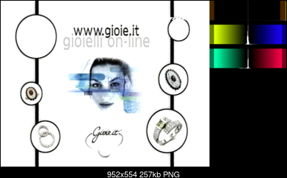

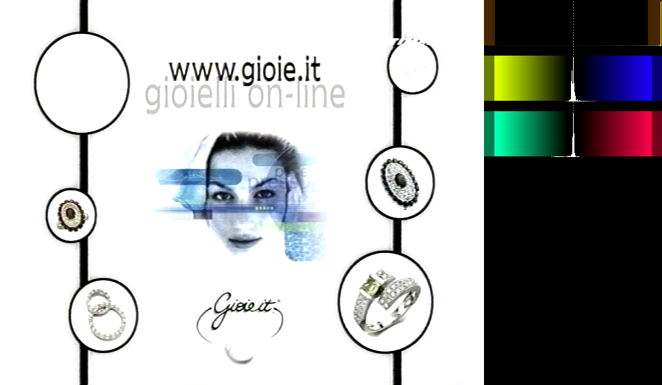

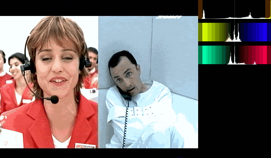

    The new drivers at default procamp values are unbalanced, and the whites are clipped, so the contrast need to be reduced, something that I do not like because I want to reduce the procamp manipulations at minimum (I think Sharc already mentioned that in another thread). I do not remember if it was the same with the old drivers, having lost my data.
    default procamp values:
    customized procamp values:

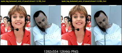

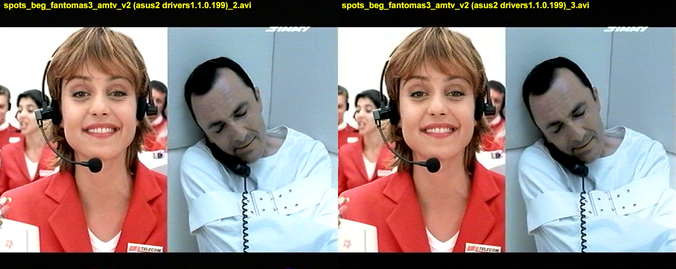

    For people curios about comparisons, here a frame match for USB-Live 2 and GV-USB2. GV-USB2 is unfortunately cutting 2 pixels on the left side compared to the Live-2 (I wonder why producers are not able to capture all available good data across different cards and different drivers, is not nice for us simple users!).
    I did not equalize the pictures for overall look, but the capture quality is very similar (I still have a small preference for the USB-Live 2)
    https://imgsli.com/NDEwMjg4

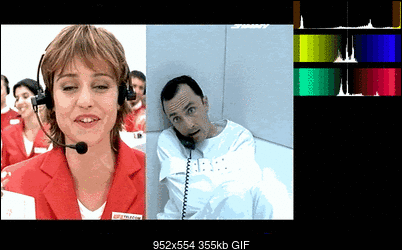

    Last note, about the AGC behavior that Sharc found in the USB-Live thread with test signals, I see the same with the GV-USB2 with real recorded material:
    Unfortunately, in my experience there are no cards free of (small or large) automatic level correction (see the behavior of an old AIW here https://www.digitalfaq.com/forum/video-capture/7775-ati-aiw-7500-a.html analyzed by master msgohan/brad). A balanced set-up in term of input levels should mitigate AGC effect, but it really depends on recorded material (and then input signals) a lot.

  3. Captures & Restoration lollo's Avatar
    Jul 2018
    Italy
    Yes, I reduced the contrast by 4 or 5 steps to do not clip the whites.
    I am using a real recorded signal for my set-up (for the whites assesment, the first spot you can see here https://www.youtube.com/watch?v=AjcEMQZeUcA, which has high level of whites and small objects in the background appearing and disappearing, that is my worst-case).
    IIRC Sharc is using signal tests, that can be more conservative and safer (and never happening in real life).
    In any case, with the GV-USB2 now capturing in the full range 1-254 I think that a small reduction of the contrast (or the brightness) is enough to stay in the capturable range of the card. If you prefer to capture in the 16-235 range is another story, but is difficult and you have to test case by case, tape by tape, segment by segment how to stay inside 16-235 (another reason for me to avoid stress on the procamp setting and capture inside the capturable range rather than in the "legal" range). Your choice

    Re the AGC, it does look a bit concerning on your GIF but your Youtube tells a completely different story: it's almost impossible to see the AGC kick in, even when you are looking for it. So I think it is a non-issue for everybody except the perfectionists; like the levels pump from the AV4 S-Video outlets on the Pannys. Technically yes it's there, practically, quite acceptable and nothing to worry about.
    That youtube video was captured with the USB-Live 2 with no AGC issues. The gif is extrapolated by a GV-USB2 capture of the same tape, with AGC in action.
    As I said, there is no control over the AGC, and sometimes it happens, depending on many variables, for almost all cards. Best we can do is to have "proper" input levels in all aspects.

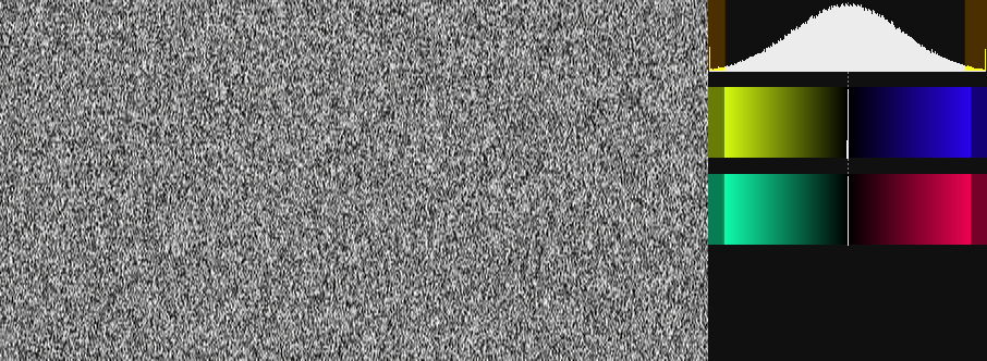

  19. FWIW here a screenshot of a GV capture of noise with a "Gaussian" luma distribution. One can see how the GV captures the full range Y(1....254) with truncating the Gauss tails at its low and high ends. Perfect.
    [Attachment 88526 - Click to enlarge]

  22. In the screenshot in post #19, why is there a blip in the Cb or "U" channel ?
  23. Originally Posted by poisondeathray View Post
    Don't know. Just guessing it is an mpeg2 encoder/artefact issue, or I missed to produce a clean grayscale. Or some luma->chroma crosstalk in the capture setup (cable), or something in the capture device? Focus was on the luma only. I think I was more careful with the sources in post#20.

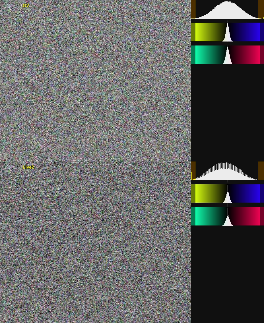

  25. And here a screenshot showing how the auto contrast adjustment (reduction) of the Live2 may convert a smooth histogram (top) into a spiky histogram (bottom).
    Is this possibly the reason why very most of the Live2 histograms I have seen look "spiky" (integer 8bit rounding)?
    [Attachment 88710 - Click to enlarge]

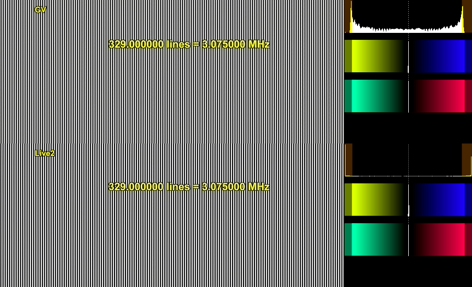

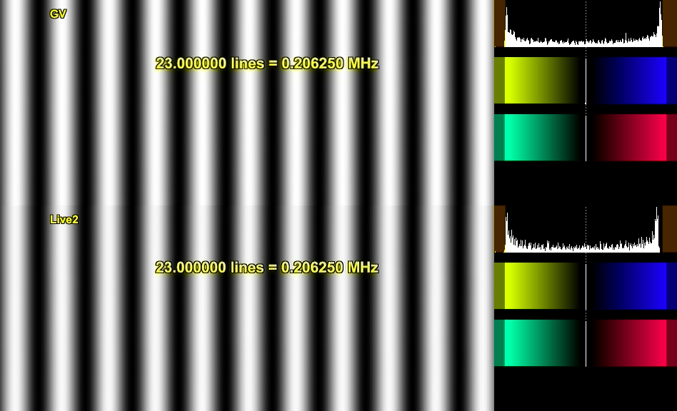

  26. Here another test/surprise.
    The testpattern consists of vertical sinusoidal lines, Y(16.....235) limited range.

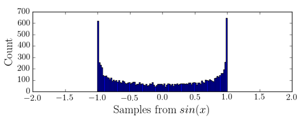

    Screenshot 1: Low resolution (low line count):
    The luma distribution of the GV and Live2 are similar as expected, basically representing the sinusoidal luma distribution of the vertical lines
    Screenshot 2:Higher resolution (above ~300 lines):
    The GV luma histgram is still similar as for the the low line count and represents the luma gradation of the sinusoidal lines.
    The Live2 changed to an (almost) binary superblack/superwhite distribution, indicating that the gradation of the sinusoidal lines got lost. This can easily be misinterpreted as higher sharpness for the Live2, but in fact is an inaccurate representation of the sinusoidal luma pattern, IMO.
    [Attachment 88758 - Click to enlarge]
    [Attachment 88759 - Click to enlarge]
    As a reference here the histogram of a sampled sine wave, for comparison:
    [Attachment 88763 - Click to enlarge]
