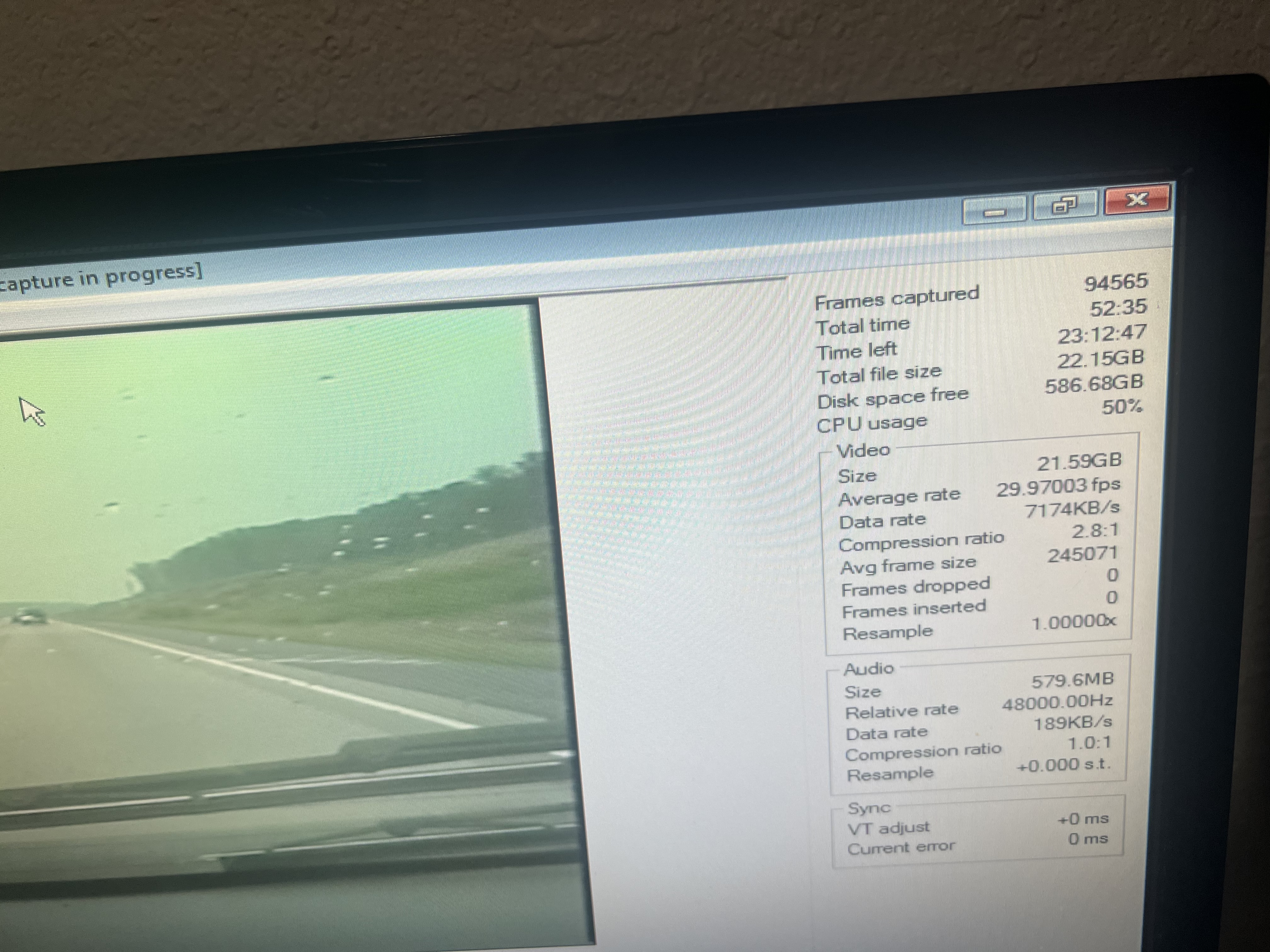

    Here is the dropped frame counter.Image
    [Attachment 89966 - Click to enlarge]
    So, the only way for Vdub to know if the frame is dropped is if it was received by Vdub but not recorded into a file.
    And that could happen only if the setup is bad, like slow hard drive and/or CPU, so Vdub doesn't have enough time to record it, so it has to drop it.
    Analog tapes were captured on old Pentium 4s. They weren’t fast CPUs. Capturing only uses one core so single core speed is what is important. Any CPU made in the last decade has the core speed for capture. If you were capturing 8 bit losslessly compressed. I just looked for something with two cores and two drives that was windows 7. Virtualdub doesn’t receive the frame because it is too late and that’s when it drops because it wasn’t there when it was supposed to be. Virtualdub knows when a frame is supposed to be there. Vdub doesn’t receive the frame to drop it. To keep your computer from dropping frames you don’t want it to have anything else going on and disconnect from the internet.

  13. Originally Posted by Gary34 View Post
    You don't need to show that. I know VD.

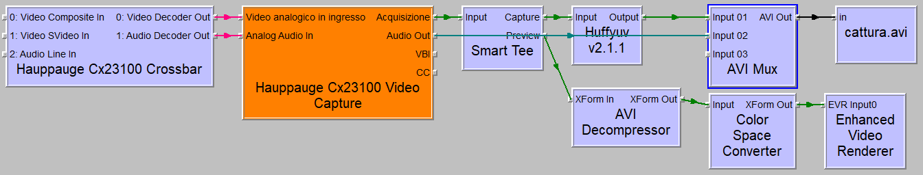

    >> Turns out WDM has IAMDroppedFrames interface to report dropped frames count
    In fact is the filter AVI Mux reporting the dropped frames. Here the graph of my own capture software I use sometimes for cross-check. Also note that is not possible to insert frames in my software, for that we need a more sofisticated program like AmarectTV or VirtualDub.
    We had a post about dropped/inserted frames here: https://forum.videohelp.com/threads/416657-Analog-Capture-inserted-and-dropped-frames
    As a complement to that discussion, following are some more details.
    This is the log of a capture of a problematic tape done with AmarecTV, where you have isolated innserted frames, inserted frames consequence of a dropped frame, buffered frames (arrving a little bit to late but taken into account thanks to a buffering of the software) and isolated dropped frames.
    The understanding of the different mechanisms should be easy, but I am attaching the original log file and the Excel file I used to extrapolate the data:

    VT=00:07:26.965s(11174) 11179 ok
    VT=00:07:26.996s(11175) 11181 1 dropped
    VT=00:07:27.026s(11176) 11181 buffered
    VT=00:07:27.090s(11177) 11182 ok
    VT=00:07:27.123s(11178) 11183 ok
    VT=00:07:27.188s(11179) 11185 1 dropped
    VT=00:07:27.252s(11180) 11186 ok
    VT=00:07:27.284s(11181) 11187 ok NT=00:07:27.284s(11182) Total=11
    VT=00:07:27.315s(11183) 11188 ok
    VT=00:46:19.823s(69490) 69504 ok
    VT=00:46:19.887s(69491) 69506 1 dropped
    VT=00:46:19.952s(69492) 69508 1 dropped
    VT=00:46:19.983s(69493) 69509 ok
    VT=00:46:20.016s(69494) 69510 ok
    VT=00:46:20.079s(69495) 69511 ok
    VT=00:46:20.112s(69496) 69512 ok NT=00:46:20.112s(69497) Total=21
    VT=00:46:20.143s(69498) 69513 ok
    Attached the original AmarecTV log file and a link to my excel processing file if somebody is interested to look more in detail: ufo_s1a_amtv_v2a.avi.txt
    excel processing file: https://docs.google.com/spreadsheets/d/1zOZOQl3W9URcIVyylqf8i5cFlMKyzydj/edit?usp=shar...f=true&sd=true
    edit Some more details about the AVI Mux behavior: https://learn.microsoft.com/it-it/windows/win32/directshow/avi-mux-filter?redirectedfrom=MSDN
    "Dropped Frames
    The AVI Mux filter calculates dropped frames based on each sample's media times, if available, or else the sample's time stamps. It writes a zero-length index entry for every dropped frame.
    Which is somehow useless. The best capturing software is AmarecTV, first because it does not generally introduce a/v asynch like VirtualDub do (especially with modern cards and modern OSs), and second because it provides a detailed report about what is happening during capture.
    The dropped frames counter isn’t useless and I can’t get AmerecTV to work with my Pinnacle cards so I have no opinion on that software. I’ve heard it’s good but I don’t know. I’ve never had A/V sync issues in Vdub but I use a frame TBC.
    So, if you really want to be sure, you have to do at least 2 captures and then run frame-by-frame comparison.
    A lot of people won’t want to do that. I never have those kinds of issues anyways.
    >> Maybe you have a capture card that doesn’t report dropped frames.
    A card itself cannot and does not report dropped frames.
    You know what I mean. Same as you pointing out the difference between frame and frame sync TBC earlier. Everyone generally says frame TBC with Datavideo and AVT units. You are getting kinda particular.
