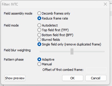

Related issue: with this frame pattern, in VDub, I can set the ITVC to Single Field Only:
[Attachment 81566 - Click to enlarge]
It is leaving every 24th frame (that's a duped frame). It's removing all the other dupes.
Autodetect doesn't work well; sometimes it misses a dupe, on other frames it has bad interlacing.
Any ideas?
Edit 2: Hello Hello, your file doesn't have any dupes. Was that only with VDub's IVTC filter, and if so, what version VDub are you using?Last edited by Alwyn; 18th Aug 2024 at 10:01.
It's normal 'soft telecine', which DGSource (form DGDecNV) with fieldop=1 works fine on.That King and I clip is encoded progressive at 23.976 fps with pulldown flags. Some decoders will perform the pulldown and deliver 29.97i, some will ignore the pulldown and deliver 23.976 progressive, some will ignore the pulldown and deliver 29.97p (with the duplicate frames).users currently on my ignore list: deadrats, Stears555, marcorocchini
