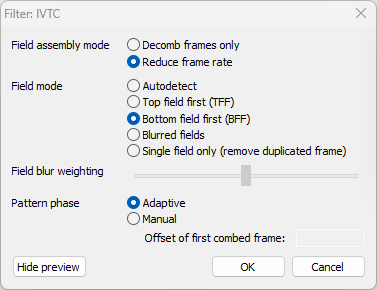

  8. Originally Posted by Alwyn View Post
    Your Hybrid tutorial is for QTGMC bob-deinterlacing IMO (unless I missed something). This particular clean telecined source should be IVTCed instead, rather than bob-deinterlaced.
    You don't say.
    Well, you seem to not fully understand how to properly IVTC with Avisynth, Hybrid or Vdub2, right?
    Vdub2:
    Reduce frame rate acts like TDecimate() in Avisynth's IVTC which is TFM().TDecimate() to return the 23.976 fps progressive film frames.
    Without it you would get a pattern with progressive frame repetitions like abcddefghh..... @29.97fps.
    [Attachment 81470 - Click to enlarge]
    (Bob-deinterlace (QTGMC) of telecined material as per your tutorial may sometimes be the last resort for weird sources with broken patterns. Here it just leaves you with a jerky (judder) 2-3 progressive pattern at 59.94fps though, like aabbbccdddeefff....... TVs normally do the same).

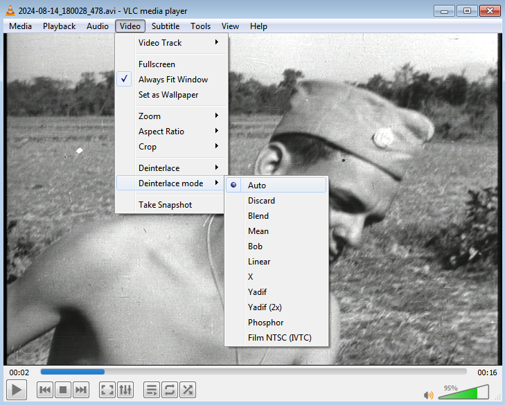

  9. Member The_Doman's Avatar
    Feb 2004
    Netherlands
    Keep in mind that deinterlacing inevitably introduces artifacts, even the great QTGMC. So if archiving is the purpose, I would suggest to either
    - keep it in the original format (interlaced/telecined), and deinterlace/IVTC at playback time only, see @thecoalman's post#13
    Keeping it "original" and de-interlace during playback would be the most logic option indeed.
    You could do it with VLC for example.
    Interestingly it seems to default to bottom field first with undefined field order files which should work correctly for the video's from the DV camera.
    There is still no option to define the field order manually?
    Google: VLC deinterlace define field order
    [Attachment 81477 - Click to enlarge]

  12. Originally Posted by The_Doman View Post
    Yes, but you should select Deinterlace mode -> Film NTSC (IVTC). It's actually not 'deinterlacing' but Inverse Telecining (IVTC) which gives correct results (means 23.976fps progresive film frames) for this telecined source.
    (This whole 'deinterlacing/QTGMC' discussion has been pretty misleading, actually, for this source.)
