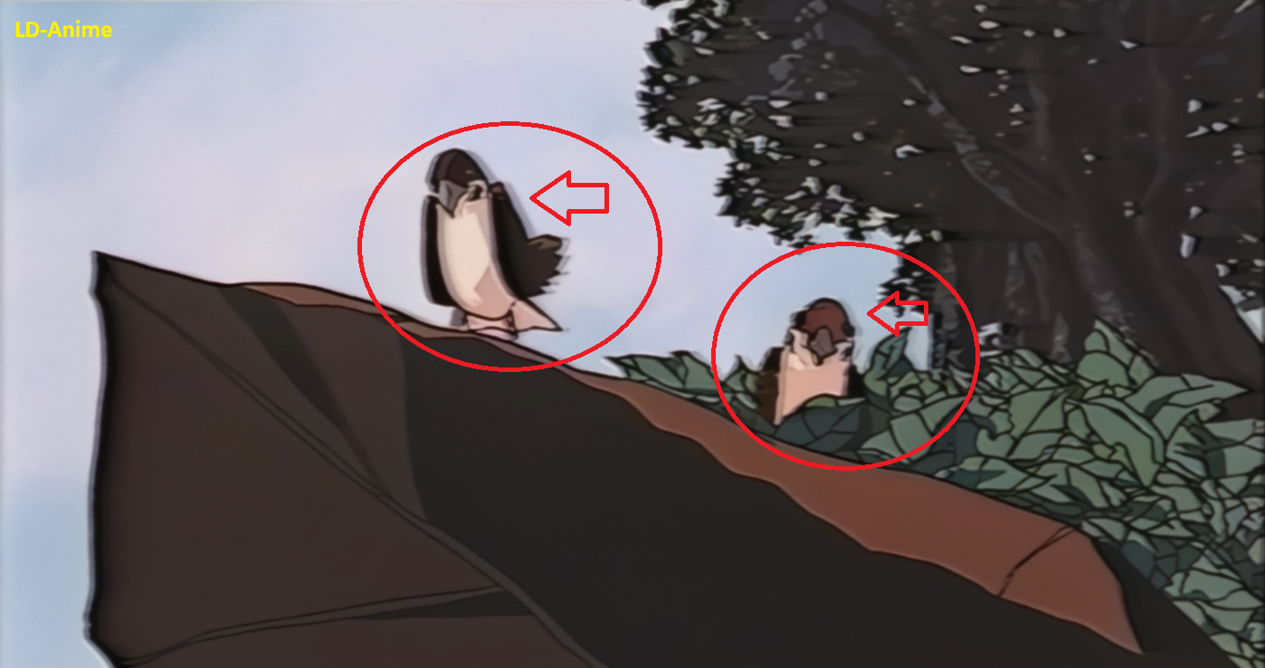

    Awesome! Thank you so much, that helped solve the issue. I also spent all day yesterday messing around with different models, and "2x_LD-Anime_Skr_v1.0" produced incredible results. I was baffled at how good it looked.
    One issue that I noticed though, is that in my source, there's something that looks similar to haloing, but it isn't haloing. I'm not exactly sure what the term to describe it is (is this the chroma shift that Selur was referring to?). But basically, it looks like some of the color bleeds outside the lines, and then LD-Anime ends up enhancing it so that it becomes more obvious and prominent. I'll uploaded a couple of pictures and a short 2 second clip.

  7. There are halos all around, but that looks more like some blurring, blending, ghosting. That is not a chroma shift.
    LGhost(clip, mode=[1,1,1], shift=[3,4,5], intensity=[60,60,60]) and DeHalo_alpha(): https://imgsli.com/MjYwMDc5 help somewhat and do not seem to mess too much up.
    Cu Selur

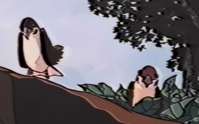

    Oh sweet! Yeah that looks a lot better, thank you! If I may ask, I've been messing around with Dehalo_alpha and FineDehalo, and according to the docs, it seems FineDehalo is an upgrade to the former? Is there any difference really between the two?
    Also, I was wondering if I could ask too, once the VsLGhost filter is applied, in place of that ghosting/blending/blurring issue, it seems to leave behind something more akin to a really strong halo in its place (it's more like a really light spot where the ghosting was at) which I can't seem to scrub away with the Dehalo filters. Is that something that can be removed? Or is it probably going to have to be a compromise, between the former problem and this one? I'm totally okay with experimenting with some other filters to try and remove it, I'm just not sure what filter would do the job, or if it's possible (it sucks being such a novice at this that I can't even identify what kind of problem is occurring lol). Thanks again!
    Edit: Mostly asking about that light spot because LD-Anime ends up enhancing it, too.

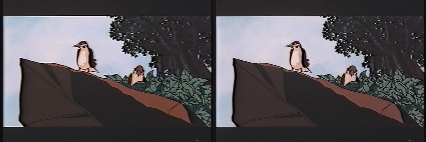

  11. For what it's worth, here's something a little different for removing that ghost to the right of the dark areas:
    LWLibavVideoSource("birds.avi", cache=false, prefer_hw=2)
    ConvertToYV12()
    Spline36Resize(400, height) # closer to the true resolution of VHS
    Overlay(last, last, x=3, mode="subtract", opacity=0.2).ColorYUV(gain_y=60) # subtract ghost
    dehalo_alpha(rx=2.5, ry=2.0, darkstr=1.2, brightstr=1.2) # then halo reduction
    # sharpen and upscale back to the original frame size
    aWarpSharp2(depth=5)
    CAS(0.7)
    nnedi3_rpow2(2, cshift="Spline36Resize", fwidth=720, fheight=480)
    before and after:Image
    [Attachment 78740 - Click to enlarge]

    You. Are. A. Life. Saver. This worked wonderfully, thank you so much! Between this and your help with the QTGMC Srestore, you've seriously helped me a ton. Thank you again!
