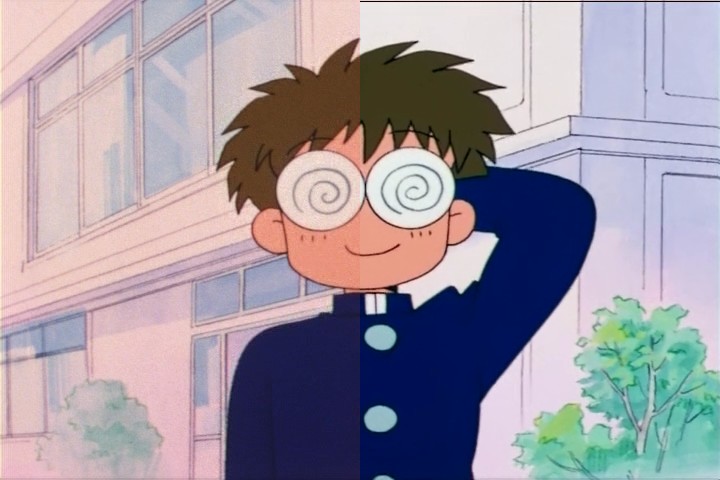

  13. How about this? It is not over-smoothened, but I need a second opinion.
  14. Also, is there a filter that allows me too change the amount of red? The pinkish tint is annoying.
  15. Both Sanlyn's and my samples removed the red tint from the whites.
