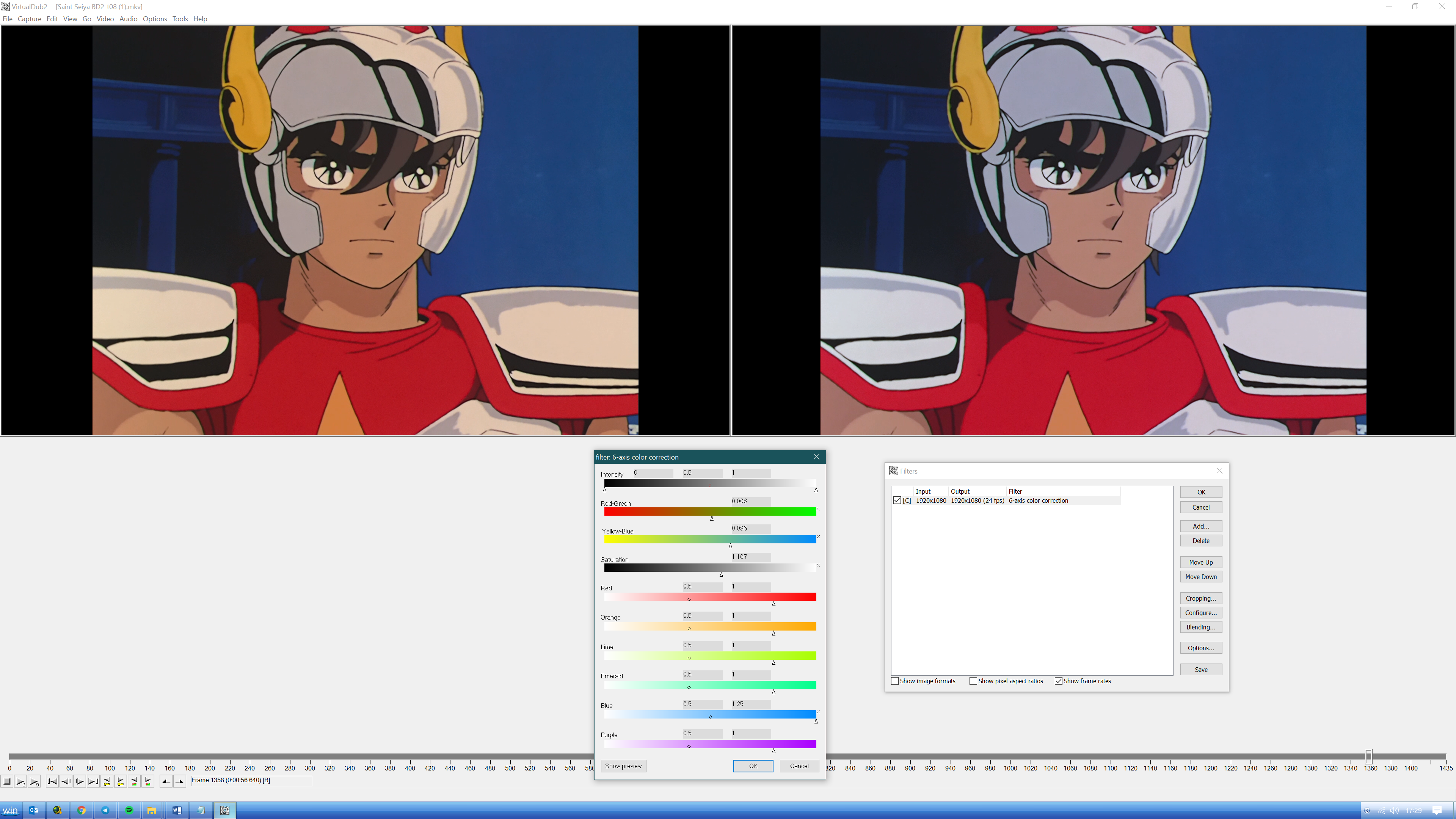

    I am searching to tweak the colors for the whites to be more white, and the blues "more blue". Like the DB screenshots.
    I just tryed it on VDub with the 6 axis filter:
    How can I tweak like this on avisynth?

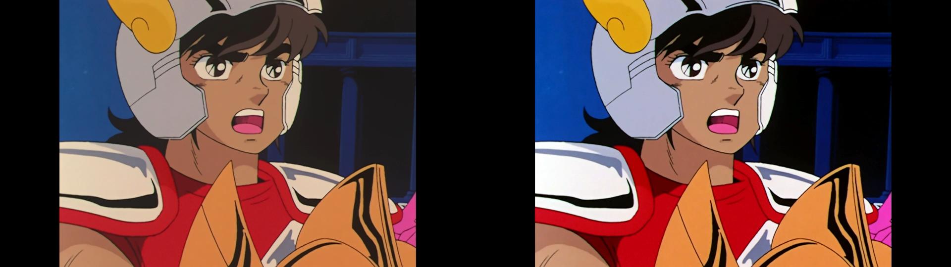

  7. Code:
    ConvertToRGB(matrix="rec709")
    RGBAdjust(rb=-29, gb=-26, bb=-27)
    RGBAdjust(r=250.0/200.0, g=250.0/182.0, b=250.0/154.0)
    before, after:
    [Attachment 58153 - Click to enlarge]
    Gamma may need adjusting too. But I didn't see any shots with obvious medium greys to check.

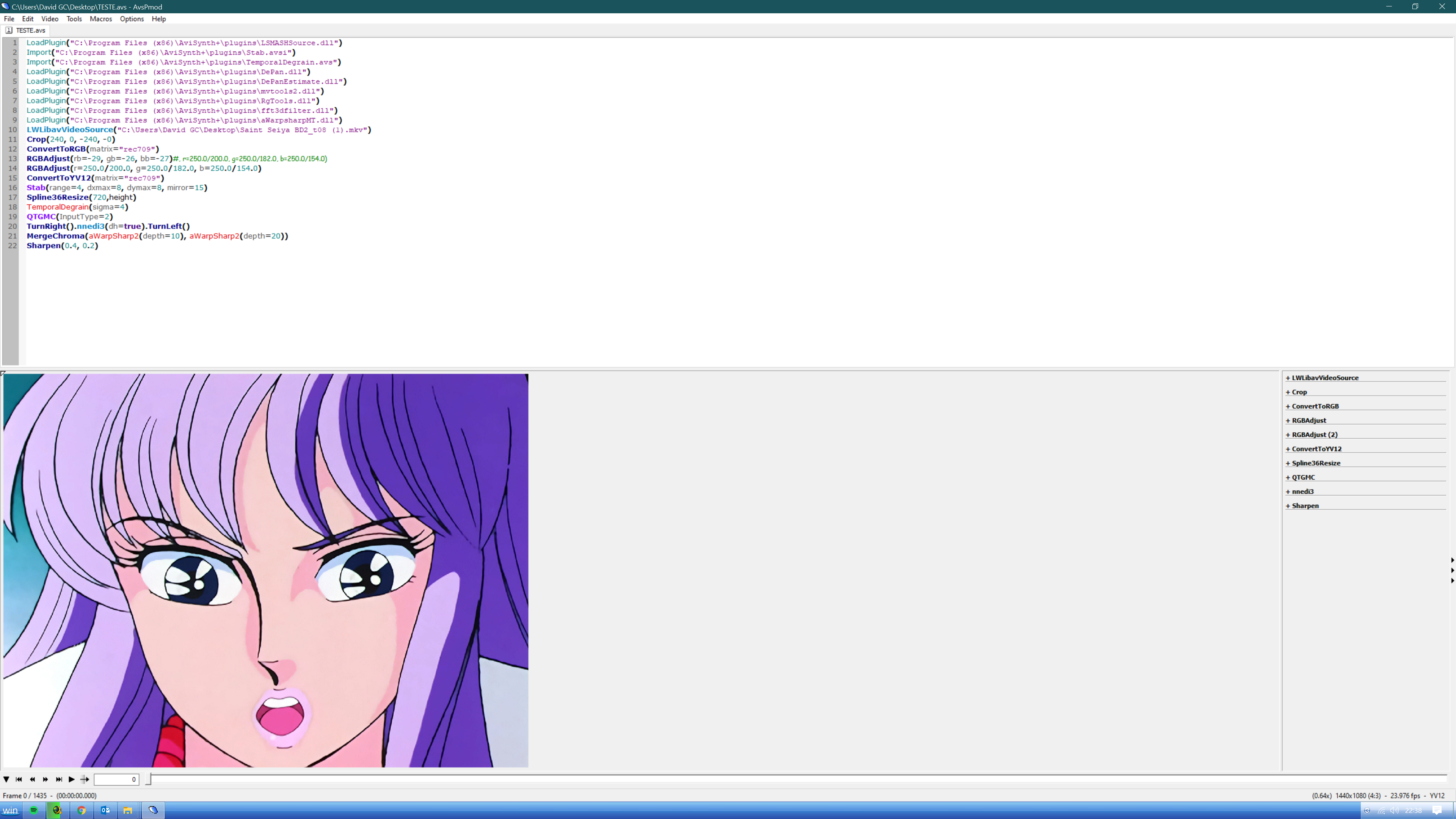

  12. I would put Stab(range=4, dxmax=8, dymax=8, mirror=15) before TemporalDegrain(). If you want thinner lines, yes, increase the depth in aWarpSharp2() (in the script the first is for the luma, the second for the chroma). Personally, I think it's already over sharpened and the lines shouldn't be thinner. You might also try adding Spline36Resize(720,height).TurnRight().nnedi3(dh=t rue).TurnLeft() between TemporalDegrain() and MergeChroma(). That may improve some of the thin vertical lines. Or try using a line darkener like Hysteria().
    LWLibavVideoSource("Saint Seiya BD2_t08 (1).mkv", cache=false, prefer_hw=2)
    Crop(240,0,-240,-0)
    RGBAdjust(rb=-29, gb=-26, bb=-27)#, r=250.0/200.0, g=250.0/182.0, b=250.0/154.0)
    ConvertToYV12(matrix="rec709")
    TemporalDegrain(sigma=4)
    TurnRight().nnedi3(dh=true).TurnLeft()
    MergeChroma(aWarpSharp2(depth=10), aWarpSharp2(depth=20))
    Sharpen(0.4, 0.2)
    Then, if you really want to stabilize the picture add QTGMC(InputType=2) after TemporalDegrain(). It will be very very slow but those little twittering edges will stop twittering.

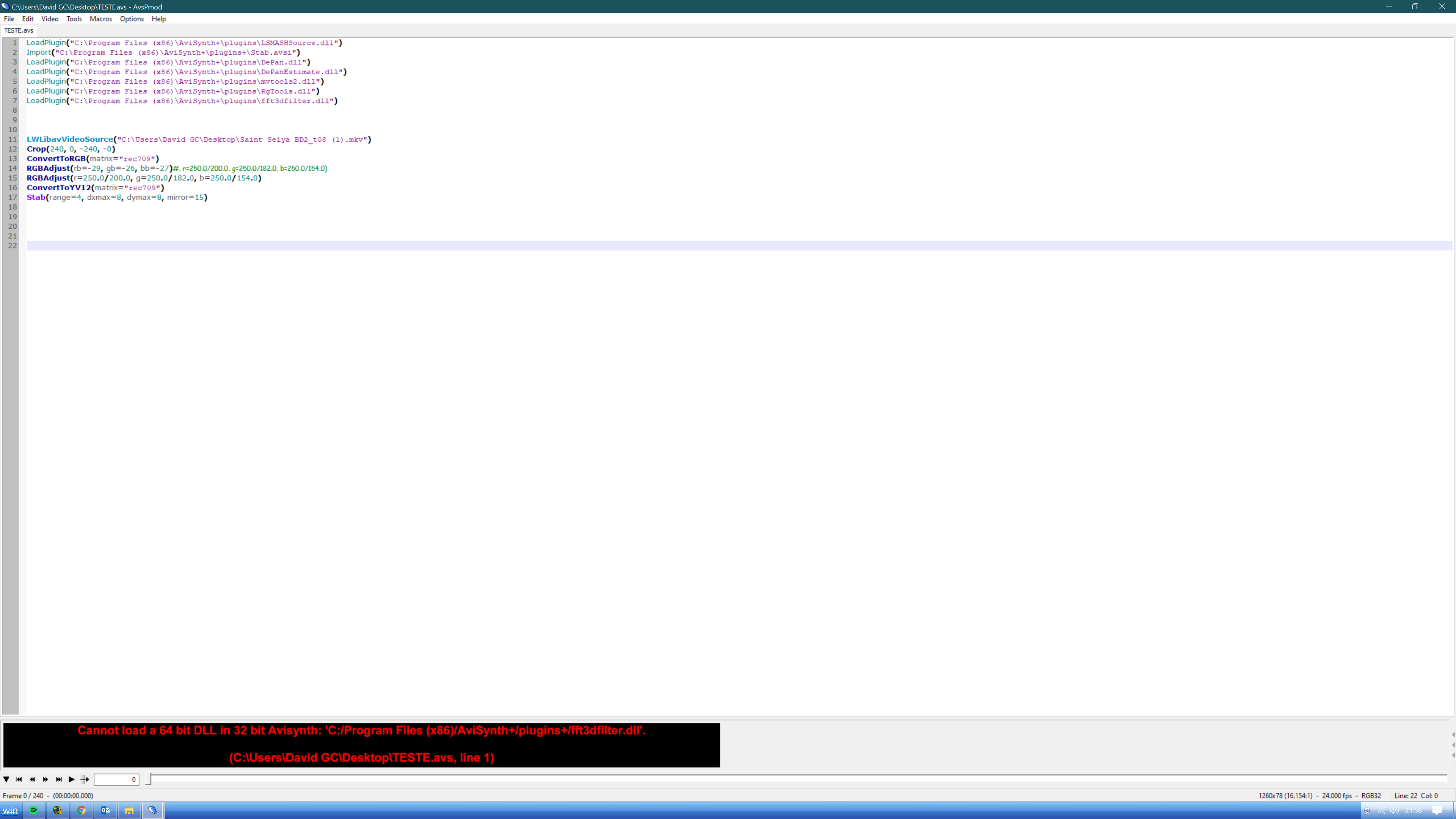

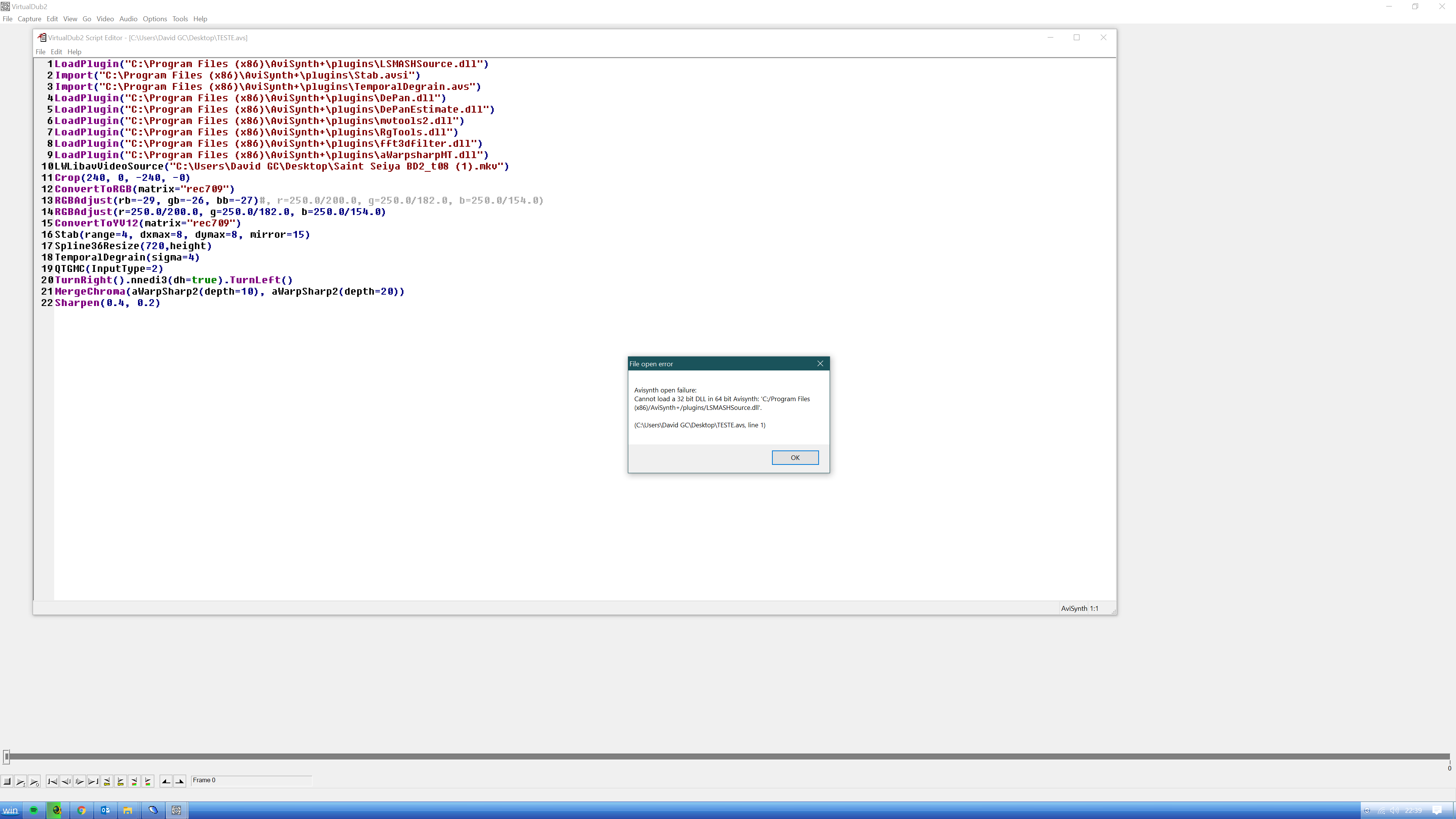

    1- The stab filter give me an error saying that he cannot recognize the "mirror" function, i erased it then.
    2- On the preview the image was stretched 4:3 to 16:9 ?
    3- The encoding stucks for about 30min and return me an error. Here is the log file:

  18. Member
    Apr 2012
    Portugal
    I make it to create a script on Avspmod, that seems to work since it shows on preview. (?)
    When i try to load the script on Vdub, that shows me that error. What i am doing wrong?
    If the scripts preview on avspmod, it is suppose to be able to be encoded?
    Thanks for patience and help,

  19. I can tell from the screenshot you are running 32 bit AviSynth and 32 bit Avspmod. The error message is telling you what's wrong: you are running 64 bit VirtualDub -- which means you need to run 64 bit AviSynth and import 64 bit dlls. Switch to 32 bit VirtualDub. Or you can switch to all 64 bit versions.
    32 bit editors/encoders will use 32 bit AviSynth and 32 bit filters. 64 bit editors/encoders will use 64 bit AviSynth and 64 bit filters. The two environments can't use each others' components.
    Apr 2012
    Portugal
    Just worked !
    I will try now to encode the sample !
    Thanks a lot for your help

    Sample, with the following script:
    LoadPlugin("C:\Program Files (x86)\AviSynth+\plugins\LSMASHSource.dll")
    Import("C:\Program Files (x86)\AviSynth+\plugins\Stab.avsi")
    Import("C:\Program Files (x86)\AviSynth+\plugins\TemporalDegrain.avs")
    LoadPlugin("C:\Program Files (x86)\AviSynth+\plugins\DePan.dll")
    LoadPlugin("C:\Program Files (x86)\AviSynth+\plugins\DePanEstimate.dll")
    LoadPlugin("C:\Program Files (x86)\AviSynth+\plugins\mvtools2.dll")
    LoadPlugin("C:\Program Files (x86)\AviSynth+\plugins\RgTools.dll")
    LoadPlugin("C:\Program Files (x86)\AviSynth+\plugins\fft3dfilter.dll")
    LoadPlugin("C:\Program Files (x86)\AviSynth+\plugins\aWarpsharpMT.dll")
    LWLibavVideoSource("C:\Users\David GC\Desktop\Saint Seiya BD2_t08 (1).mkv")
    Crop(240, 0, -240, -0)
    QTGMC(InputType=2)
    Sharpen(0.4, 0.2)
    I like very much the result.
    Do you think?
  24. Looks the same as the version I made.
  25. Member
    Apr 2012
    Portugal
    Yes, it is.
    I was just trying to fix the problem with the 4:3 ratio that I had.
    If I want a 960x720 output which and where do you think that the resizer shoud be put on the script?

    I used your script and the result is great !
    I will try now some full episodes.
    Thanks !!

    I have the DVD collection of Captain Tsubasa anime.
    The purpose is to the the same filtering and if it's possible, to do an upscale to 1080p.
    In attachment you will find a sample of the original file muxed to MKV and a test that I've done.
    For my encode i did:
    1 - I struggle to understand how to tweak the RGBadjust() command. So i made the tweak color with Vdub and the 6 axis color correction filter.
    2 - I used the Anime4KCPP GUI to upscale to 1080p
    3 - Than i used the following script that is basically the same that used to Saint Seiya:
    QTGMC(InputType=2)
    Sharpen(0.4, 0.2)
    The result is of course not a beauty. The black lines are vanished and lost some of the "black" tonality.
    Can you help me? If you have a script that replace the use of Vdub and Anime4KCPP, i'll take it.
    Thanks a lot.

    Here is the encode that I made with your script. The result is nice ! Thanks !
    It is possible to denoise a little bit more to have more uniform surface of color or do you think I loose detail (screenshot)?
