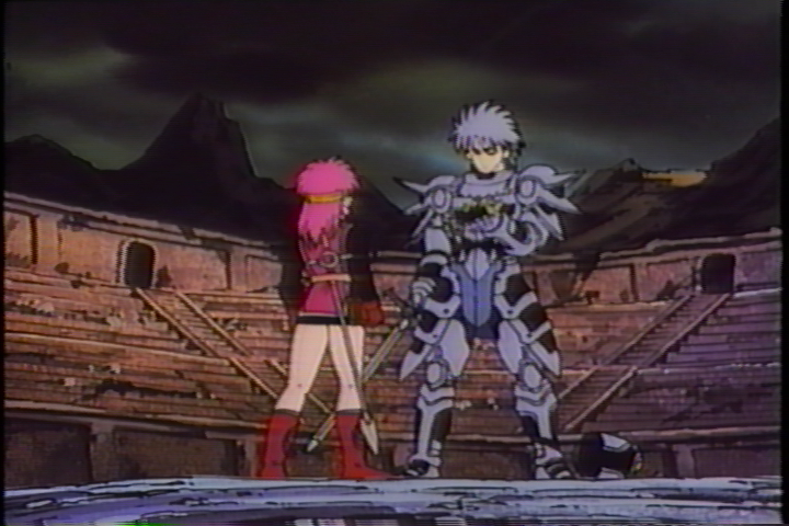

    Here is a screenshot of the captured AVI YUY2 file.
    It looks terrible.
    I want to use filters in Virtualdub because you can't preview AviSynth.
    So far I'm using:
    -Null Transform (706x476) - I want to crop out VHS edges.
    -Asvzzz Deinterlace
    -Static Noise Reduction - Interlaced checked (6)
    -Frame Merger (2)
    -Dynamic Noise Reduction (16) - it won't let me choose besides 16.
    Any ideas or suggestions would help.
    I'm not sure how to crop/resize the whole thing.
    Any help, would help.
    I also want to sharpen the image but don't know
    how to do it without hurting the original.
    [Attachment 23933 - Click to enlarge]
    It looks terrible.
    Depends on the compression quality of your JPG image. A PNG would be better because it's lossless compression.

    You don't change the original. You make a new copy of what you process.
    Going directly from YUV to RGB improperly will do some damage, as your image demonstrates.
    We can't advise properly from a jpg image alone. We need a sample of your original, unprocessed YUY2 capture. 10 seconds or so with some frames showing motion will do. You can post directly in the forum. If you need to know how to prepare a sample, just ask.
    Do not deinterlace anime unless you know what you're doing. DVD is usually interlaced anyway.

    Here is a png screenshot.
    It is from Media Player Classic.
