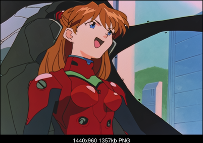

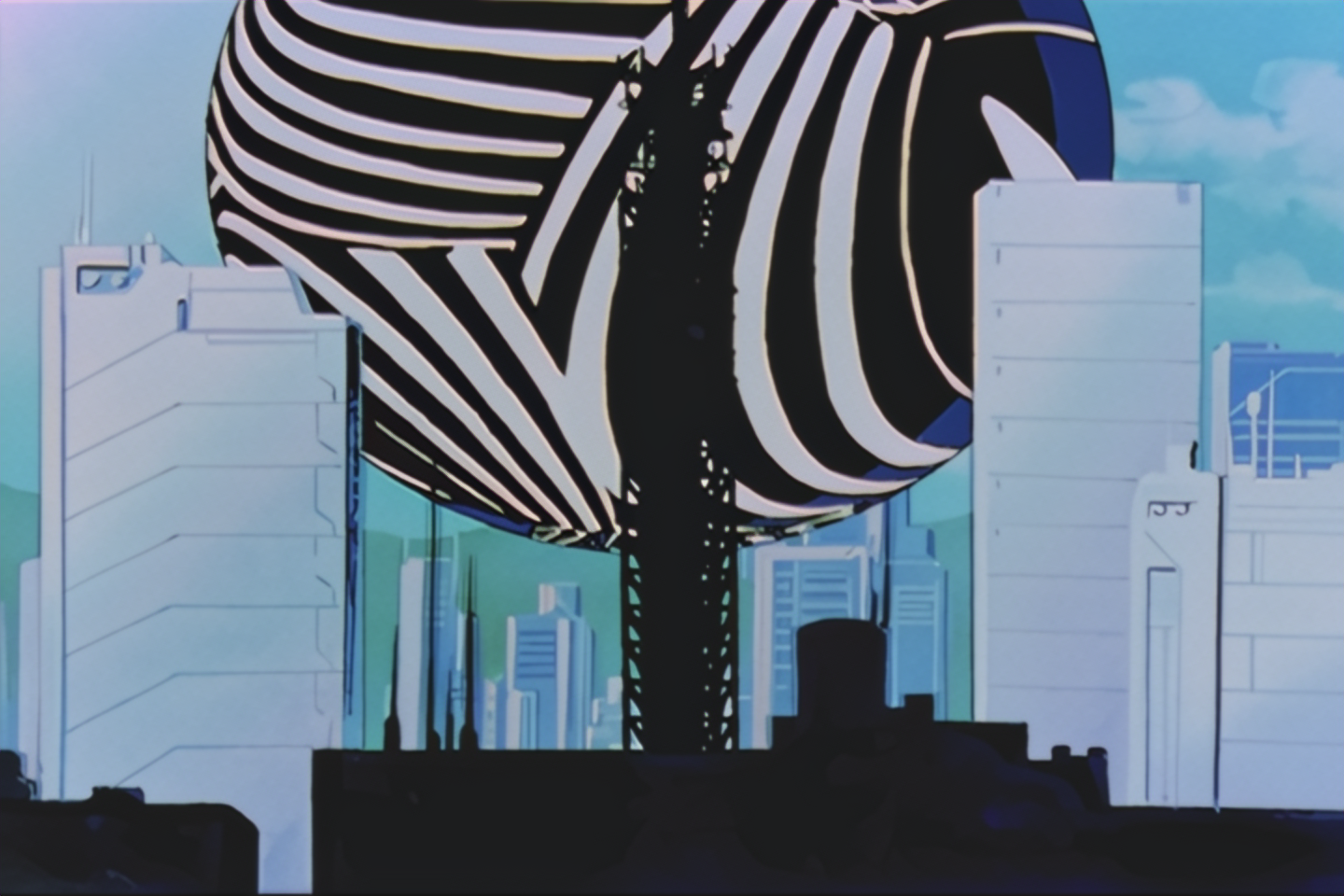

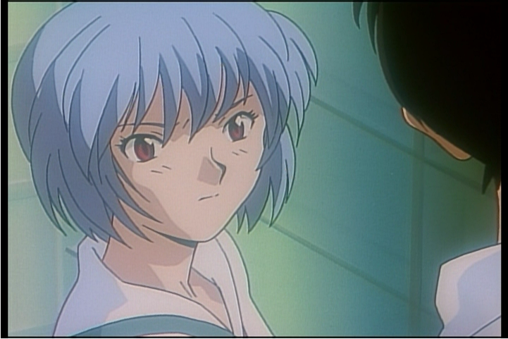

  1. Evangelion is an anime from 1996 and over the years it has received 2 or 3 telecines, with one of them being the one made for broadcasting back in 96 and the other one for the streaming services and bluray release in 2015. I believe there was also one done in 2003, anyway,
    between 1996 and 2003 the original 16mm negative for the episode 16 had been lost, possibly stolen, so for the bluray restoration a 35mm print had been used, which looked terrible since the black levels were really messed up and stuff (that might have also been a fault of theirs). The best looking version rn in terms of shadow detail is from "Archives of Evangelion", and that one also looks like junk.
    Now is there any way to fix some of many problems present in this video, such as the odd frame blending, uneven telecining and haloing?
    [Attachment 64824 - Click to enlarge]
    [Attachment 64825 - Click to enlarge]

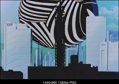

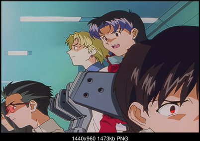

  5. I tried mixing both the downscaled bluray (too much contrast/black crushing done) and archives dvd, with both of them being re colour corrected.
ID:	64847 (this ones from original telecine)
  6. Aside from the color correction (I usually do this in the last step and it's mostly is a matter for preference), do both DVD and Blu-ray have the same ghosting issues ?
    In the clip.MPG there is basically no frame without ghosting on horizonal scrolls,...

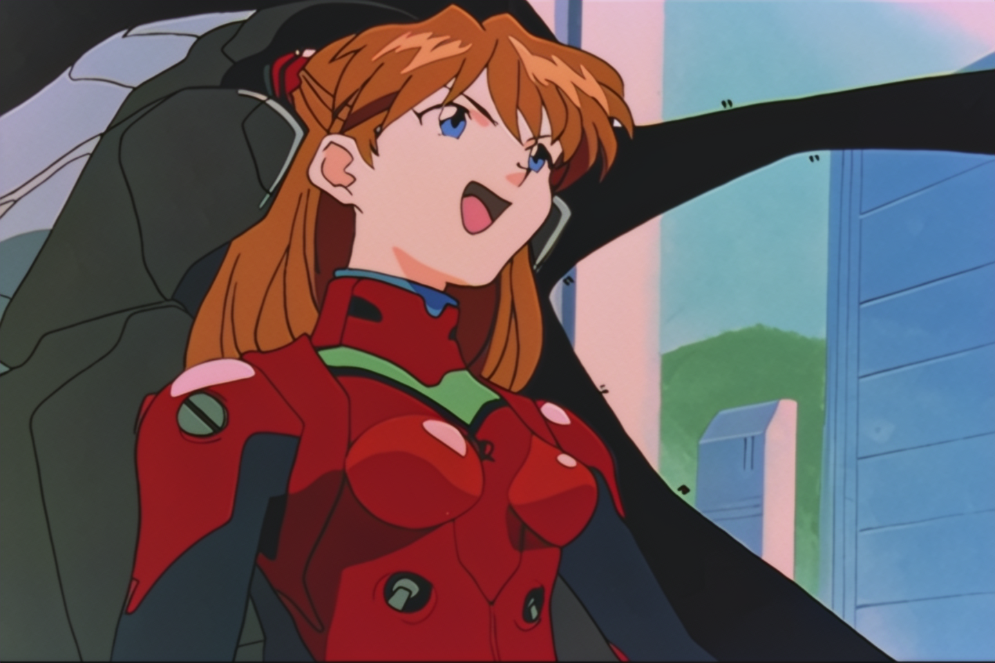

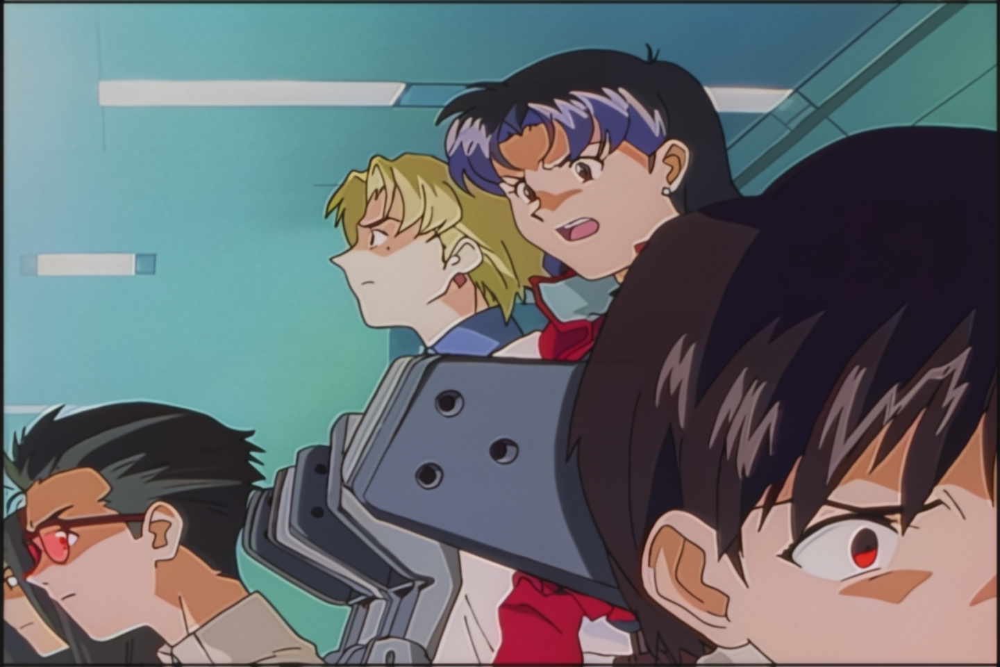

    jsut for fun, Dehalo_alpha + VSGAN(2x_SHARP_ANIME_v1):

    Excellent result! What parameters did you use for dehalo_alpha?
  8. I used the default settings, couldn't really find that changing from the defaults did a noticable difference.
    VSGAN model I used can be found over at https://upscale.wiki/wiki/Model_Database
    Cu Selur
  9. Try something like:
    edgemask = mt_edge(mode="prewitt", thy1=100, thy2=200).mt_expand().mt_expand().Blur(1.4).GreyScale()
    Overlay(last, Dehalo_alpha(rx=4.0, ry=3.0, DarkStr=1.0, BrightStr=1.0), mask=edgemask)
  10. (whole cleaning up the source doesn't seem much of an issue to me, since everything I saw could be tackled through different filters,...)
    @jagabo: got an idea how to get rid of the ghosting in the horizontal scrolling scenes ?
  11. For the horizontal pan ghosting, if you use only the 1 source, you redo parts of the animation using a clean plate
    For example, the gun pan shot has every 5th field almost clean (well, much cleaner than the others), so you either motion track + composite (e.g. after effects), or interpolate (probably artifacts, not as good choice because this is a pan over static contents)
    https://www.reddit.com/r/evangelion/comments/btoqje/digital_enhancement_of_episode_16/
    That one used the crossfade, so you can see the previous scene in the right. I would have cleaned it up a bit more in photoshop, because there is still minor color bleed and ghosting
  12. do both DVD and Blu-ray have the same ghosting issues
    No, but due to the extreme black compression some scenes can be deemed unusable. Such as this one https://www.twitter.com/LettererBrendo/status/1145870055936286720/photo/4 (photo 4). Tweet illustrates the difference between two versions pretty well. I tried messing with premiere pro and Photoshop and getting any detail out of Asuka in that scene is almost impossible.
