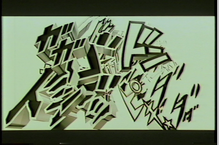

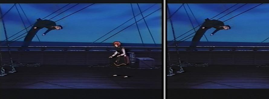

  1. Hi, I just finishing doing a few captures of a VHS tape, and was hoping to do some filtering via VirtualDub. I've included some pictures of an issue I've ran into. If you look at pictures 1 and 2 back to back, it should be pretty noticeable. The same effect can be seen above the flipping guy in picture 3. There is a slight discoloration that appears to be an after-image. I've included a few frames as attachments. I was wondering what this issue in particular was, and if there was a filter that could solve it?
    It seems to be a "temporal" issue, I think? I'm using the "temporal smoother" filter in VirtualDub and I can see noticeable changes in the after-image effect. Although it doesn't seem to necessarily improve it, it just seems to move it around. Any recommendations on filters to improve the temporal effect? The "temporal cleaner" filter doesn't seem to do anything at all, though.
    I'd also welcome any feedback for additional filters that I should be on the lookout to use.
    Thank you so much!

  2. I think I see what the issue is. I used ITVC on my source because it had blending issues, but the frames that had blending issues went from that to this ghosting issue. IVTC definitely made it look better, but is there a way to apply that without getting this ghosting problem?
    Mar 2008
    Provide a short clip cut from your original capture and post it here in the thread
  4. It looks like wrong conversion of 4:2:2 or 4:4:4 to 4:2:0 (progressive instead of interlaced). Maybe error in conversion filter or settings.
    Example in AVS:
    ConvertToYV12(interlaced=true) - correct
    ConvertToYV12(interlaced=false) - wrong with such chroma ghosting at moving areas.

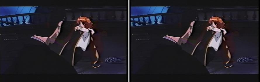

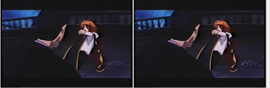

  13. The edit mode clip has less chroma ghosting. Side by side after QTGMC(preset="fast").SRestore():
    v1 = LWLibavVideoSource("10 sec clip.avi", cache=false, prefer_hw=2).AssumeTFF()
    v2 = LWLibavVideoSource("10 sec clip in edit mode.avi", cache=false, prefer_hw=2).AssumeTFF()
    v1 = QTGMC(v1, preset="fast").SRestore().Subtitle("Norm")
    v2 = QTGMC(v2, preset="fast").SRestore().Subtitle("Edit")
    StackHorizontal(v1, v2)

    No, as jagabo already pointed out, there is a difference: https://imgsli.com/MjU4NzIy

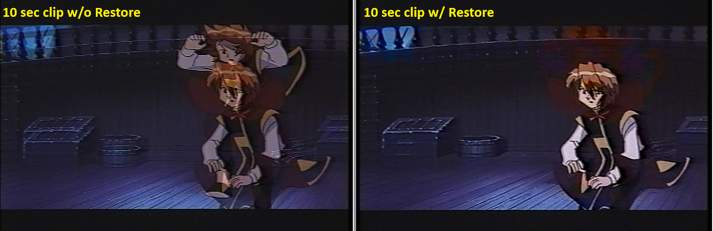

    Would it be alright if I asked a few follow up questions?
    I noticed that the QTGMC Restore function seems to do the same thing as the ITVC I've been applying (specifically AnimeITVC mode=1). Do they perform a similar function?
    Secondly, I've uploaded another picture (from the EDIT capture). On the left is the clip before the Restore function is called, and the one on the right is after Restore is called. Is the "bleeding/ghosting" effect that gets left behind after a Restore/ITVC is performed just some unavoidable chroma/bleeding due to the source?
  16. There are differences between TFM().TDecimate() (apparently what AnimeIVTC does) and QTGMC().SRestore(). One of the biggest being that TDecimate() removes identical (or the most similar) frames when decimating, whereas SRestore() removes the frames with the most blending. So SRestore() tends to remove blended frame, TDecimate() tends to keep them.
    Another thing to keep in mind is that SRestore() often takes a while to lock into a pattern. If you seek to a random frame you will usually see something different than when you seek to an earlier fame and move frame by frame to that same frame.

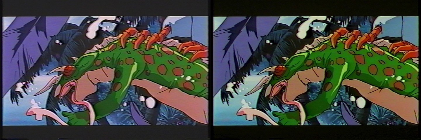

  25. I can't really say what's causing the stuttering. I'd have to see the source to get a better idea.
    Try this script after QTGMC/SRestore process:
    LWLibavVideoSource("QTGMC Srestore Only.avi", cache=false, prefer_hw=2)
    ConvertToYV12()
    ColorYUV(gain_y=90, off_y=-55, gamma_y=50, cont_u=90, cont_v=90).ColorYUV(levels="PC->TV")
    ConvertToRGB(matrix="rec601")
    RGBAdjust(r=203.0/237.0, b=203.0/237.0, bb=-9)
    ConvertToYV12()
    FineDehalo(rx=2.5, ry=2.5, brightstr=1.0, darkstr=1.0, thmi=40, thma=80)
    MergeChroma(aWarpSharp2(depth=5).Sharpen(0.5, 0.0), aWarpSharp2(20).ChromaShiftSP(x=-3))
    SMDegrain(thsad=100, tr=2, prefilter=4, plane=0)
    before, after:
    [Attachment 78655 - Click to enlarge]
    I pulled the black level down more, and increased the gamma to bring out more shadow detail. There weren't a lot of full blacks and full whites so I had to guess with the levels and white balance.

    Regarding the clip, it looks like the correct frame rate should be 23.976, not 25. That may be the correct frame rate for the other clips too -- they didn't have long enough panning shots to say before. There's something about the latest clip that confuses the QTGMC/SRestore sequence. This seems to clean it up and give a nice smooth result (well, as smooth as 24 fps ever is):
    LWLibavVideoSource("Source Capture.avi", cache=false, prefer_hw=2)
    AssumeTFF()
    QTGMC(SourceMatch=3, Lossless=2)
    SRestore(frate=24000.0/1001.0) # restore to 23.976 fps
    prefetch(8)

    Thank you so much! Adding that .avsi did the trick and the QTGMC changes worked beautifully, too!
    I went ahead and gave those color adjustments a try as well, and I'll probably have to experiment and tweak things a bit on some full black/white scenes (went ahead and uploaded a couple screenshots). The adjustments definitely looked great during the scenes in that clip, but yeah, during a full white scene it had a bit of a green~ish hue. I can definitely do that on my own though for a bit!
    One last question if that's okay, regarding the ColorYUV(TV->PC) and ColorYUV(PC->TV) settings. I've experimented with both, and while TV->PC makes it a little too vivid, PC->TV by itself actually looks really good (at least to my amateur/untrained eye). The colors are a little more vibrant, but not too much. Would there be any issues in just using that setting by itself, without any sort of other adjustments? I'm trying to understand the documentation and look stuff up, but it's a bit over my head.

  29. Yes, the white balance does't look appropriate for that shot.
    PC->TV would make that shot look really washed out. Don't you think the dark areas should be near black (RGB 0,0,0) and the light areas near full white (RGB 255,255,255)? More like this?
    [Attachment 78665 - Click to enlarge]
    That was with Levels(50, 1.0, 190, 16, 235, coring=false). But two calls to ColorYUV(levels="TV->PC") comes close.
