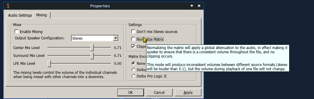

    For MPC-HC / Lav Filters you can enable a "normalise matrix" which means the volume is reduced according to the number of source channels so after they're combined the output can't have clipping. A normalize matrix is usually a "worst case scenario" volume reduction. The volume is reduced enough to prevent clipping even if all the channels have peaks at maximum at the same time. If they don't the downmixed stereo might be a bit quieter than it needs to be.
    [Attachment 75522 - Click to enlarge]

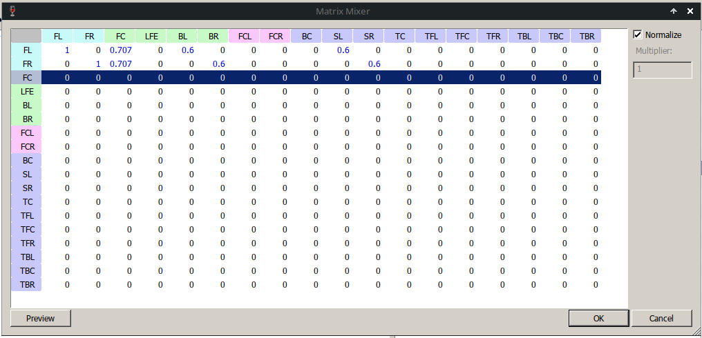

    Foobar2000 comes with a "downmix to stereo" DSP. It has no options though and I don't know the formula it uses, but it can be added to both the playback and conversion chains.
    The version of foobar2000 I've linked to below also comes with the Matrix Mixer component. You can add it to the playback chain while you fiddle around, save it as a DSP preset and then add that preset to the conversion chain. You can adjust the downmix however you like, and with the "normalize" box checked, it'll automatically reduce the over-all volume to prevent clipping. A 7.1ch to stereo downmix might look like this:
    [Attachment 75524 - Click to enlarge]
