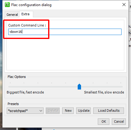

Hi, I always use useac3to in order to encode a DTS MA 2.0 to a FLAC -down16.
But now I have deleted a frame in the BD and I want to cut and encode a DST MA with a script and MeGUI and the FLAC "plugin" 1.4.3.
what is the correct CUSTOM command line to add in order to get a 16bits FLAC instead of a 24?
this one gives me an error:
[Attachment 72925 - Click to enlarge]

ok, adding
A=A.ConvertAudioTo16bit()
in the script, apparently works.
but using MeGUI instead of useac3to it is much more faster, does it maintain the same quality?Last edited by maudit; 6th Aug 2023 at 02:31.

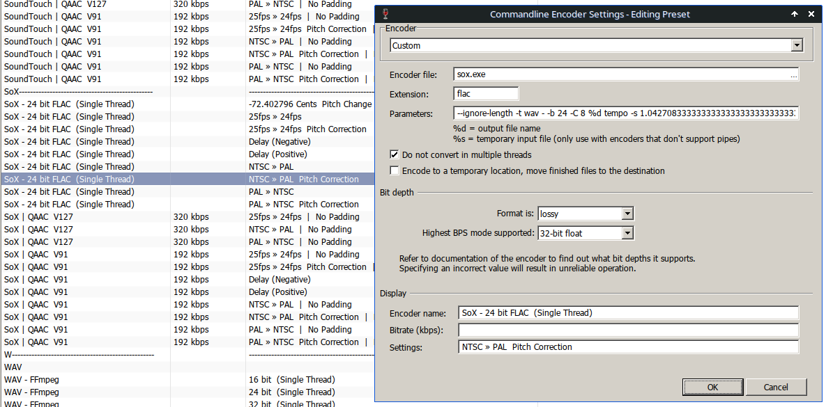

By the way, a while ago I uploaded a version of foobar2000 with lots of conversion presets and encoder configurations ready to use, and it's easy to copy/edit them to change the command line to suit your needs.
https://forum.videohelp.com/threads/396860-foobar2000-portable-%28for-audio-encoding%29
There's presets for standard speedups and slowdowns using ffmpeg, SoundTouch and SoX. The closest to what you're after would be a SoX preset. It's configured to output 24 bit flac so you'd only need to change -b 24 in the command line to -b 16. Foobar2000 is far more versatile than MeGUI and can encode multiple files simultaneously, either to the same output format or even to different formats. It also includes a plugin that allows it to open and play/encode Avisynth scripts. That plugin only comes in a 32 bit flavour, and the version of foobar2000 I uploaded is also 32 bit, but that doesn't matter because it can still use 64 bit encoders via the command line. It means if you want to open scripts though, you'll need to have the 32 bit flavour of Avisynth installed, but by default the Avisynth+ installer installs both 32 and 64 bit versions anyway. Oh... and it's a good idea to add KillVideo() to the end of a script before opening it with foobar2000, because sometimes if the script also includes video foobar2000 will crash.

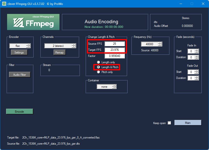

Use clever FFmpeg-GUI instead.
Load your dts (or video with dts), click main, click encode audiostream, select your audiostream (if serveral), click >>>.
Set flac as encoder, click settings (below), set 16 bit, source fps field is already filled (change it to 25 if it's 50), set target fps to 23.976, set length & pitch, click encode. Done.
