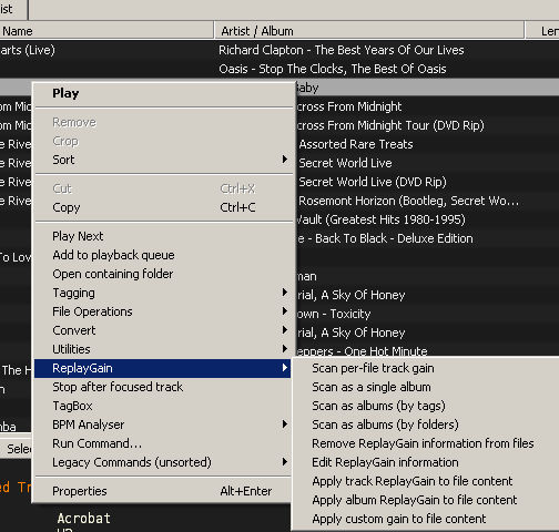

  19. The ReplayGain scanner is built in. I'm still using an older foobar2000 (running on XP) but it looks like this:
    [Attachment 66335 - Click to enlarge]
    Once you've scanned your files and saved the ReplayGain info to tags, you can adjust MP3 and AAC audio losslessly (Apply track ReplayGain to file content), and for any other audio you can adjust the volume using the ReplayGain info while converting. You can configure that under the Processing section in the converter setup.

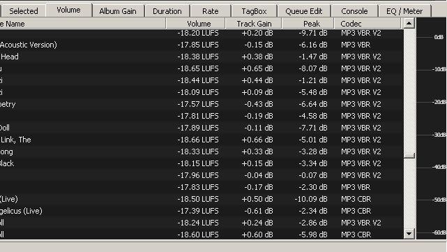

    You can't see the Volume tab's contents in the screenshot in that post, and I think I've changed what it displays a little since then, but once you've scanned your files and saved the info, the Volume tab looks something like this:
    [Attachment 66336 - Click to enlarge]
    -18 dB or -18 LUFS is the ReplayGain target volume, hence most of the files in the screenshot being close to that. TrackGain is the volume relative to the ReplayGain target volume, which is fixed in stone. You don't have to adjust to the ReplayGain target volume, but TrackGain is always relative to it.

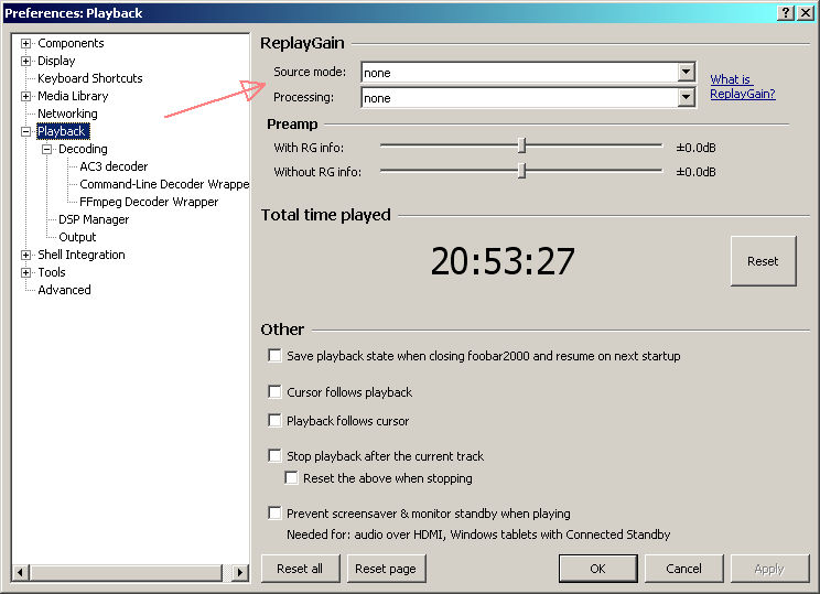

    PS After you've scanned files and saved the info, by default foobar2000 will use it to adjust the volume on playback so the scanned files always play at the same volume, which is what ReplayGain was originally designed for, so to hear the volume difference between scanned files the ReplayGain volume adjustment on playback needs to be disabled in preferences.
    [Attachment 66337 - Click to enlarge]
