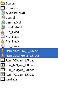

    1) Download the AC3GAIN.ZIP file. Unzip to its own folder
    ac3gainv4.zip
    2) Drag Your AC3 files into the same folder as the AC3GAIN files
    3) Double click on Run_AC3gain.bat to start
    * Depending on the amount of dynamic range compression you desire, you can choose any of the .BAT files, from 1.5 to 2.5. The higher the number, the louder and more compressed sounding the output file will be.
    * The transcoding process might seem to lag in the beginning. It'll be stuck on 0% for the first few minutes, depending on the size of the AC3 - That's mostly due to Avisynth analyzing the file for volume peaks before applying DRC. It is still amazingly fast when Aften begins to transcode.
    4) Completed file will be (384kbps, 48000Hz)

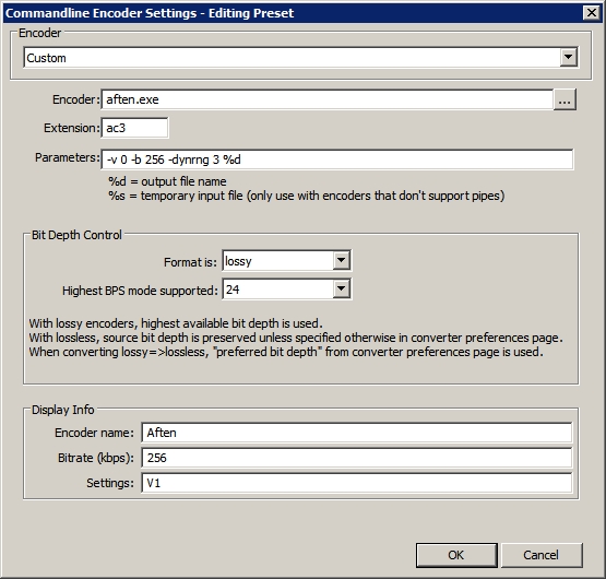

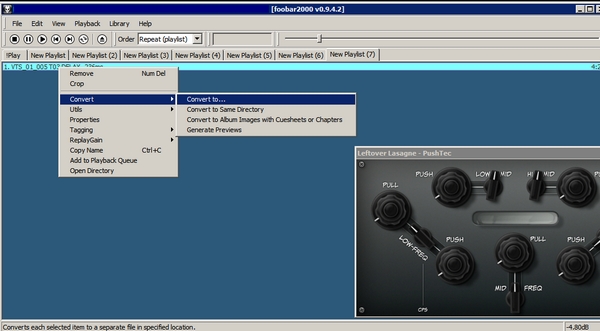

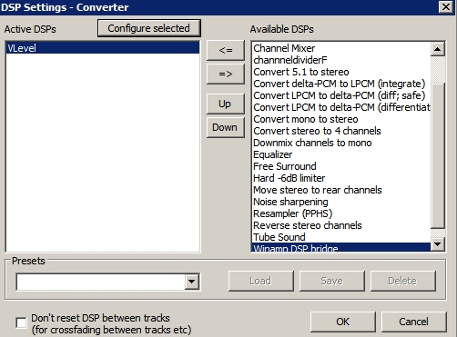

    You other choice - Install Foobar 2000 with the AC3 Input Plugin then transcode to AC3 (aften)
    components.rar
    Mar 2007
    Germany
    Hi Soopafresh,
    Thanks for the suggestion. I never really liked Foobar2000, when I tested it a few years ago. It had very comlicated and messy option screens.
    But it seems that it has improved a lot and it is a really nice and handy audio tool to me!Now I like it
    I have tested your suggestion, but the weird thing is that now the foobar encoding process stops after encoding 132,7Mb (with your AC3Gain it stopped at 68,2MB) and throughs an error message telling that the encoder through an error 0. Its 100% reproducable.
    Maybe I should mention, that the full ac3 file has a size of 466,5 Mb and it is in the 448KBit format. Of course I have changed the options to that bitrate.
    It seems to me after.exe is having troubles encoding. Do you know any other page, which offers a 0.6 binary? Maybe the binary I use causes the troubles? Or do you have another idea for the roots of my problem?
    Sorry for bothering you - and thanks very much for all your help so far!
