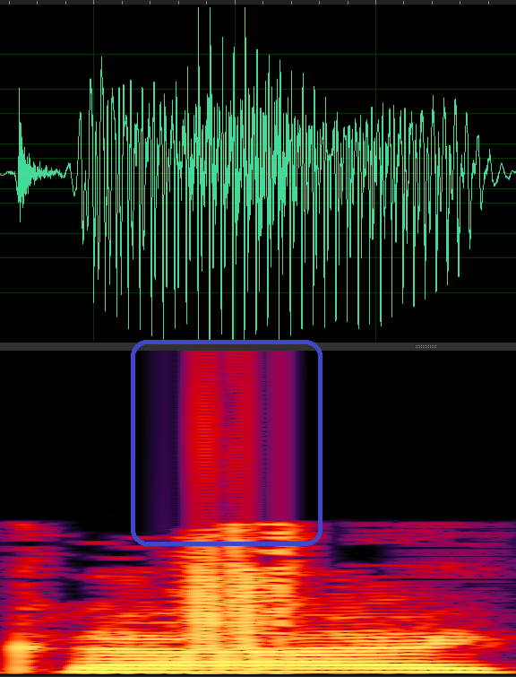

  1. When I use hard limiter in Audition with settings -0.1dB, 5ms, 40ms I get small amount of artifacts:
    [Attachment 56468 - Click to enlarge]

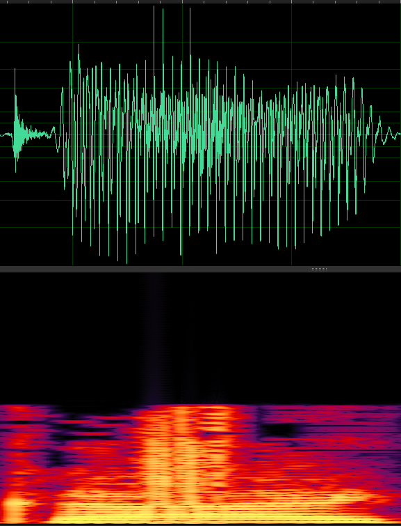

    When I did the same thing in ffmpeg I get a lot more artifacts:
    ffmpeg -i inp.wav -af "compand=attacks=0:decays=0:points=-80/-80|-0.1/-0.1|20/-0.1" -c:a pcm_f64le out.wav
    [Attachment 56469 - Click to enlarge]
    Can I fix it somehow?

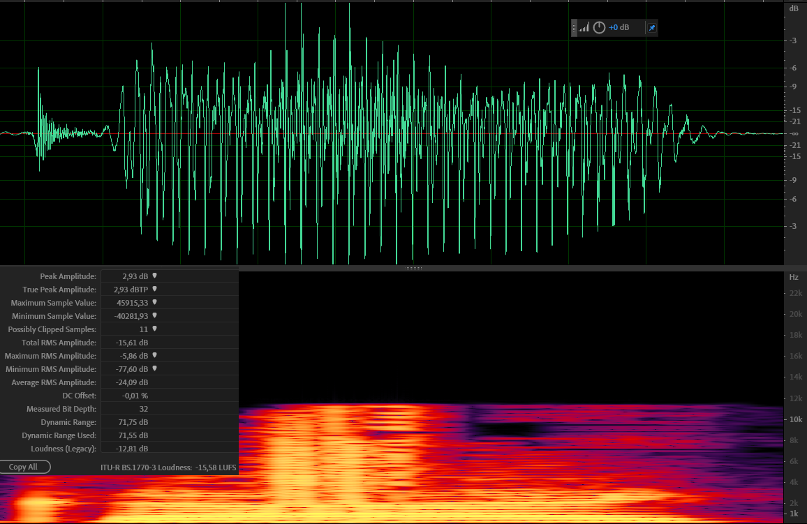

  6. I suppose it's dBFS. Amplitude statistics:
    [Attachment 56471 - Click to enlarge]
  7. Well it does say 11 possible clipped peaks. Though a view of a channel showing the meter reading would be more helpful.
    Try reducing the channel level and set the limiter to -3db. You should not have the audio banging the meters at the top of the scale as it will not achieve anything.

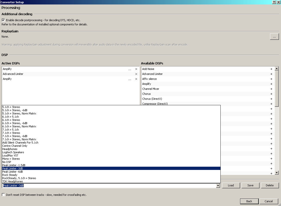

    If you can handle a GUI, you could try the portable version of foobar2000 I uploaded a while back. It includes compression and limiter presets.
    https://forum.videohelp.com/threads/396860-foobar2000-portable-%28for-audio-encoding%29
    Load the track into the playlist, right click on it, select Convert, then click on the three dots at the bottom of the conversion presets list.
    That opens the converter configuration, where you can select an encoder and add DSPs to the conversion chain. I think LoudMax is one of them for the version I uploaded, but there should be a few peak limiting presets using foobar2000's Advanced Limiter. If they're the same as the presets I use currently, there should be Peak Limiter -1.5dB, -3dB and -6dB presets. Load one and convert the file.
    Each one boosts the volume (either by 1.5dB, 3dB or 6dB), then sends the audio to the Advanced Limiter, the volume is reduced by the same amount again, and it's off to the encoder. The reason for having those presets is the Advanced Limiter doesn't kick in until right on 0dB, so increasing the volume before limiting then reducing it again effectively means it's kicking in below 0dB. The DSP processing is 32 bit float, so it won't cause clipping if the peaks exceed 0dB during processing.
    [Attachment 56527 - Click to enlarge]
