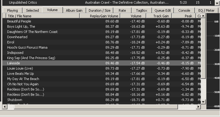

While I'm here.... here's some fb2k syntax for displaying volume in custom playlist columns if you're interested. I added a playlist view element dedicated to volume so as not to clutter playlists, and to make it easier to cut the MP3Gain cord. This syntax highlights the currently playing track, but it's not hard to change if need be.
ReplayGain Volume
Displays the volume in ReplayGain-speak based on any TrackGain info (not AlbumGain), but because 89dB is a sound pressure level and almost meaningless to mere mortals, I don't use it myself, although I added it as a column for the screenshot below.
VolumeCode:$if(%replaygain_track_gain%,$puts(X,$sub(8900,$replace(%replaygain_track_gain%,.,)))$puts(VOLUME,$ifgreater($get(X),9999,$substr($get(X),1,3).$substr($get(X),4,5),$substr($get(X),1,2).$substr($get(X),3,4)) dB))$if(%isplaying%,>>>$get(VOLUME)<<<,$get(VOLUME)))
Displays the volume in human-speak (once again based on any TrackGain info). ReplayGain's 89dB is equivalent to -18 LUFS on an output meter (interchangeable as -18dB), so a 95dB target volume would translate to -12dB.
(syntax edited to display the volume as dB to match the screenshot below, rather than as LUFS)
Track GainCode:$if(%replaygain_track_gain%,$puts(X,$sub(-1800,$replace(%replaygain_track_gain%,.,)))$puts(VOLUME,$ifequal($get(X),0,0,$ifgreater($get(X),0,$replace(+$substr($num($get(X),4),1,2),+0,+),$replace($substr($num($get(X),5),1,3),-0,-))).$substr($num($get(X),5),4,5) dB)$if(%isplaying%,>>>$get(VOLUME)<<<,$get(VOLUME)))
Displays the TrackGain info, always relative to ReplayGain's 89dB.
PeakCode:[$if(%isplaying%,>>>%replaygain_track_gain%<<<,%replaygain_track_gain%)]
Displays the track peak in dB.
Code:[$if(%isplaying%,>>>%replaygain_track_peak_db%<<<,%replaygain_track_peak_db%)]
[Attachment 56042 - Click to enlarge]Last edited by hello_hello; 3rd Dec 2020 at 02:59.

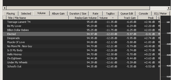

The columns I created are individual custom columns (right click on a playlist column header, select Columns/More) and not part of a grouping. Once they're created you can add them as Playlist columns. If you disable grouping you can then click on one of those columns to sort the files according to volume, or track gain etc, so sorting by volume you can easily find tracks outside a particular volume range, although I'm not sure why you wouldn't just tell fb2k to adjust them all. Files already at the target volume won't be adjusted, although keep in mind the adjustment can only be made in increments of 1.5dB (some MP3 limitation I don't understand), so you'll rarely achieve the exact target volume. When you're done adjusting you can go back to using your usual playlist grouping. If the extra columns bother you, they can be disabled until you need them again.
One thing my fb2k columns don't tell you is the maximum possible adjustment before the peaks exceed 0dB, although you can get a fair idea looking at the track peak. The 1.5dB increment limitation might cause the peak to exceed 0dB a little. If you want to prevent that you can tell fb2k to prevent clipping when it adjusts, at least for versions 1.5 or newer. It'll adjust the target volume down according to each file's peak value if need be, but obviously for those tracks the average volume will be lower. When the peaks do exceed 0dB they're not actually clipped due to the volume adjustment, but it's likely they will be on playback so it's worth avoiding. Having said that, a peak of 1 or 2 dB above zero is possibly not going to cause clipping bad enough to hear, especially if it only happens once for a track, but there's no way to tell.
You'll have to get used to the track gain being relative to 89dB, rather than being adjusted according to the target volume as MP3Gain displays it, but that's not too hard. For a file with a volume of exactly 89dB the track gain would be zero. If you adjust to exactly 95dB it's 6dB louder than the default, so the track gain would be -6dB.
For the screenshot below I adjusted to 95dB without the option to prevent clipping enabled, and then clicked my custom volume header to sort by volume. Not that there's much variation as they're all adjusted to the same target volume, to the extent it's possible due to the 1.5dB increment limitation. As you can see most of the peaks now exceed 0dB but that won't always be the case. It's up to you if you want to care when it happens.
[Attachment 56047 - Click to enlarge]Last edited by hello_hello; 12th Dec 2020 at 22:08.

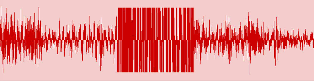

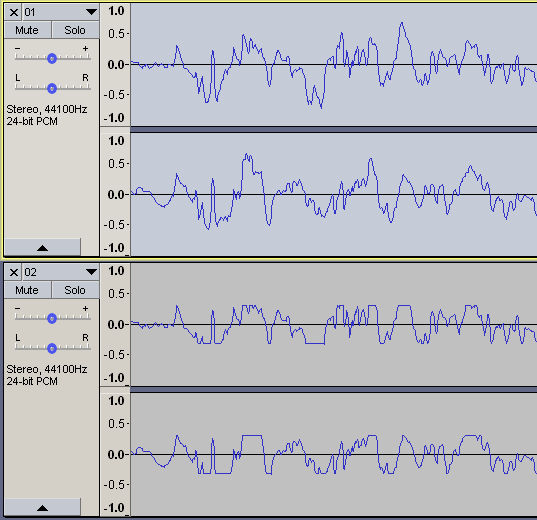

It's different for a wave file, where for 16 or 24 bit PCM audio, 0dB is the maximum. If you increase the volume, any part of the waveform that would need to exceed 0dB would instead be flattened to 0dB.
You probably know what it looks like, but here's a screenshot of an original waveform at the top, and the clipped waveform at the bottom, which was the result of increasing the volume by 10dB and then decreasing it by 10dB.
[Attachment 56067 - Click to enlarge]
Keep in mind though, the ReplayGain peak value is just the maximum. It doesn't tell you if 0dB is only exceeded once or if it's a regular occurrence. Often it'll only happen in one, or just a few places, but unless Abode Audition can look for clipping it's something you often need to zoom in on peaks a fair bit to see (Audacity has an Analyse/Find Clipping menu). For a lot of pop music, which is heavily compressed, it might result in clipping similar to the the next picture. I just grabbed it off the internet, but looking at the middle section of the waveform it appears clipped even though everything's below 0dB, so you'd need a closer look to be sure.
[Attachment 56069 - Click to enlarge]
However....
Audacity decodes/imports all audio as 32 bit floating point by default (I'm pretty sure), so that's possibly a common practice for audio editors, and 32 bit float can store values above 0dB. So even though a waveform might look like it's clipped, sound like it's clipped and Audacity's Find Clipping option agrees, peaks above 0dB won't be clipped... until you export the audio as 16 or 24 bit PCM or encode with an encoder that doesn't support a 32 bit float input. The same thing will happen when your MP3s are decoded for playback. They'll mostly be decoded as PCM, and it can't hurt to assume 0dB is the maximum for any hardware in the playback chain, but as I said originally, if +1 or +2dB peaks aren't causing distortion, or not enough to hear, you can of course choose to ignore them.

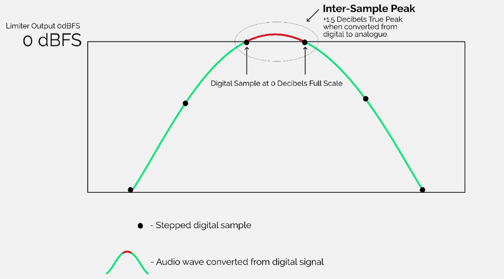

MP3Gain only looks at the sample values for the peak level. By default, foobar2000 is the same, but if you enable the True Peak scanning option, foobar2000 will reconstruct the analogue waveform as it scans, giving you the true peak, although it'll definitely slow the scanning speed by a fair amount too. The difference between sample peak and true peak is probably easier to explain with a picture.
[Attachment 56068 - Click to enlarge]
If you're not True Peak scanning, adjusting the volume so the peaks don't exceed -3dB is often recommended. I don't use True Peak scanning much, or fuss over peak levels unless they exceed 0dB, or even +0.5dB on a good day, but I rarely live more dangerously. That's just me though.
