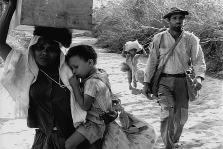

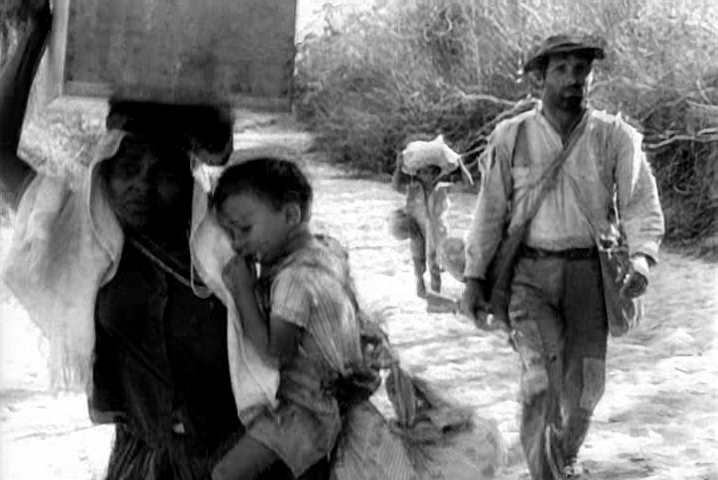

  7. Thanks for looking at it. I tried it in the whole film and it works generally OK but lets some blends through that the AnimeIVTC code above didn't. Comparison:
    Your code:
    [Attachment 55580 - Click to enlarge]
    AnimeIVTC(mode=2,bbob=4) (+other unimportant for this matter aesthetic filters)
    [Attachment 55581 - Click to enlarge]
    Using the variation with FixBlendX(8, 24.0/1.001, 10), the blend above gets fixed, but others pass through. I guess one could go down this road identifying where the pattern changes. But is there a way to do that other than manually? (I understand this discussion is academic since AnimeIVTC gets this thing right, but I'm still interested if you are, for the purposes of learning something for other future cases.)
