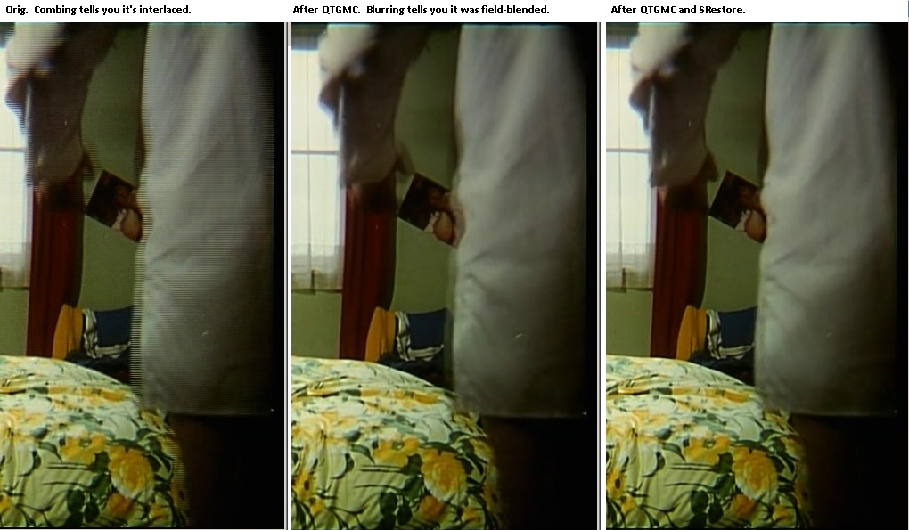

  1. Hi. I'm gradually teaching myself about restoration with the help of you good people. After going over what I've learned so far, I have a question about the one topic that I find most difficult – identifying what needs to be done to a DVD. Attached is a page from my own manual. With the clip opened in Vdub and 'bob doubler' activated, there are two identical frames for each image and the combing is plain to see.
    What I'd like to know is, can the fact that it was field-blended be confirmed (or ruled out) at this stage? Or is it necessary to check the effects of QTGMC before deciding? Thank you.
Name:	deinterlacing and unblending.jpg

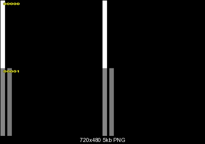

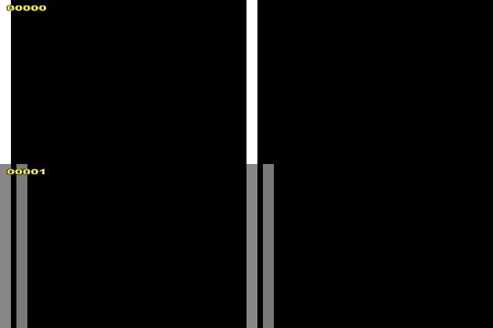

    You can see that the top field starts out clean at frame 0, and the bottom field is blended:

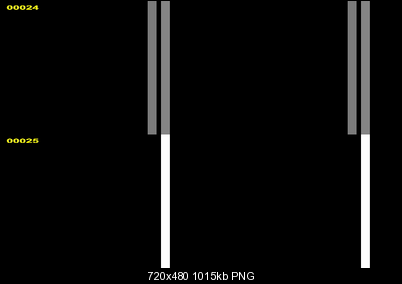

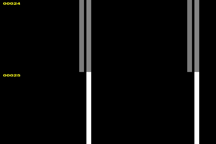

    By frame 12 the top field is blended and the bottom field is clean:

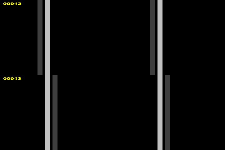

    But half way in between, around frame 6 (fields 12 and 13), both fields are blended:
    In those regions there are no clean frames to choose from so the usual techniques using SRestore() will leave a lot of those lesser blended frames.

  14. Originally Posted by Richard1485 View Post
    it's not just a single frame at the halfway point either: the fields before and after 12 and 13 look blended to a lesser degree.
    Yes, over a period of 25 frames the top field goes from clear to slightly blended, to most blended, to slightly blended, then back to clear. The bottom field does the same but 90 degrees out of phase -- when the top field is clear the bottom field is most blended, and vice versa.
