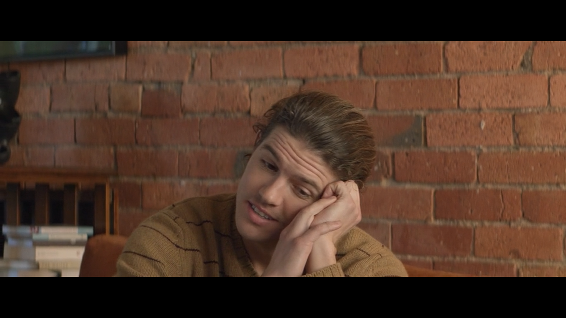

  18. Originally Posted by Hoser Rob View Post
    Agreed, utter nonsense. I'm pretty used to this sort of crap on the newbie oriented distro Linux forums I read.
    Have you encoded a video before?? You appear to be posting with a similar level of wrongness as sophisticles.
    I know almost nothing about how video encoding works, but take the use of motion vectors as an example. You have a picture that's spread over 4k's worth of pixels. The picture changes from frame to frame, but isn't it more likely the encoder will find a good match for a block at a higher resolution, because neighbouring blocks are more likely to be different at lower resolutions? Just a thought....
    Screenshots below.
    1: A 4k frame, encoded at CRF24 (x264), downscaled to 1080p on playback.
    2: The same frame, downscaled to 960x400 and encoded at CRF24 (default settings), then upscaled to 1080p on playback.
    3: The same frame, downscaled to 960x400 and encoded at CRF18 (default settings), then upscaled to 1080p on playback.
    Notice how the SD CRF24 encode looks pretty average next to the CRF24 UHD source at the same resolution (1080p)?
    Notice how the SD CRF18 encode compares far more favourably?
    Conclusion.... when upscaling SD to HD or UHD on playback, the encoding quality, or lack thereof, is more noticeable. Therefore, lower resolutions require lower CRF values, while for higher resolutions you can get away with higher CRF values.
Name:	UHD at 1080p and CRF24.png
Name:	SD at 1080p and CRF24.png
Name:	SD at 1080p and CRF18.png
