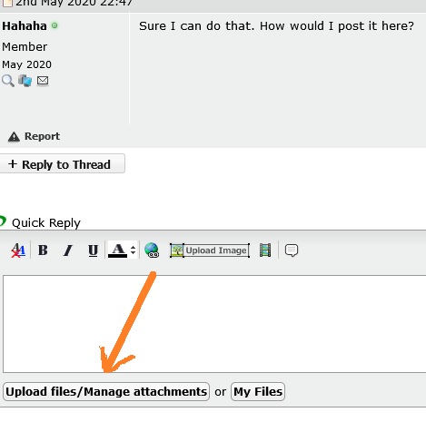

  3. Sure I can do that. How would I post it here?
    Mar 2008
    form here:

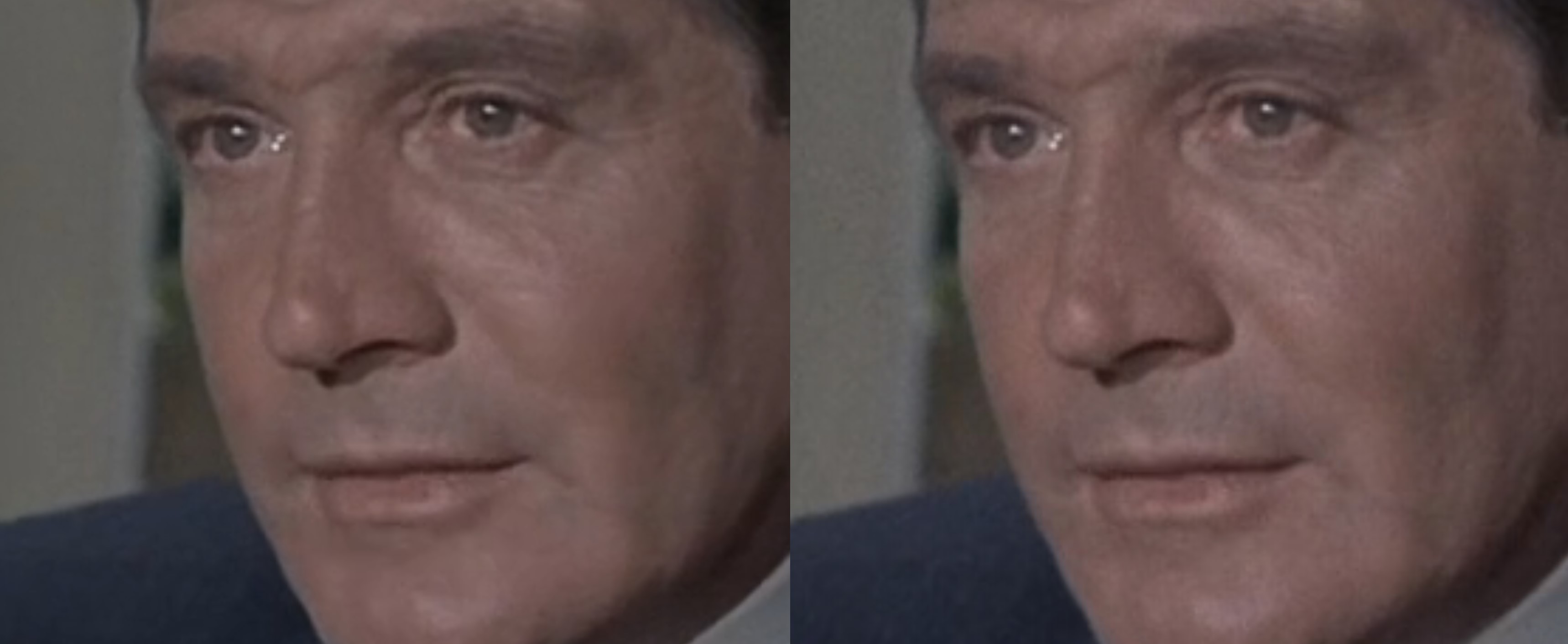

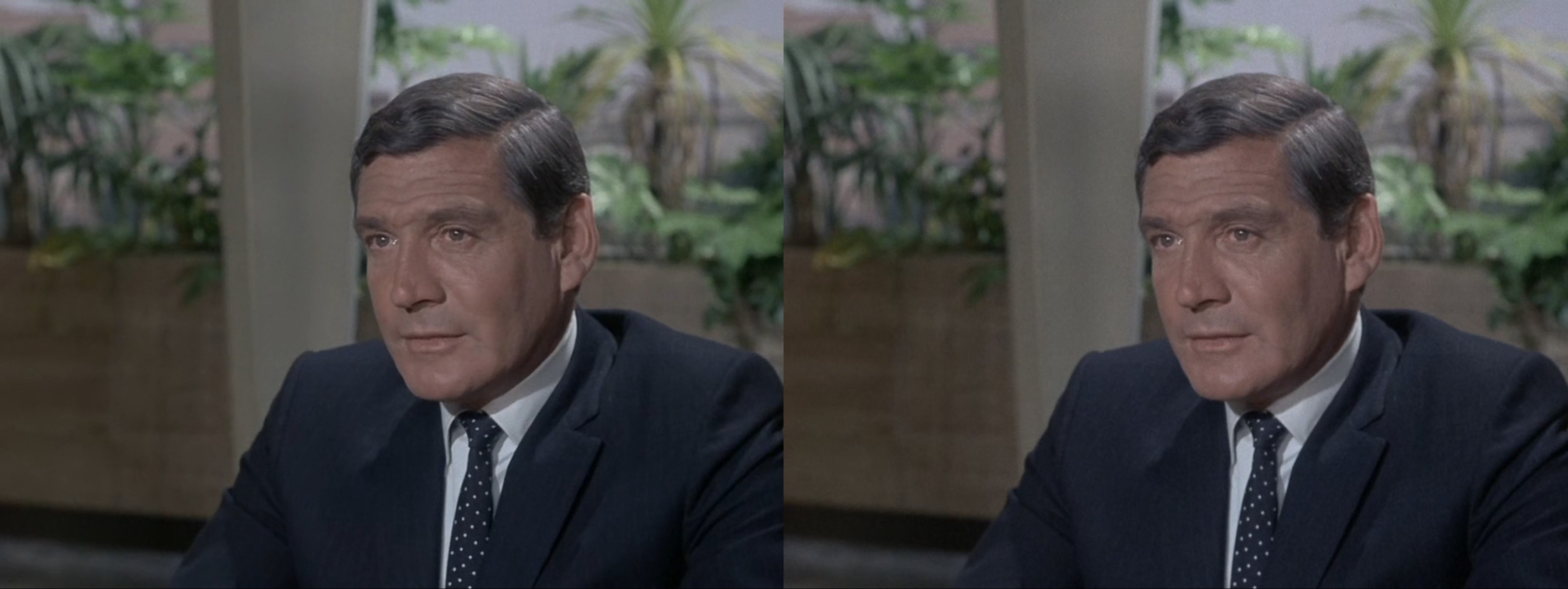

    And I guess I'll have to settle for this. It's pretty good. I think my expectations were too high for reality.
    On the left is your work. I had to zoom in this much to ask others of what they think.
    [Attachment 53143 - Click to enlarge]
    [Attachment 53144 - Click to enlarge]

    I denoised with an Avisynth deinterlacer.
    QTGMC(InputType=1, Preset="medium", EzDenoise=1.5)
    It has a progressive mode for repairing bad de-interlacing, and even though your source wasn't deinterlaced (I assume), there was a fair bit of "shimmering" around objects with sharpish outlines. I'm not sure if the original video looks the same, or if it was a result of encoding the noise with x265, but I didn't like it, and it's similar to the sort of thing QTGMC can repair. QTGMC naturally denoises a little anyway, but it has a denoising filter you can enable while specifying the amount of denoising. Technically, it's probably not the right tool for the job, but I denoise with QTGMC a lot because it blurs less for an equal amount of denoising compared to most denoising functions.
    Noise can be odd because your brain has a tendency to perceive it as detail, so sometimes a denoised picture can look less detailed even when there's only less noise, and I know what you mean regarding the plastic look, although it has a touch of "plastic" to it before it's denoised. That's possibly whatever they did to the "remastered" version.
    I followed QTGMC with LSFMod for some subtle sharpening. Did you notice my encode was a bit sharper? It's probably most noticeable for the books on the shelf. Lastly, I used a function from the DitherTools plugin to convert the 8 bit video to 16 bit, do it's smoothing thing to gradients, then dither back to 8 bit. It can reduce any existing color banding and help prevent the encoder creating it. Combined with QTGMC it also makes existing encoder blocking less noticeable.
    I still haven't discovered why the color/brightness changed a little, although I haven't tried. I converted your 10 bit video to 8 bit (because DitherTools only supports 8 bit sources) so maybe I did something silly.
