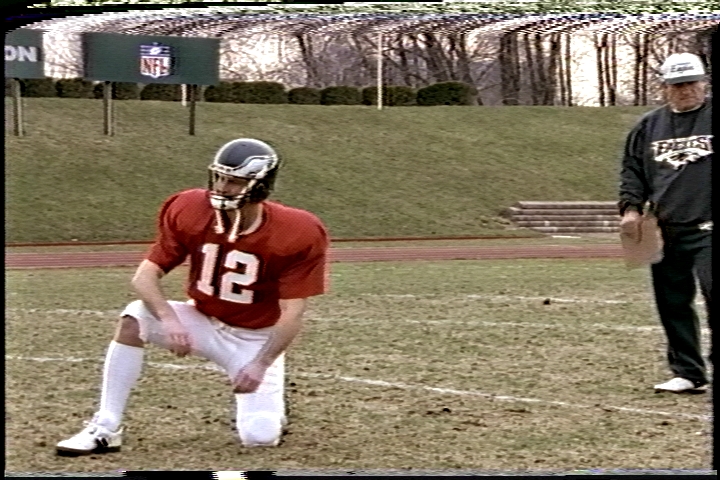

    I hope the Capture forum is the right place to post this. I'm new here and also new to the process of digitizing VHS tapes.
    I recently picked up a Panasonic AG-7650P for very cheap at auction, and I've been very happy with the results from it so far. It does a fantastic job on my home movies. I'm using a Diamond VC500 for capture.
    However I've noticed that on a particular tape, which is a commercial release, I'm getting some pretty bad jitter on the top ~55 lines of the frame intermittently throughout the video. This is not constant throughout the whole playback of the film; it only appears in certain scenes and it comes and goes. Here's a screenshot:
    [Attachment 50623 - Click to enlarge]
    I attached two video samples from the same scene. The first sample is with the TBC enabled on the Panasonic. Notice the lines skewed out of place at the top of the frame.
    The second sample is with the TBC disabled (set to Bypass). Obviously the video quality suffers tremendously and the frame is warped to the left as it's not being corrected. However, the skewed lines disappear and I don't see any damage to the video near the top.
    So my noob question here is: what does this indicate?
    Would this point to a problem with the TBC? I haven't noticed this issue yet on any other tapes, although I'm still testing.
    Would it indicate damage to the tape I'm trying to play back, which is confusing the TBC?
    Would it indicate something else, like a dirty playback head, etc? I am getting what I'd consider stellar quality video from this thing other than those lines when playing this tape.
    I've tried my hand at eliminating the jitter in Avisynth using DeJitter and some other filters, but haven't had much luck. It would be much better to eliminate this problem at the source, in hardware.
    Very much appreciate your suggestions!

    Probably Macrovision confusing the line TBC. Macrovision lives in the Vertical Blanking Interval above the active video area.
    This page says the TBC in your VCR blanks out the VBI: https://www.cameratim.com/electronics/panasonic-ag7650-ag7750-vtrs/modifications#tbc-v...tical-blanking
    So I guess it does this VBI regeneration after the line correction has already processed the raw signal containing MV.
    I assume this is also why the bypassed video sample is blown out, unless you changed proc amp settings between the two captures.

    Looks like this is in the recording/tape itself, because you see it change at different scenes/camera positions.
    so it's no fault in the capture.
    at least in the 1st mkv clip, the 2nd clip i don't know.
    You know for sure all hardware is allright ? no misallinement ?

    Thanks for this info, that's interesting. I did not change any proc amp settings between those captures, so that would seem to support your statement. Is there a reference I can look at somewhere to see if this film indeed had Macrovision? I'll have to try some other commercial releases.

    That was my suspicion, that this has something to do with the tape and not the deck. I have not opened this unit; it seems to be in great condition and I've done some home tape captures from it that look fantastic. That's all I have in support of it being in good mechanical shape.
    The distorted lines are not that bad, and the film would be watchable, except that I think they are heavily confusing QTGMC in my script, so in scenes where the lines show up, the deinterlacing produces really choppy, bad video. That's more of a problem than the visual distortion itself.

    Both of your uncropped samples have the "white block" in the head-switching area that's a clue your tape is MV-protected.

    Yup, you were right. And yes, your new thread makes sense as well. I can see it on the 7650 just by fast forwarding and looking at the top of the frame - the telltale white blocks fading in and out are right there (see attachment).
    So - is there anything I can do about this? Since the TBC is not fully bypassing it, is there any value in looking at an external Macrovision defeat device?
    I determined that this was not in fact messing with the deinterlacer at all, avisynth was just defaulting to the wrong field order. So the capture is almost perfect now.

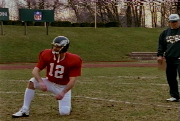

  15. I've since added a JVC HR-S9500U to my collection. Here's the same problematic scene captured on the JVC with the TBC turned on:
    [Attachment 51301 - Click to enlarge]
    See attached clip, as well.
    Turning the TBC off gives basically the same result as the Panasonic.
    So - what gives here - is this an issue with this particular tape? Are these decks not capable of dealing with the variant of Macrovision on this release? My capture card shouldn't care about Macrovision at all. Is something else wrong with my setup? Not sure how to proceed.

    You need this chain:
    S-VHS VCR (for stable transport), probably still better/higher with-TBC mode
    > ES10/15 for anti-tearing, line TBC(ish)
    > external framesync TBC
    > known-good quality capture card
    Also via s-video, not composite.
    But you also need to realize that not all copies of commercial titles act the same. You may just have a bad copy of the tape. It happens. The most common issue if the MV signal is corrupt in some weird way, and nothing can correct it. It's not unusual for the tape to even play badly direct from a plain VCR to the CRT TV, as it was designed to do. Again, it happens.
    Inversely, sometimes all copies of a title are fubar. That also happens.
    DataVideo TBC-1000 is fine, good TBC, but there are also some others (example: green AVT-8710).
