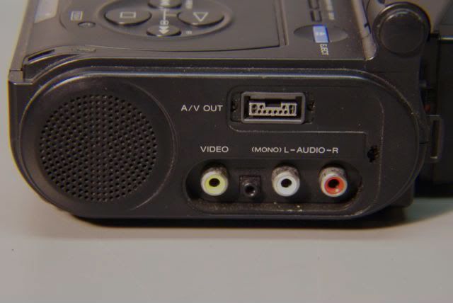

So a few years back I got a 1992 portable "Video Walkman" GV-S50 for $80, with a heavily cracked LCD screen. Which is fine by me as I just need it for outputting the signal. It has RCA Composite output and also what I assume to be a higher quality 12-pin A/V output connector which Sony apparently dropped and never really supported the connector. Looks like this. In the manual, this A/V terminal is only mentioned once with brackets saying "for future use". So this is a RCA Composite only unit, with stereo Hi-Fi support, no TBC, and according to the manual supports both Video8 and Hi8 playback. However on page 6 of the manual it says Hi8 playback is possible but it can't record in Hi8 nor will it play back in as high of quality as a real Hi8 player.

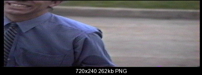

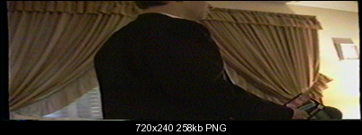

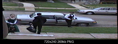

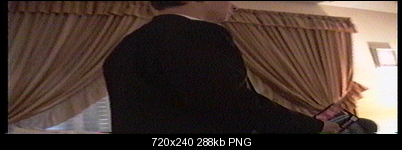

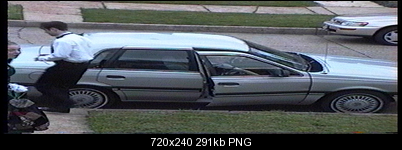

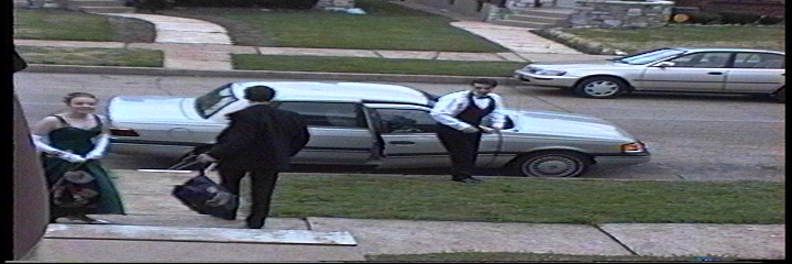

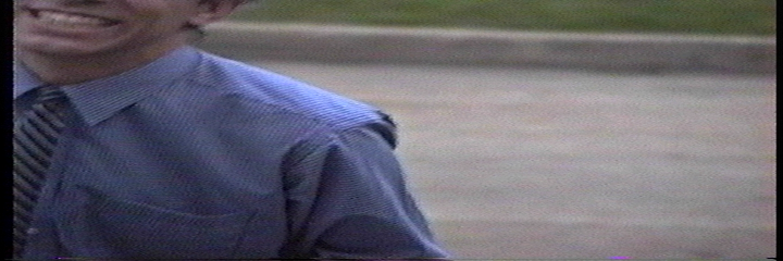

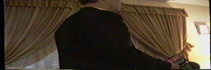

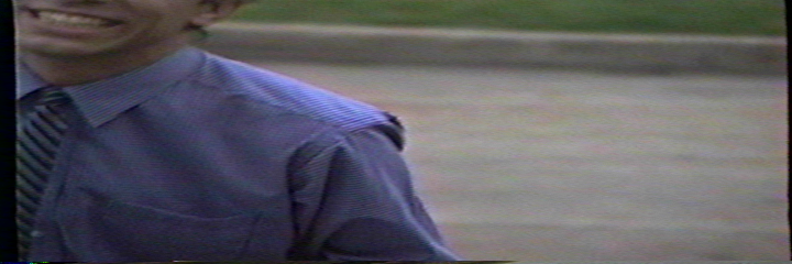

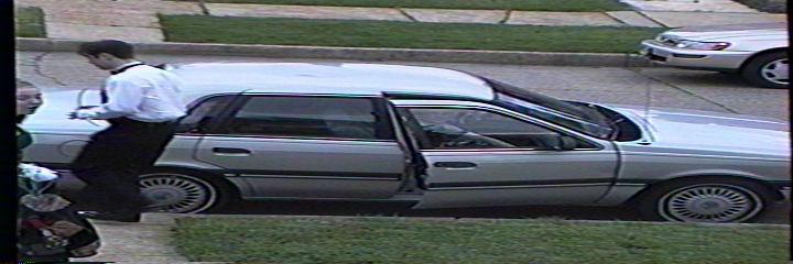

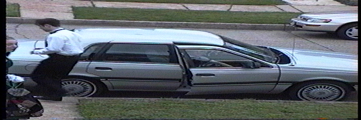

So naturally once I got things working, I wanted to do some comparisons between the two devices using the same Video8 tape. So I used the Video8 tape of my old neighbor going to prom 20 years ago, for comparison. Both were captured by my Hauppauge 1250 card using the same proamp settings. It has a S-Video port and used a simple S-Video to Composite connector for the GV-S50 transfer. Used Virtualdub to capture it with Lagarith YUY2, same color space as the card. The original capture is interlaced 720x480 but used Avisynth/SeparateRows(2) to show the individual fields. No other avisynth filters were used.
GV-S50 left - DCR-TRV460 right

The GV-S50 has no TBC or DNR, and is Composite only. The DCR-TRV460 had the TBC turned on and the DNR turned off, and was captured over S-Video. I did not try the DCR-TRV460 without the TBC, as it was usually volatile without it.
I don't know how much of the quality difference is because of the difference between composite and s-video. Anyway I'm pretty happy with this DCR-TRV460.
