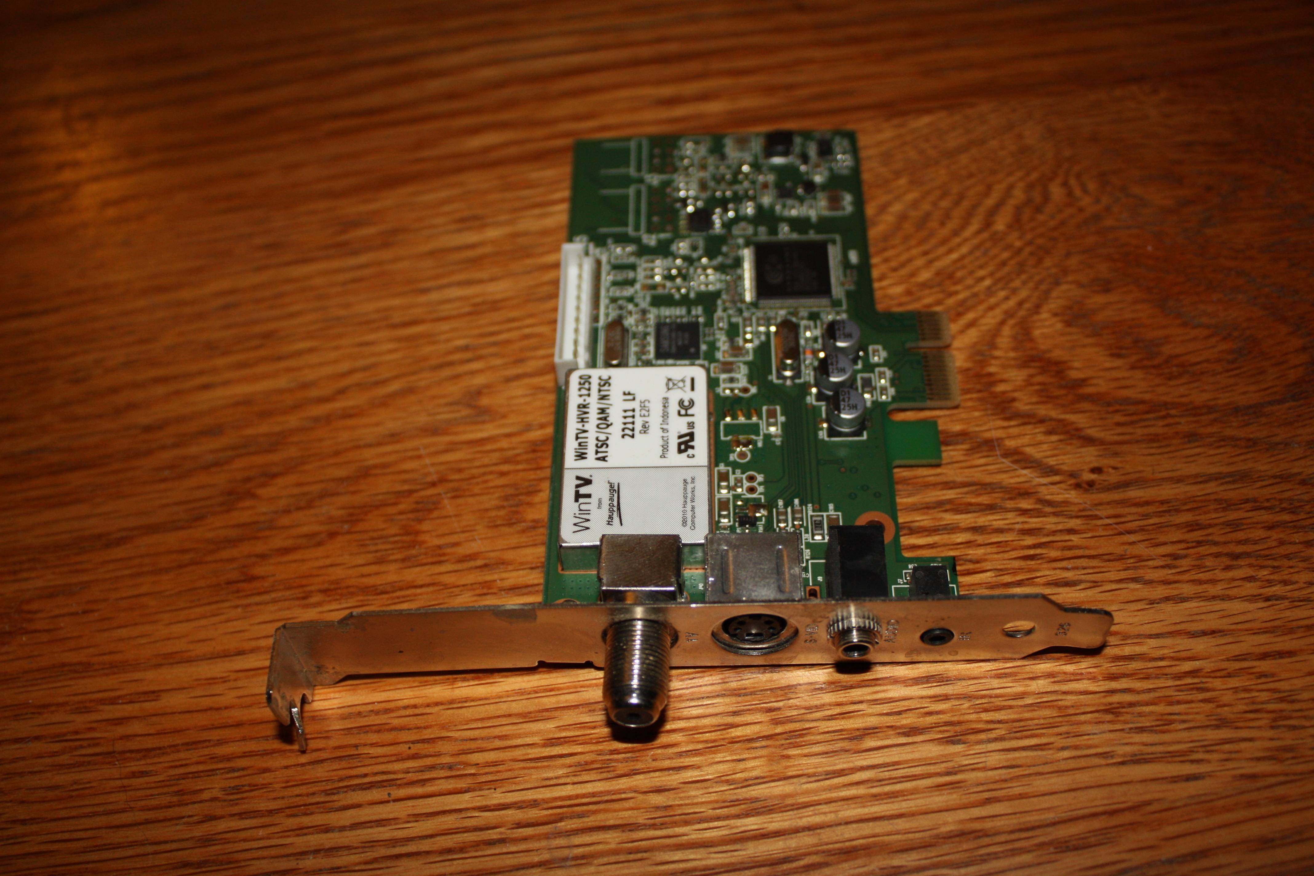

    I use the Hauppauge 1250. PCI-E with S-Video input. 8-bit 4:2:2 capture, fairly normal specs and there are plenty of other good cards. But this model actually ignores Macrovision, it just doesn't care about it.
    There are a few different 1250s, so here is an old picture of that exact model I'm talking about. I make no promises on the others besides the pictured.
    https://forum.videohelp.com/images/imgfiles/WC48DIg.jpg
    This looks good. I don't need to worry about Macrovision because most of these tapes are recorded by the little studio I work at, but that's still good if I ever need to. Does it capture colors accurately and does it drop frames?
