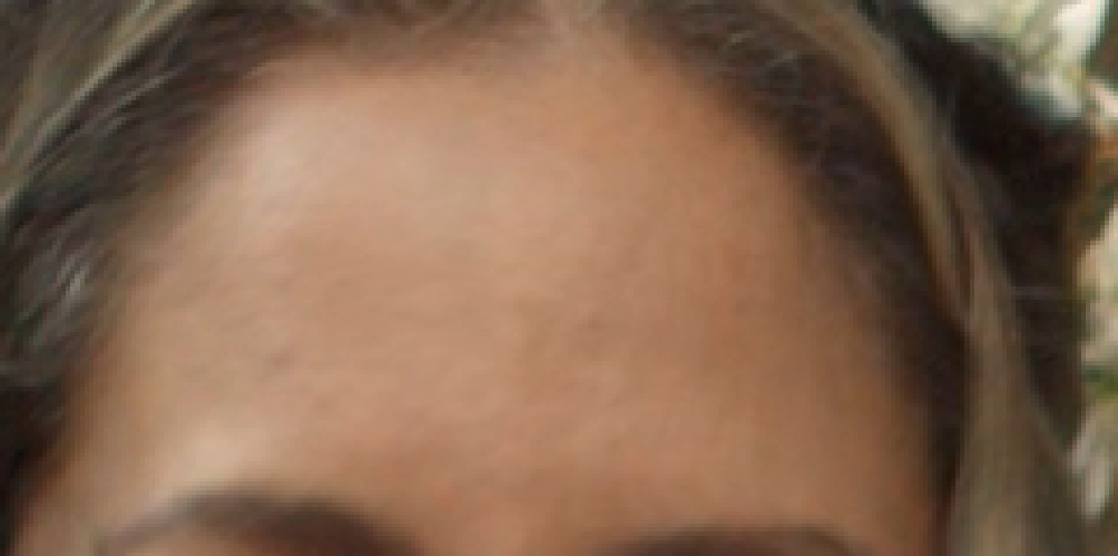

    frames 539 (counting from zero) , brides forehead, png's are in RGB of course cropped: core.std.CropAbs(clip, width=240, height=134, left=502, top=236), then zoomed in the picture using nearest resize, so points get just bigger:
Name:	06_x264_clip_06_[240, 134, 502, 236]_frame_0000539.png
Name:	05_x265_clip_05_[240, 134, 502, 236]_frame_0000539.png
Name:	04_x264 10-bit_clip_04_[240, 134, 502, 236]_frame_0000539.png
Name:	03_x265 12-bit_clip_03_[240, 134, 502, 236]_frame_0000539.png
Name:	02_x265 10-bit_clip_02_[240, 134, 502, 236]_frame_0000539.png
Name:	01_nvenc hevc_clip_01_[240, 134, 502, 236]_frame_0000539.png

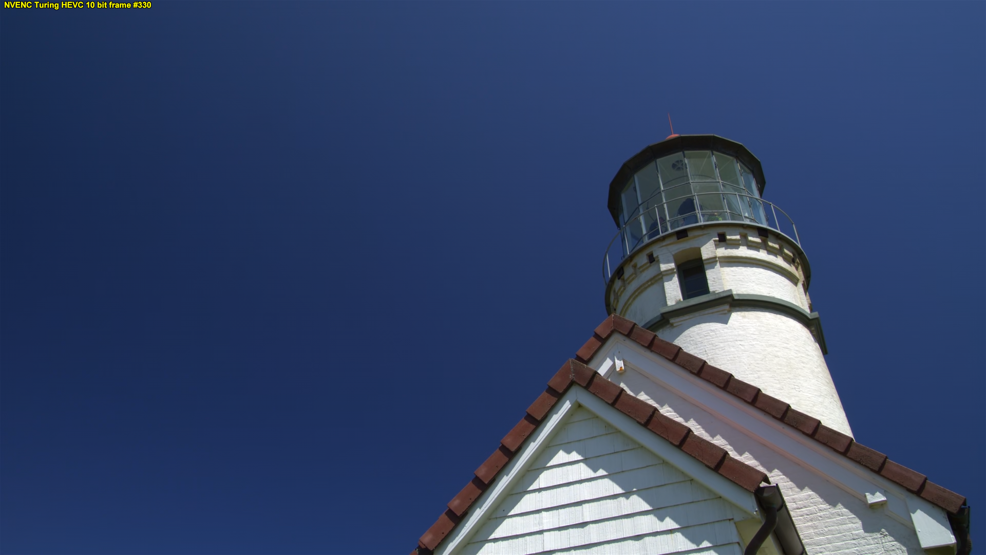

  9. "Lighthouse" using GTX 1660 Ti (Turing) HEVC vs x264. 8 bit and 10 bit for each. ~3000 kbps.
    nvencc64 -c hevc --vbrhq 0 --vbr-quality 25.5 --max-bitrate 100000 -u quality --output-depth 10 --lookahead 32 -b 5 --ref 7 --nonrefp --aq --aq-temporal --bref-mode middle --mv-precision q-pel --fps 24 --sar 1:1 --log lighthouse_turing_hevc_10bit.txt --avhw -i "lighthouse_lossless.mp4" -o lighthouse_turing_hevc_10bit.265
    nvencc64 -c hevc --vbrhq 0 --vbr-quality 26 --max-bitrate 100000 -u quality --output-depth 8 --lookahead 32 -b 5 --ref 7 --nonrefp --aq --aq-temporal --bref-mode middle --mv-precision q-pel --fps 24 --sar 1:1 --log lighthouse_turing_hevc_8bit.txt --avhw -i "lighthouse_lossless.mp4" -o lighthouse_turing_hevc_8bit.265
    avs2pipemod -y4mp lighthouse.avs | x264.exe - --demuxer y4m --bitrate 3000 --preset veryslow --tune film --output-depth 8/10 -o lighthouse_x264_8/10bit.264 --pass 1/2

  30. Originally Posted by lordsmurf View Post
    So .... the main benefit of 10-bit is to better see forehead pimples?
    RE: post#2 above.
    No, it is a detail how a uniform gradient is handled with a detail in one crop together with hair detail. It is familiar to us and how it suppose to look. We all know exactly what we suppose to see. So we have encoded samples to compare. op did not provided an original. Everyone starts to complain lately about something. It is a trend.
